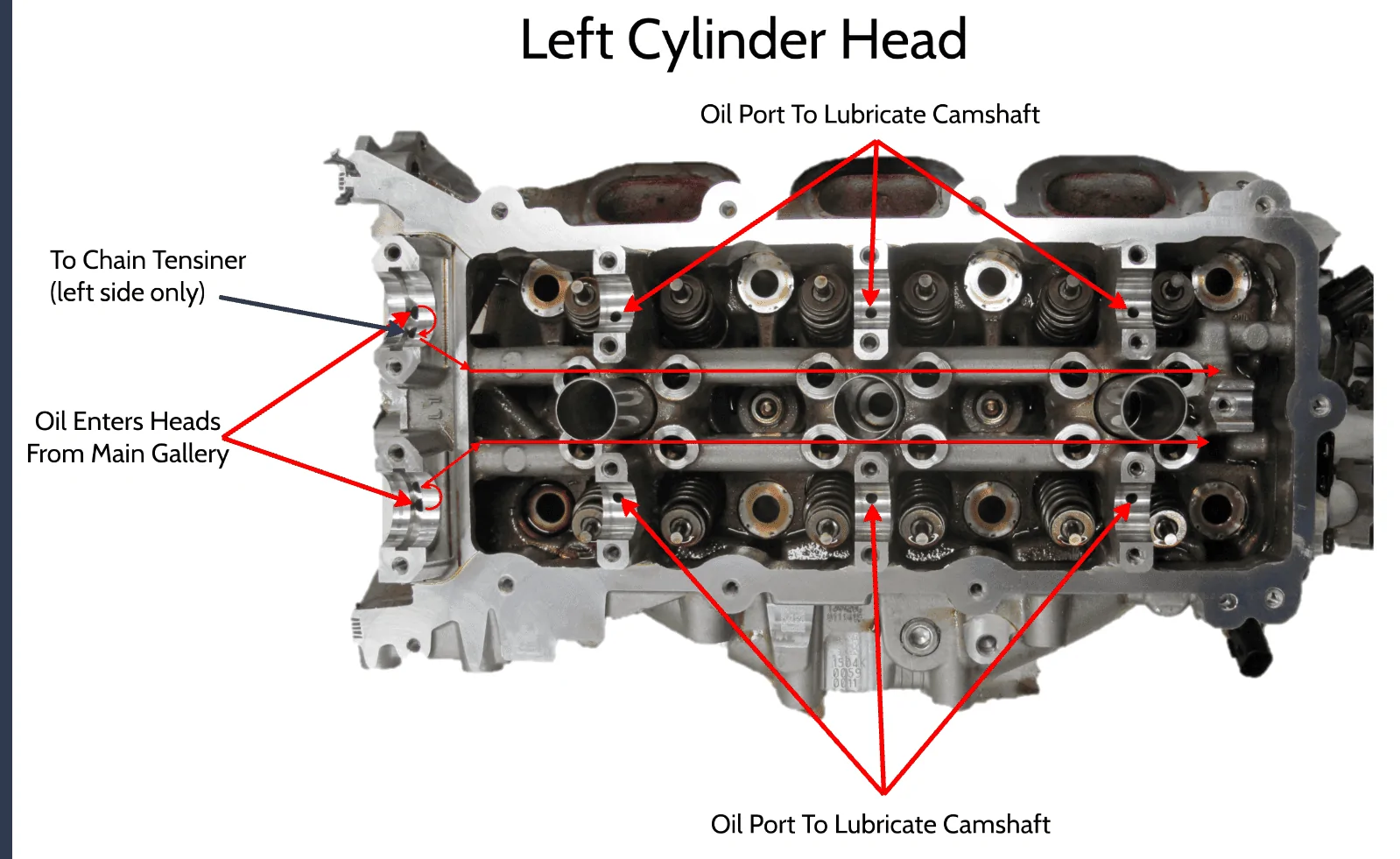

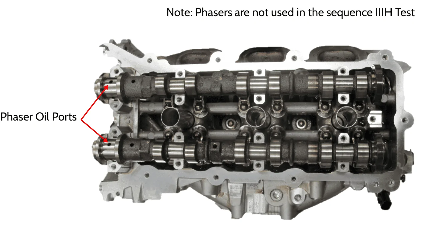

Right what could bleed off nearly all head pressure? I'd like to see the other bank. Hard to imagine only one head lost oil supply. Hard to imagine only heads lost pressure. Whats the bottom end looks like?

That head is for a "Classic" Pentastar, without Variable Valve Lift. There is a third oil passage in the VVL Pentastar heads. It is possible to have VVL issues without any problems in the Variable Valve Timing system. Oil gallery plugs can be loose or missing on any of the three passages in the head. I always check for the plugs and make sure they are tight.

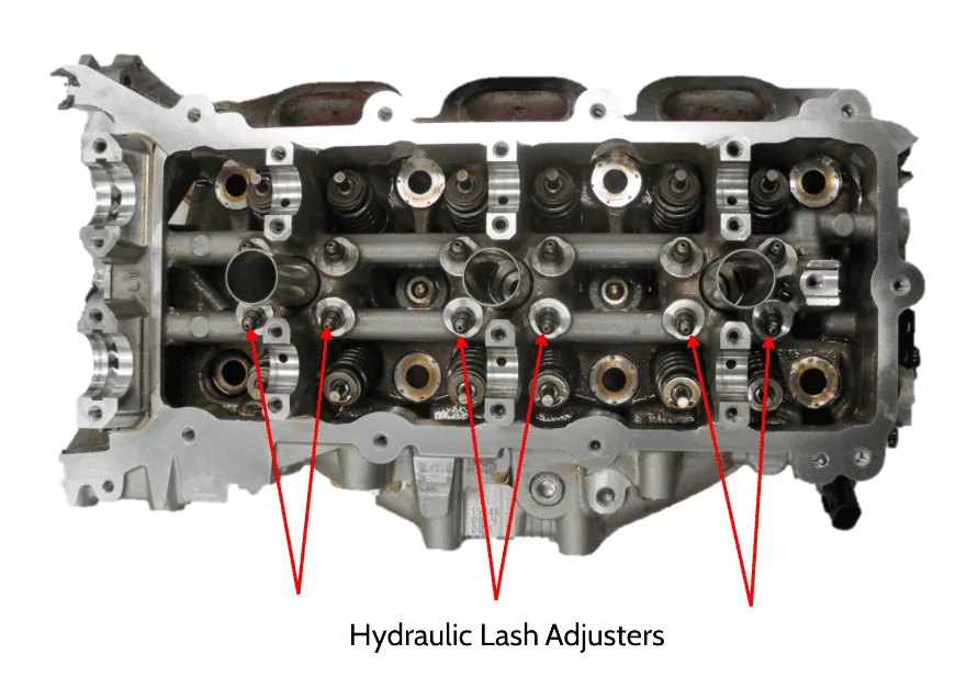

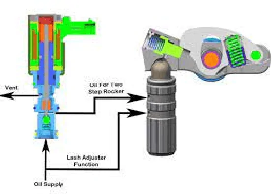

Yes, correct, you can tell even just by the followers being all roller for all valves, not just exhaust.
The solenoids that control oil flow to the lash adjusters to either shove the follower lock pin back to unlock the high lift portion and put it in low lift mode. That's another channel that leads to that portion of the intake-only lash adjusters.
The oil for that comes from the main oil supply so any problem with oiling in general will impact the 2-stage follower, keeping it in high lift mode. It's oil pressure that puts the follower into low lift mode unlocking the center section. Loss of pressure allows the lock pin to be pushed out by the spring and lock the follower into high lift mode.
There are 4 VVL solenoids, one each end of the head with the front ones being mounted in the valve covers and controlling only the front cylinder on that bank.
If there was pressure loss to impact oiling to the cam journals, I'd expect the valves to be in constant low lift mode because it takes pressure to keep the followers in high lift mode.
Possible if there were an oil gallery restriction on that side (not so likely with modern production methods) or if a gallery plug was loose. Like in years past, the oil galleries are drilled and then plugged on the end. Not sure what types of plugs are used today, but it used to be pipe plugs and it was EXTREMELY rare if you saw one missing or loose. It just didn't happen back then.
Very possible for the top end to lack adequate oil but the bottom end be ok - not ideal, but ok, not impacted.
Frankly if something like this happened to mine - I'd be pulling the pan and cleaning stuff out. Maybe even more than once.

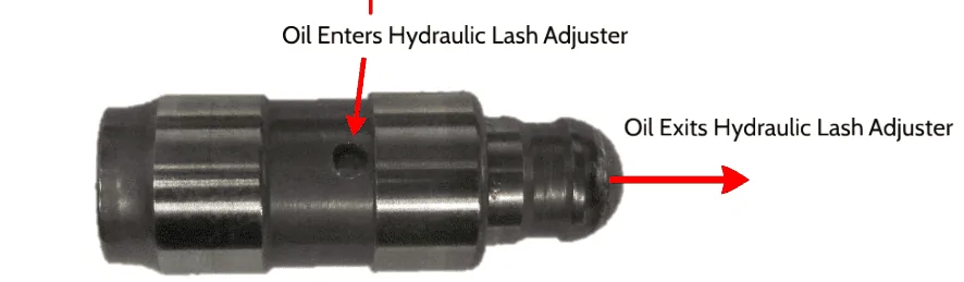

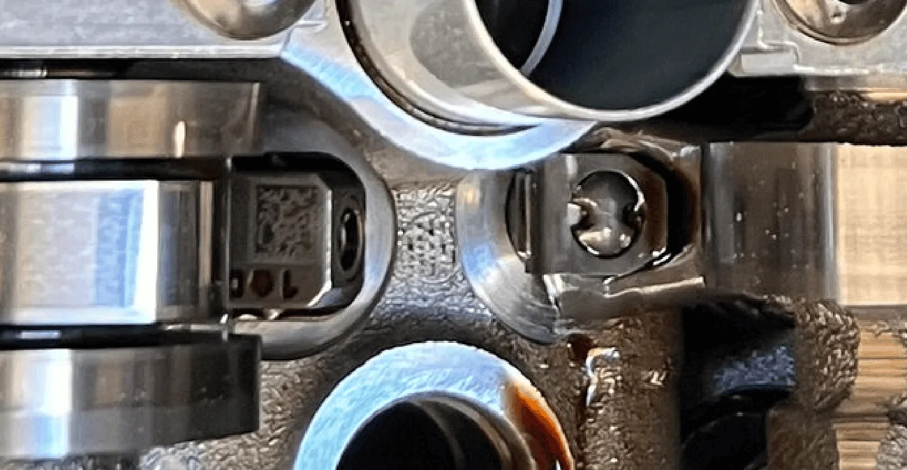

My bet is "plenty". As long as the parts are kept wet, that's all that is needed. Even if only spray to the point of some run-off, that's plenty. They only need to keep a film of wet oil between the parts, and enough to get into the bearing area of the low lift rollers, and the valve stem area for added cooling.
The lash adjusters for the current rev of the 3.6 intakes of course has a second entry point for control of the 2-stage follower, but there has to be a lot of volume up there.
This would be more like the exhaust lash adjuster -
Jeep Gladiator 3.6 Engine Tick 1680976861816
Jeep Gladiator 3.6 Engine Tick Screenshot 2023-04-04 101307

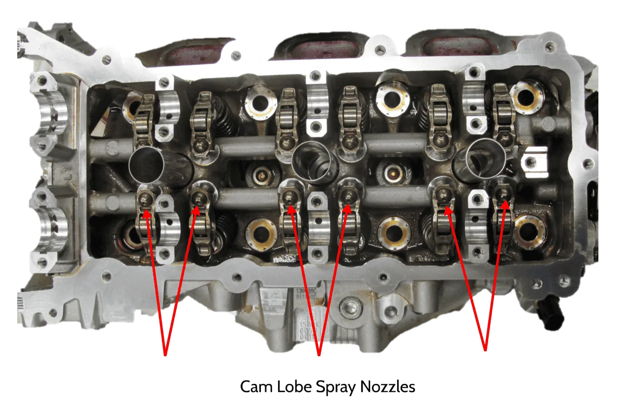

Looks like the exhaust lash adjuster sprays both directions - is that correct?
Jeep Gladiator 3.6 Engine Tick 1680977089844
Jeep Gladiator 3.6 Engine Tick 1680977150252

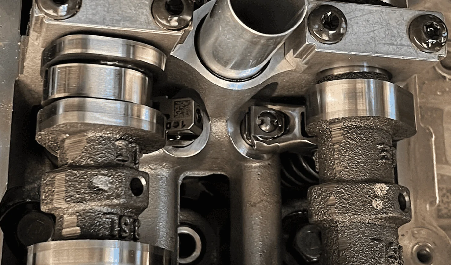

The exhaust rocker has an opening for oiling the exhaust cam, but on the right bank engine rotation slings oil toward the intake camshaft. Also, oil is delivered to the intake camshaft through the intake rockers. So there is actually plenty of lubrication, at least in theory, for the intake rockers on that side.
The left head doesn't have so much oil slinging from the exhaust camshaft onto the intake camshaft. But it seems to get enough oil through the intake rockers to keep it well lubed.
What makes this odd to me is that I have put in at least ten right intake camshafts for every left intake camshaft I have replaced.
And the reports mirror what you said - as well as documentation on replacement and so on. Right side it easily 10 to 1, if not more, over the left.
If anyone thinks that oil flung from a shaft isn't adequate, isn't going far, isn't very high volume, here's the bottom of the intake gasket from my 70 Javelin - those spots are where oil flung up from the camshaft several inches below hit it. This piece sits well above the block casting, the cam is below the block.
