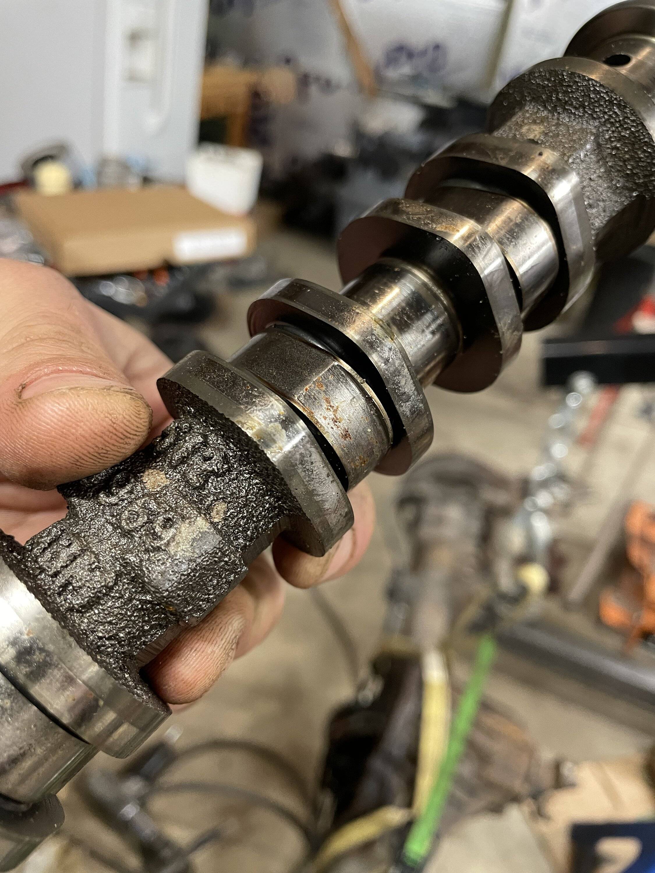

I figured I would follow up in here since I haven’t seen any newer threads on this topic. I had my rockers and lifters replaced this week (and spark plugs and some seals while everything was apart) and it took out my passenger intake cam as well.
Passenger side (right bank, bank 1, odd numbered cylinders) is the "typical" one to go on the 2020s.
Interesting that both high and low lift lobes look like heck from here. The high lift (center lobes) the worse like almost always.

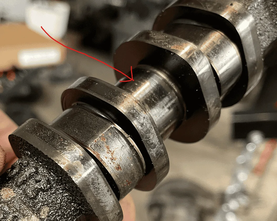

Between the two sets of lobes its that a discolored bearing journel ?
If referring to this -
Jeep Gladiator 3.6 Engine Tick 1680573976023
yeah, that journal looks crappy.
The whole thing is scarred and galled. The lobes are toast - eaten away, and that journal looks like heck.
I'd be concerned about where'd the metal go that came off that high lift center lobe. Even low lift lobes where the rollers run look odd.
Well that suggests an oiling issue doesnt it?
