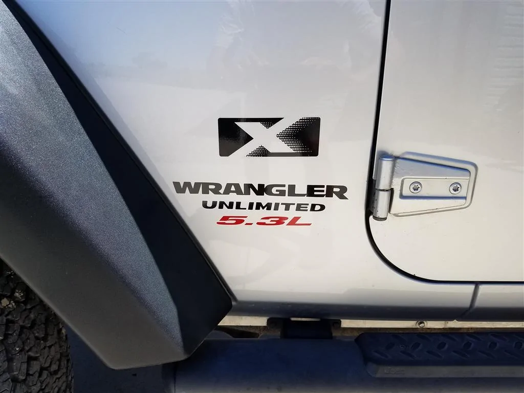

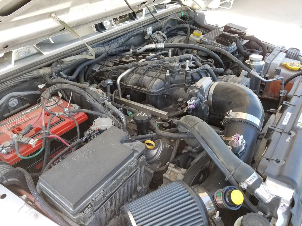

Motech did a JKU LS conversion for me some years ago. There are times I wish I still had it.
Jeep Gladiator 3.6 Engine Tick 20180621_121343 (Medium)
Jeep Gladiator 3.6 Engine Tick 20180621_121620 (Medium)
