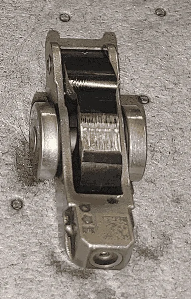

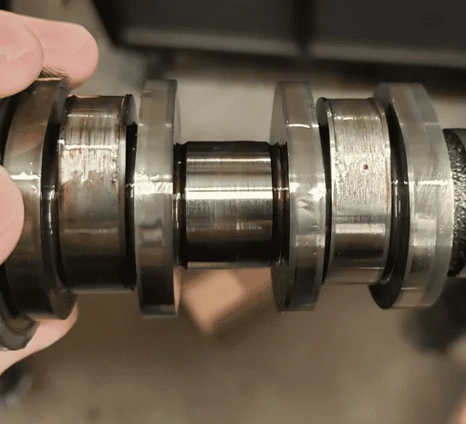

The current generation with VVL doesn't have that same roller and bearing setup.
What is failing on these is the high lift portion of the rocker or follower. There's no bearings involved.
And the cam is damaged right away. When these fail, the current generation with VVL - it's the rocker and cam that are both damaged at the same time. There's no fixing a bearing and saving the cam.
Oil viscosity has nothing to do with this. Likely you ended up with oil that has a better film protection - can handle higher pressure.
Just because you had no other problems doesn't prove the oil fixed it because many thousands don't ever have the problem.
This is not a viscosity issue - check back at all of the posts and pictures of this and the diagrams I've supplied.
The damage is on the portion that operates more like a flat tappet cam setup.
This is the cam damage-
This is the follower damage - not related to any bearing at all - when it's damaged it's trash -
