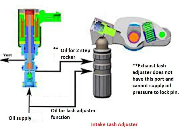

These have lash adjusters. They simply sit in bores in the head.
This is an intake lash adjuster. The exhaust lash adjuster does not have the channel for oil for the 2-step rocker (follower)

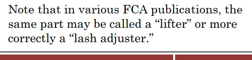

And from a training/intro guide to the 3.6 ->
Jeep Gladiator 3.6 Engine Tick 1657201651435

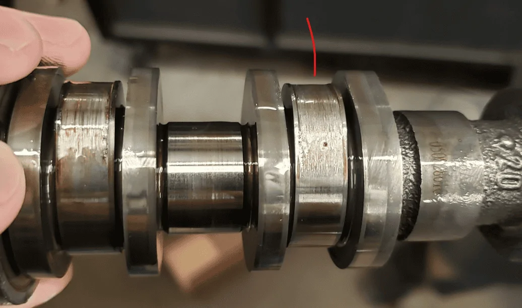

That thing is cut DEEP.
It had to be noisy. I see even the low lift side is scored and worn down a bit.
That one had to be causing trouble as well as the ECU would be expecting different results.
If that was an old flat tappet cam, it would be popping back through the carburetor.
Performance had to suck.
Oddly enough I was getting about 2 mpg better with the noise. Now that its nice, quiet and smooth back to 15.9-16 mpg

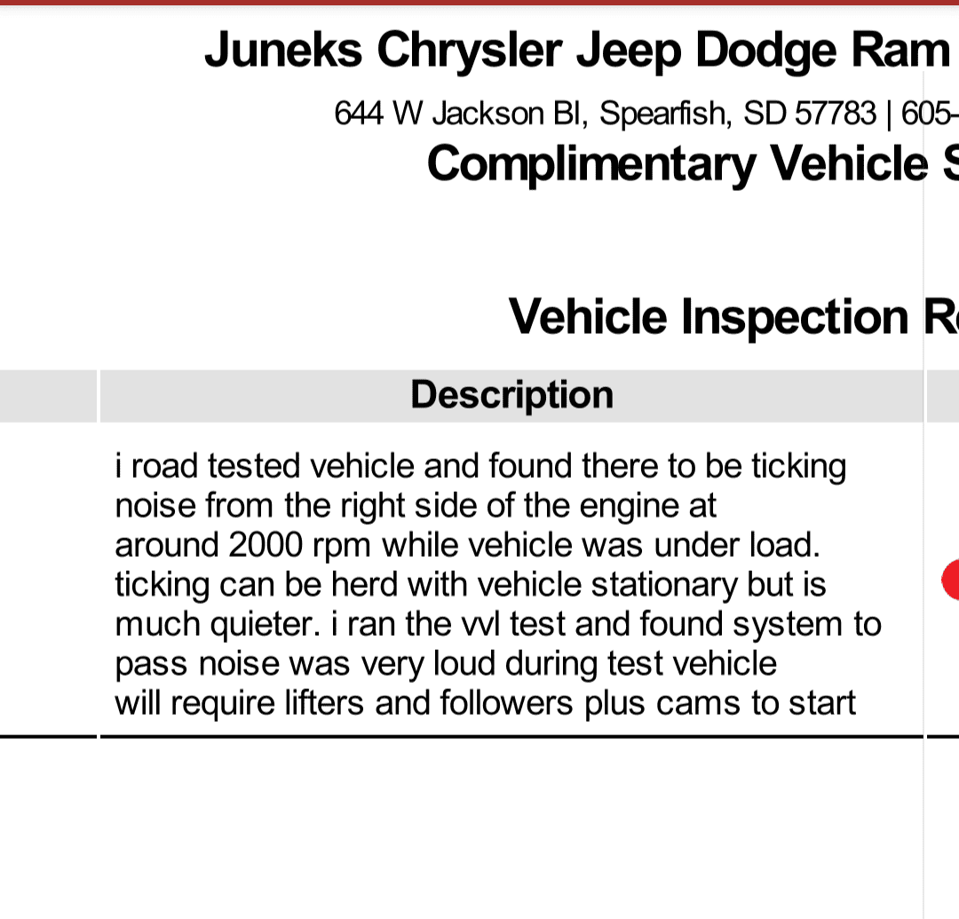

Not to be "picky" and not to start a Internet flame war but lifter is the term the dealership used. :-P
Jeep Gladiator 3.6 Engine Tick Screenshot_20220707-102955-349
sharpsicle
Apr 29, 2021
2,809
6,336
Tampa, FL / Milwaukee, WI
How do they plan to replace a component that doesn't exist on the engine? Lifters by definition are not a part of this engine, and you can't just redefine an existing word and pretend it's the same thing. This is akin to them saying "tire tread bad, requires new wheel" when they actually meant "new tire", and everyone pretending 'wheel' and 'tire' are the same thing. They aren't. Anyone reading it would order a new wheel entirely, as that was what they identified as the problem. I know mechanics are notorious for not spelling or using the right words, but all that means is they're still wrong in their reporting.

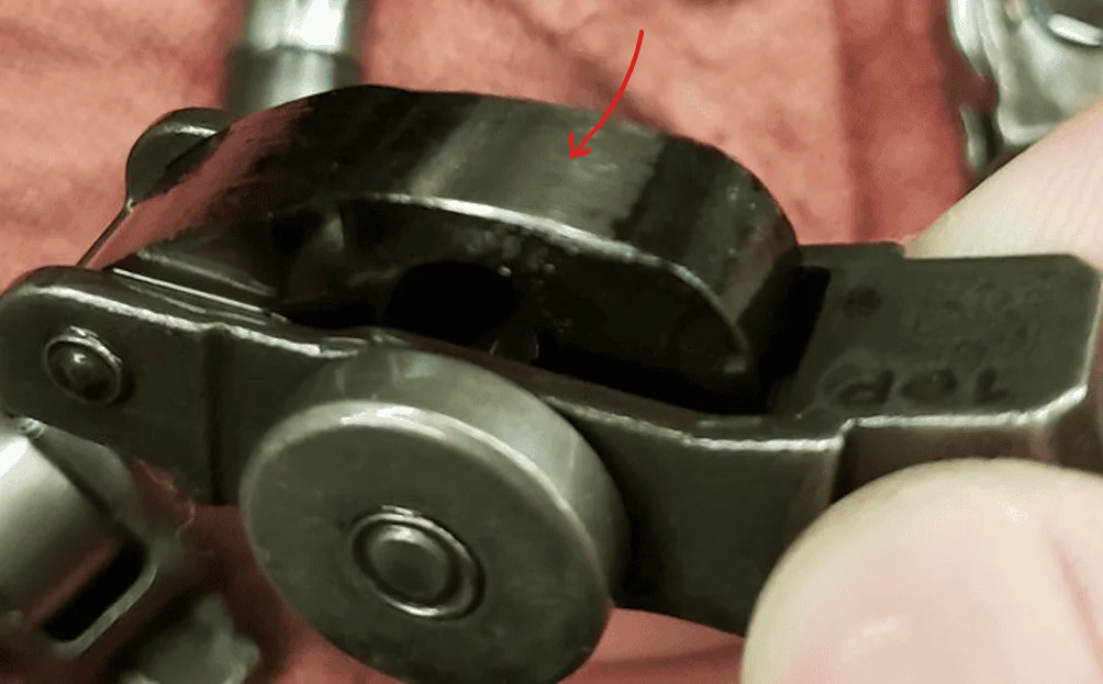

Back on how this design is different, and the part that actually opens the valve - this is also from FCA training materials -
Jeep Gladiator 3.6 Engine Tick 1657215120508

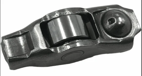

Familiar looking single-lift roller finger followers - the piece that opens the valve, it follows the cam lobe profile.
The reason I bring this up is because the EXHAUST followers in these is the same design that the INTAKE and EXHAUST used prior to 2016. So if you look at a 2020 3.6 exhaust follower, it will be a roller design just like in 2014.
The intake will be totally different design, new, unique for 2016 and later.

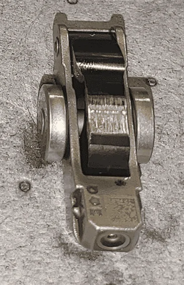

This is a 2020 intake follower - same as 2016 and later INTAKE follower -
the trashed center part is the high lift portion. The outer rollers are the low lift portion.
This is how your 2020 and later fail - the center portion of the follower rubs on the cam's middle profile and trashes both cam and follower. When these fail - this is what fails.

This is a 2014 3.6 Pentastar intake follower - Note that the center portion is roller.
The intake and exhaust followers were the same before 2016.

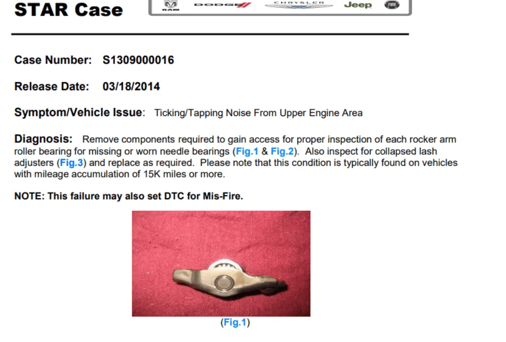

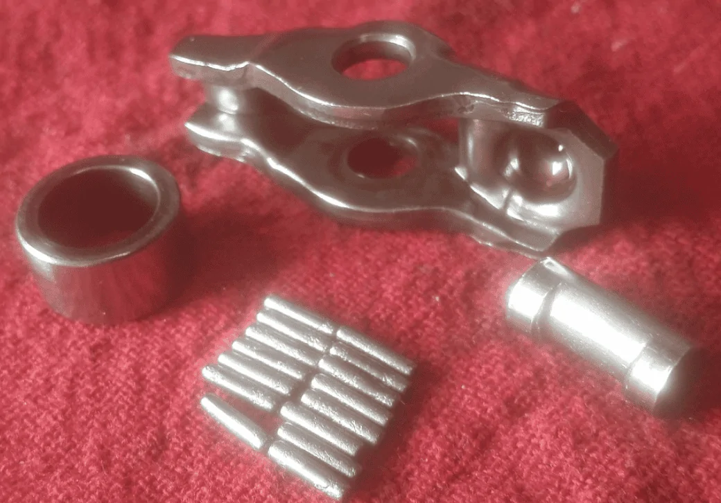

When the 2015 and earlier 3.6 Pentastar followers fail - THIS is how they fail -
The needle bearings get trashed, the pin is cut away (lower right in pic) and they start hammering on the cam.

Jeep Gladiator 3.6 Engine Tick 1657216469063
Rollers are ok - high lift area shot -
Jeep Gladiator 3.6 Engine Tick 1657216533475
Old style failed differently - the cam was still scored, but it was the BEARINGS in the rollers that gave out on your 3.6 before 2016 -
Proof? Here it is -
Jeep Gladiator 3.6 Engine Tick 1657216840186
DIFFERENT design, DIFFERENT failure CAUSE. Similar result - wiped cam. That's the only thing they have in common. So no, it's not the same design flaw or cause.
