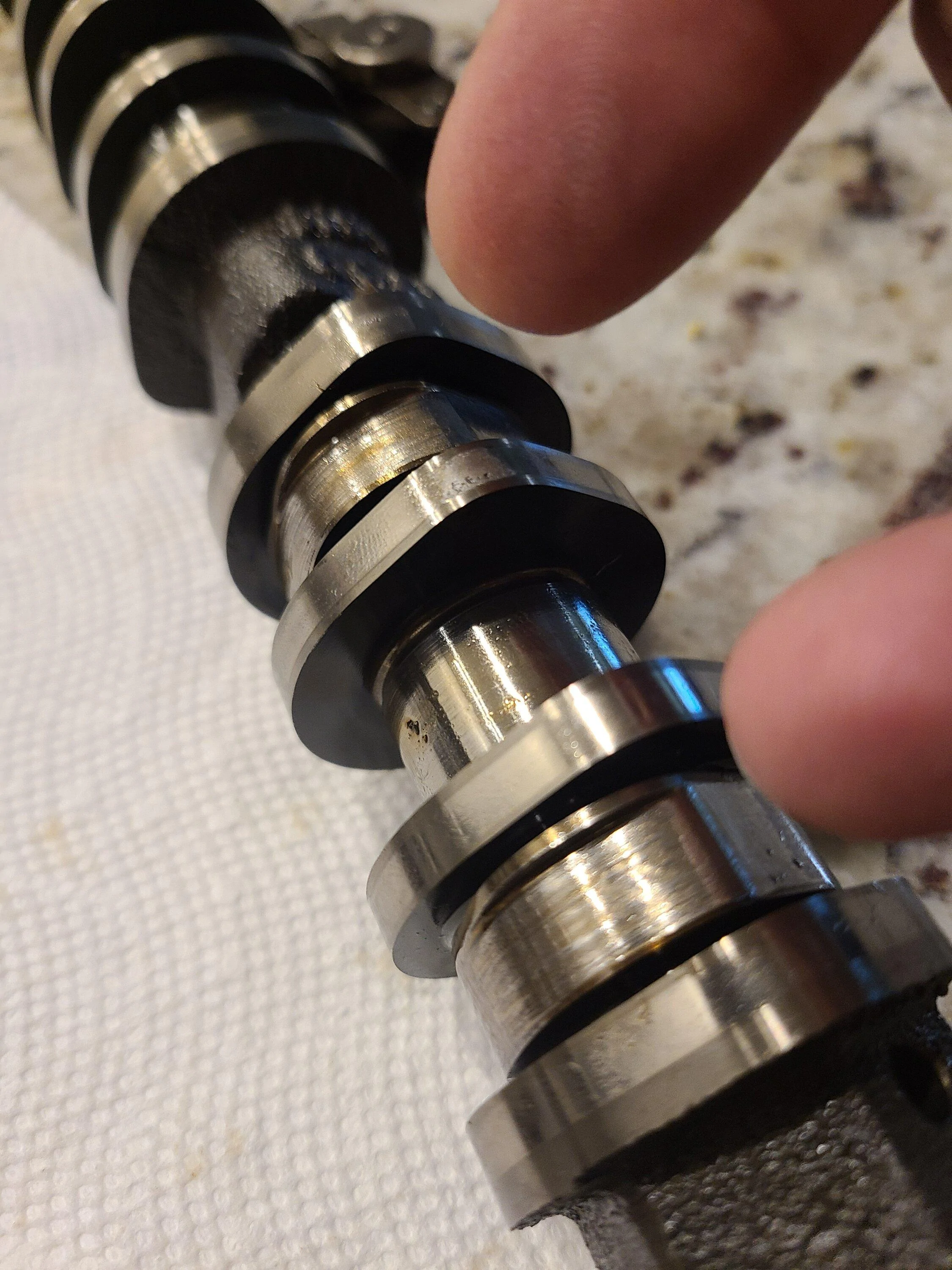

250
40,617
54,330
That thing is cut DEEP.
It had to be noisy. I see even the low lift side is scored and worn down a bit.
That one had to be causing trouble as well as the ECU would be expecting different results.
If that was an old flat tappet cam, it would be popping back through the carburetor.
Performance had to suck.
