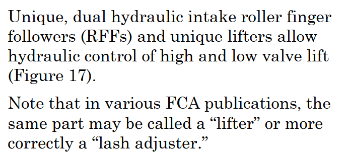

I've found STAR documents that seem to interchange the terms. They could loop it back around and say "well, a 1975 SBC lifter was also a lash adjuster" and then it becomes - 'whatever'.
At least the followers do rock, the fulcrum is on the end instead of near the center.
As long as they communicate properly with each other and the parts department, get the correct parts ordered and replaced.
Note they correctly say "follower" but then use both terms for the lash adjuster - the wrong one first and then explain next paragraph.
