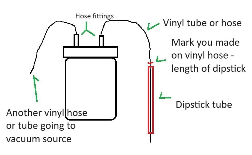

For those who are really really bugged by it and just still feel it's going to cause damage, there's a simple solution and you don't even have to get under the truck or grab a wrench. You can do it standing upright in front of the truck.
Pull the oil out the same way I take oil samples. I take "before the oil change" samples - And I don't even get my hands very dirty doing it.
Warm the engine up - if using for an oil sample, a good 30 minute drive is recommended, if just to remove excess oil, drive it until the oil temp is up close to normal - 170+ so it can be pulled up a tube easily.
Pull the dipstick out.
Lay a length of vinyl tube (sized that will slide down the dipstick tube - forgot the size I use) next to the dipstick and line the end of the tube up with the dipstick.
Make a mark on the tube using tape or a black marker right about where the top of the dipstick and beginning of the handle is. That will be the mark showing you have the tube inserted into the dipstick tube far enough.
Don't cut the tube yet.
Slip the vinyl tube down the dipstick tube until it reaches that mark you made on the tube.
Leave yourself a comfortable length of vinyl tube sticking out of the dipstick tube to reach near the front of the engine bay.
Take a clean plastic or glass jar with a plastic or metal lid and make two holes in the lid just large enough to put a couple of hose barbs into the holes and secure them with nuts on the inside.
The vinyl hose in the dipstick tube will be pushed onto one of the hose barbs in the jar's lid and another length of hose will be pushed onto the other hose barb.
Apply a vacuum to the loose vinyl tube using a Mighty-Vac, Handi-Vac or whatever they are calling those hand pump vacuums sold for bleeding brakes, checking vacuum motors, checking vacuum advance units and so on, or even a small auto vac - it can even be done by using YOU as the vacuum source. You can pull an oil sample in seconds, and even a quart if you desire, in a couple of minutes or so. If you catch the over-fill right away, now you have a quart of oil to use later to top it off, or as part of the next oil change if you wish.
