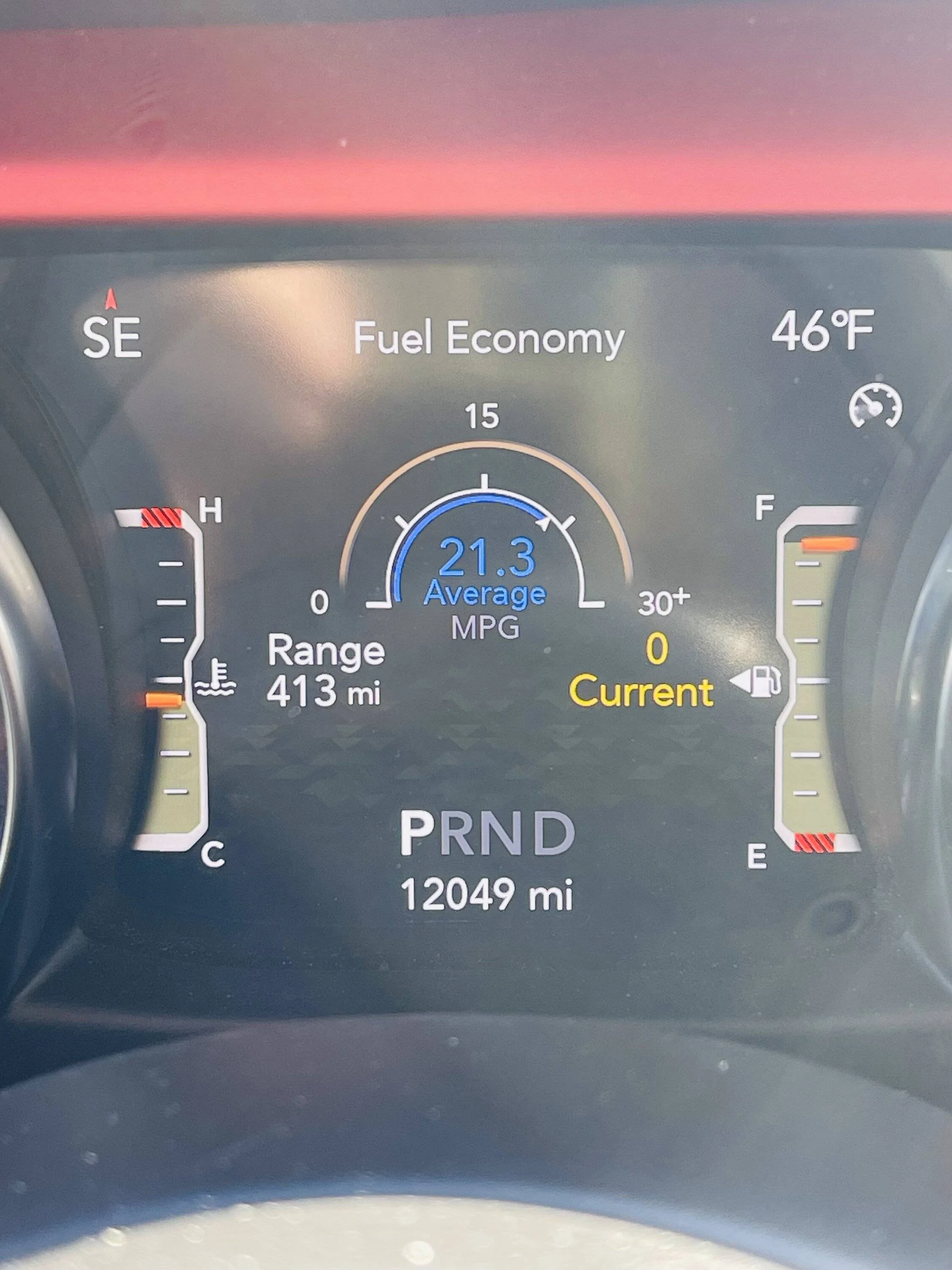

I have a 2021 Rubi with 12000 miles and as many of you reported I also have the engine chatter. I don’t do my own oil changes and each time I have taken for service I mention the engine chatter and get the “We will have a look” statement. Inevitable, the final feedback is we could not find any issues. And to be fair, following the oil change the engine is noticeable quieter. For reference I have the oil changes between 4k and 5k miles. Also, there are times when I have stopped at Jiffy Lube with the same results, chattering going in and quiet or coming out.
Getting a bit nervous about needing a lifter rebuild at some point based on posts. I was thinking back to my granddad who swore by a dose of ‘SeaFoam’ as the ultimate in engine protection, so I thought why not. I bought both the formula for the crankcase and the fuel system and followed the instructions not hoping for much. When applied my oil life was at 45% and the engine was chattering as usual. Within 20 minutes of adding the engine was as quiet as any other vehicle I own or have owned and again this observation is from an unscientific perspective but the engine just seemed to run smoother and easier.
Now for the freaky. Today I took a 300-mile trip, I kept to 65 mph, and was using the cruise control like normal for interstate runs on roads that was a mix of flats and mountins. For the trip I averaged 21.3 MPG. I have never, ever, had this kind of mileage since purchasing the jeep, running the stock 33s Wildpeaks, and again I generally don’t care about mileage. Face it we are driving bricks. My normal MPG averages have been 13.5 around town and no more than about 19.5 on the highway since the day I took delivery. After getting back home I took another listen and there was still no chatter coming from the engine.
I’m sharing because I see the posts about engine rebuilds and granddad may have known what he was talking about. In fact when I read the posts about needing rebuilds it makes me want to go back and buy the extended service contract. I still love my Gladdy and have no plans to part with her but based on my experience with service and oil change behavior one may believe that the problem is the recommended oil is not sufficient for these engines over time? I would be interested to hear if anyone else has had similar experiences or thoughts.
I have another trip next month and will add and update on my experiences at that time.

Cool story. I’ve wondered about that stuff in my engine to see what happens with my never ending high IRON count on all my early oil analysis reports.
My 2nd engine is somewhere around 50k kms, runs extremely quiet, and all the wear metals are low except the Iron…. So I might give it a shot to see if it magically helps.
As far as the mileage reading that has surprised you, …did you reset the odometer when you filled up?

I did not do the reset and was at an average was around 15.5 before starting out. Good point though, next trip I will reset and see where it ends up at. It’s was so jacked up to see that range number, had to do a double take.
