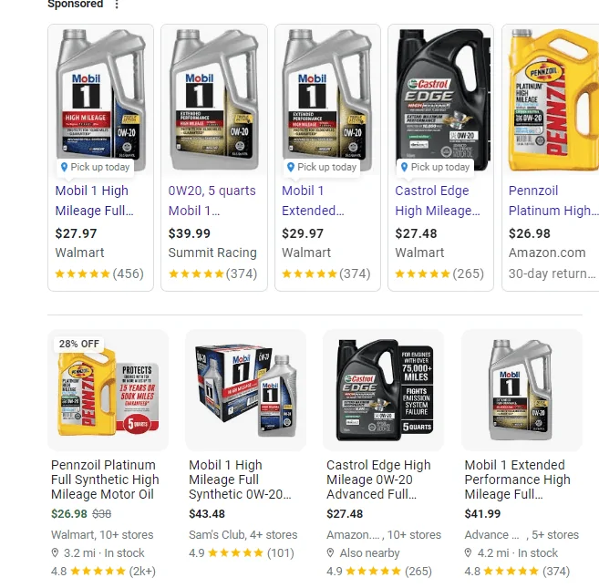

While I was writing this, I thought is there and actual 0w-20 high mileage ?, and yes there actually are:
Jeep Gladiator 3.6 Engine Tick 1706200304825
So what would be better for a 3.6 Pentastar with above 75k? go higher in viscosity to 5w-30 or use a 0w-20 viscosity, but with (I guess) additives that enhance and are better suited for high mileage engines ?

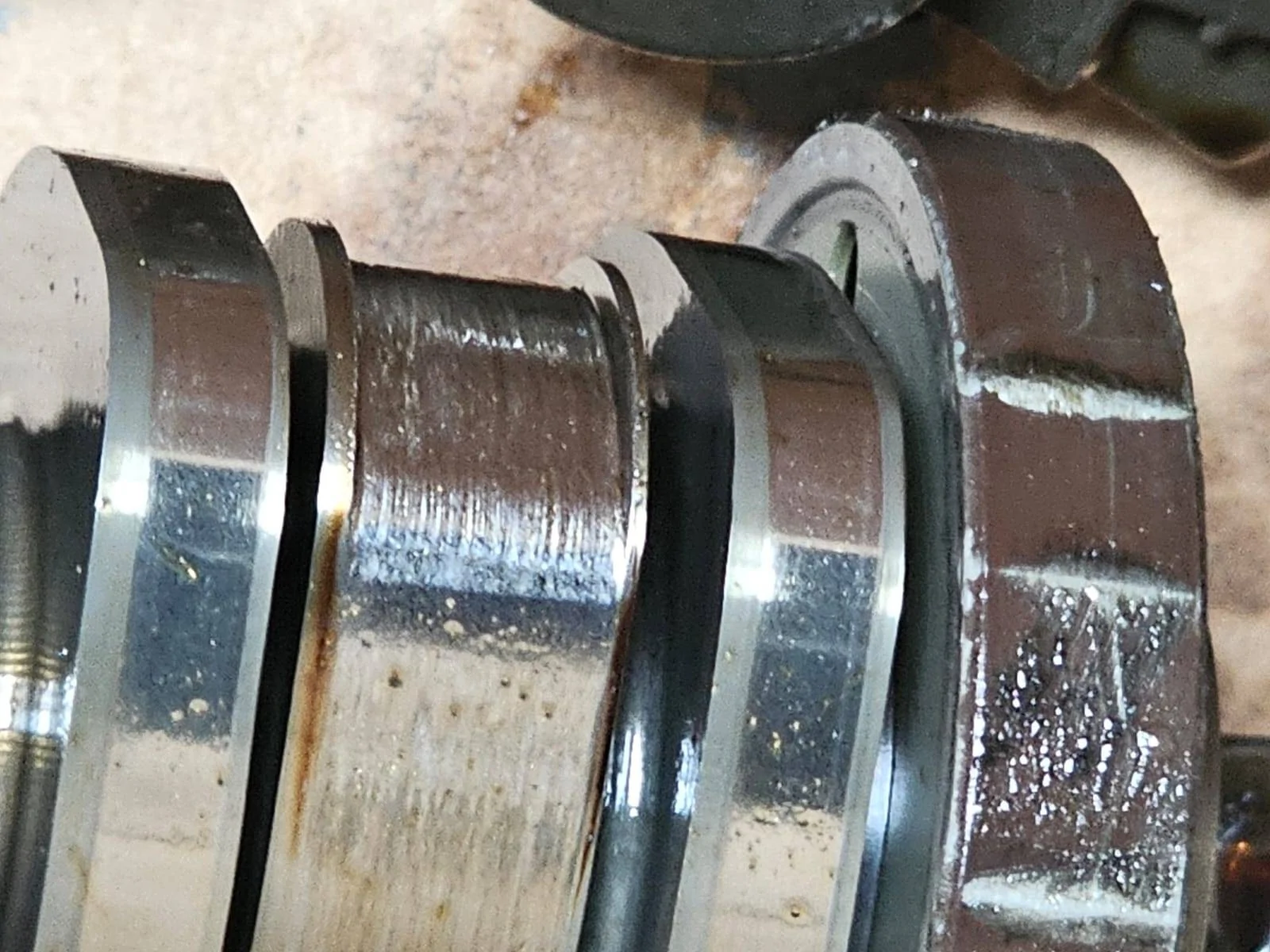

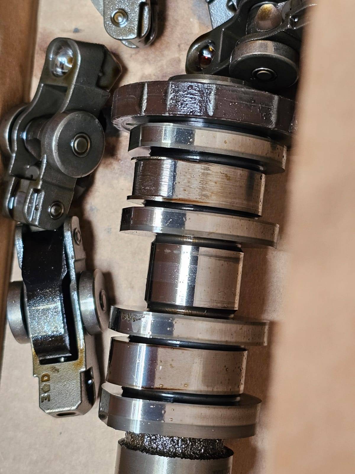

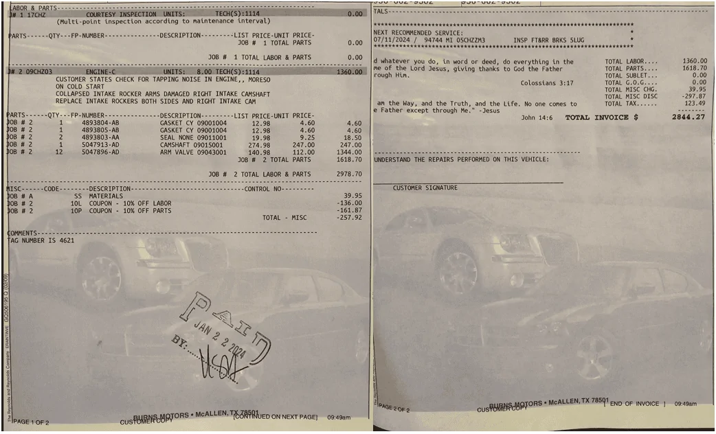

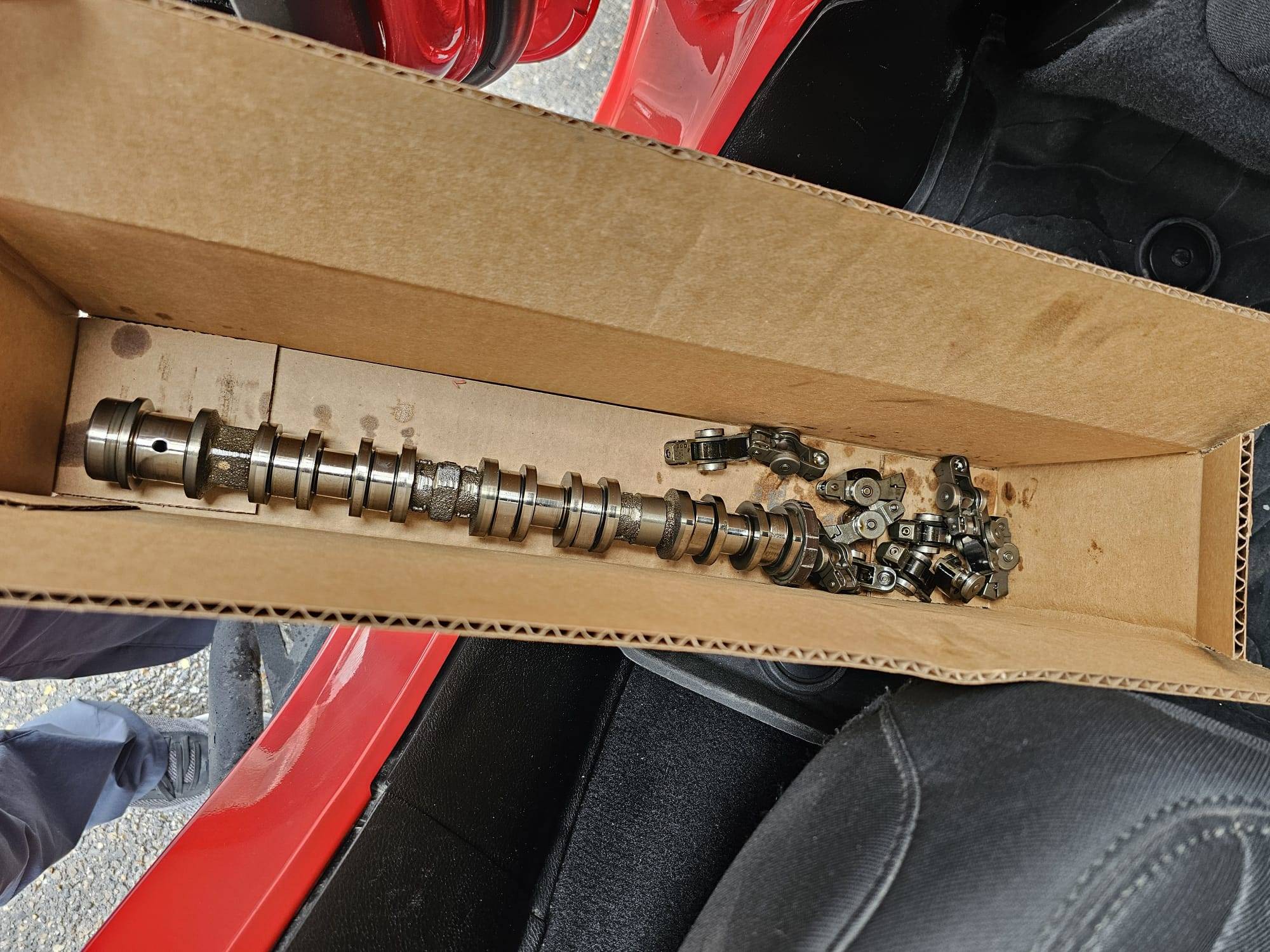

Purchased in June 2019, currently 86k miles, started hearing the famous tick of the 3.6 Pentastar like 8 months ago and the noise increased slowly until I decided It was moment to do something about it. I leave a video here to show you how it sounded.
I saw couple of videos online and read threads here, and the most common thing is the failure of the rockers, which cause a play in its movement and eventually damaged the camshaft. So based in these videos, where people was doing the job, I was thinking to do it myself, then I thought to bring it to my friends from a Stellantis Dealership in Mexico, where I used to work couple of year ago, to get a better price, but currently they are short in personnel and I was not sure if they have the same technicians and capable people to do this. Also I looked around for local Engine shops, but not luck or the service and prices I expected. I ended up in my local dealership, located McAllen, TX, same where I did all my services while I was under warranty, they are good people. Reference: After my warranty ended I continue to do my oil changes myself every 5k, so no problem due to lack of maintenance.
The result was, damaged intake rocker arm damaged from codriver side which caused damaged to Intake Camshaft. Taking advantage that both heads were open when the diagnostic was been made, all Intake Rockers were changed (I then though that I messed up since I could ask to exchange the exhaust rocker arms since they had the Heads open, each rocker arm coast around 11 dll, but well lets hope they are ok for another good amount of time). I think the cost of everything was ok, based on the prices that I have seen here, labor and parts, with a 10% discount was $2,844.27.
I have seen people here with these engines failing at 22k miles, others above 150k miles without a problem. So is there actually a trigger cause? I put a snorkel around the 40k miles, is there a chance that the increased air flow cause an extra out of spec pressure and lead to a premature failure of these rockers? Is just natural result of the lack of rocker quality or the engine design? were all that Mud, Sand, Snow, Rocks, donuts too much for the engine? All of the above?
Hope this fixed last for a long time, before anything else fail.
