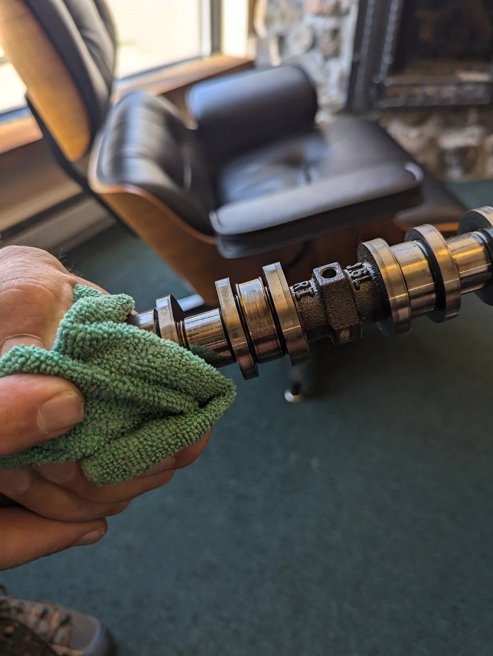

Well, work was done yesterday, the mechanic mainly focused on the worn cam, although they replace matching parts as well that could wear or have caused the cam issue. He said it's not even obvious to them if there's a single point of failure, bad rocker, lifter, debris from something else bad, they've seen it all in the 3.6 and 5.7 Hemis.
Mine didn't have any oil contamination they saw, although I'm going to do an oil/filter change anyways. He said they have to hang onto the bad part for a few weeks for any warranty work, but cleaned it up so I could take a picture. Worn part is closest to rag:
Jeep Gladiator 3.6 Engine Tick gladiator-worn-cam
Engine sounds so quiet now, just purrs. Never the greatest experience having a quality control issue like this but I've had no other negative experiences in the 30K miles. Totally happy with this new-to-me dealership and the quick warranty approval. Will be testing the oil down the road before my warranties run out, but I have a 7 year/100K mile extended.
