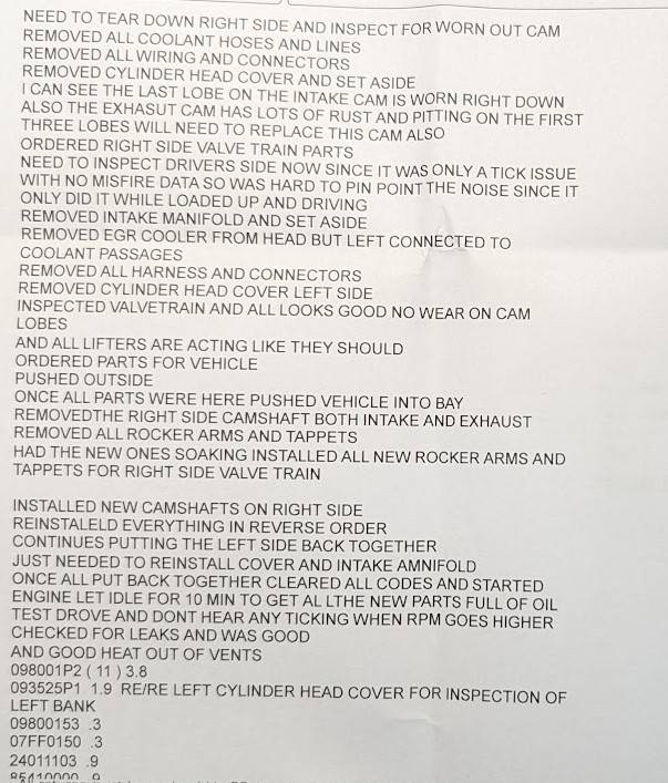

Update:
My car is at the dealership since Nov 26. They confirmed the issue is what they were expecting, related to the camshaft.
It'll take a couple of weeks for getting all the parts.
Up to now they provided a rental car through Enterprise. It might be that they will switch from the rental car to a loaner, since I think there is a limit on rental car usage through the Jeep Wave program.

Cool, well hopefully it gets fixed and buttoned up soon. Fortunately not a lot of snow yet in BC.
I'm gonna wager its the right intake cam. And hah for bonus points I'll say only one lobe is destroyed.

I got my car back last Tuesday and up to now all is behaving as expected.
The work order notes were rather impressive. I've attached for those interested.
Jeep Gladiator 3.6 Engine Tick Screenshot 2024-12-16 095730
That tech must have heard what I told an auditor at the dealership I work at years ago. "Chrysler pays fifty cents a word for the writeup. "

This sounds exactly like a typical ticking right-side intake cam to me. If you are bringing it to a shop ask them to put a stethoscope on the right side valve cover and it should be apparent without taking it apart.
