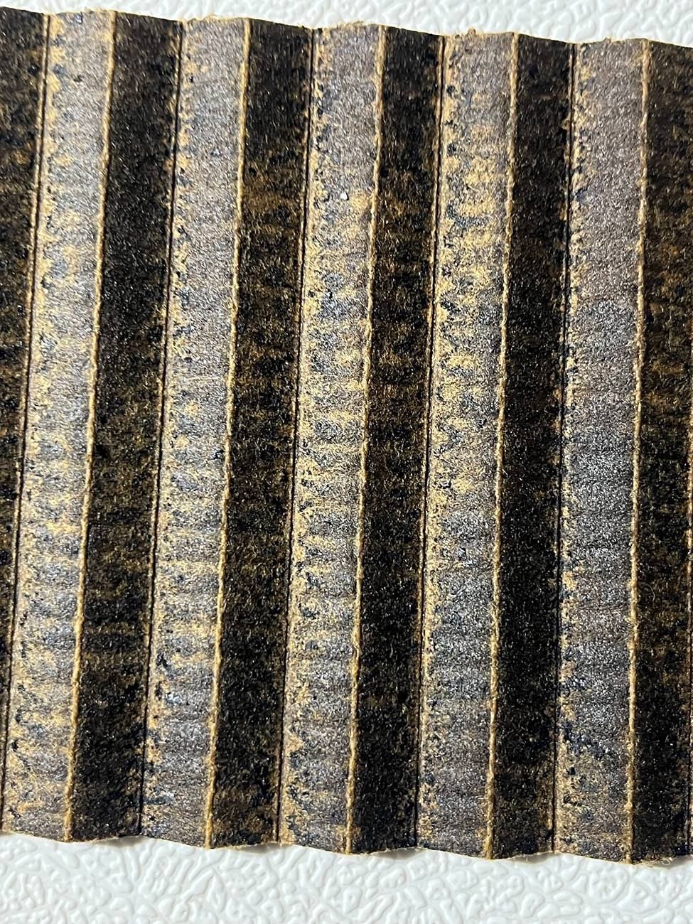

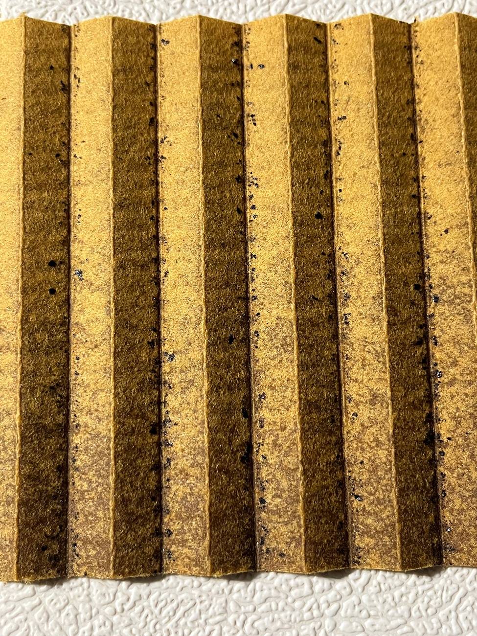

Some here may recall that a while back I had pulled apart my used oil filter, as I always do when I put a new one in, and I was very surprised to see ‘blackish’ stuff in the pleats that I’ve not seen before. Had the filter analyzed and lab said it was carbon but to also remember oil is a hydrocarbon. When the lab scraped it off the filter and dried it down to a powder, it wasn’t burnt or scorched carbon like you’d see on your piston heads, it was a light brown powder.
In the life of this second engine, I started using Quaker State for a while, then switched to Mobil 1 for the next while, then switched to Penzoil Ultra Platinum for the next while and it was here that the carbon showed up in the filter.
The lab had a look at the detergents in the 3 brands and saw that Quaker State had the lowest followed by Mobil 1, followed by Penzoil having the most detergents. It was the lab techs “opinion” that whatever “carbon” was being stuck on the internals was then being cleaned up by the Penzoil.
After running about 3 oil changes @5000 kms each (50% oil life), and seeing the carbon build up in the filters, I wanted to do “something” to help clean it out of the engine so I had used Seafoam twice in the oil.
The first time, I was at 4500 kms and dumped in 1/2 can and drive 500 kms and again saw a bunch of this carbon in the filter. I changed the oil and dumped another 1/2 can in and drove another 500 kms and did another oil change. (Pic attached is filter at 500 kms with Seafoam and the black bits is carbon. The other pic is filter at 5000 kms showing carbon)
I too worried that this carbon crap was plugging up oil galleys. I have since switched to Mobil Super Synthetic to see how it does.

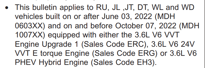

Yes ->
(sadly, it covers mine so apparently they are aware of a potential issue with engines made June through the first week of October 2022)
ugh, My MDH is 92900 so yeah...thanks for posting it. I printed it off, have been suspecting a tick for a while. I guess the dealer can sort it out now.
