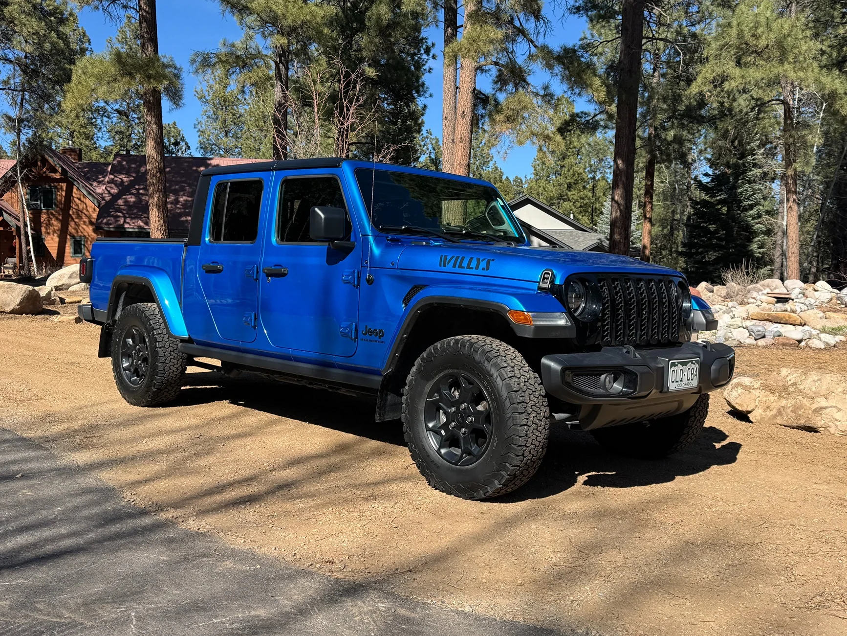

I have a '23 Willys set up similarly to yours. I added the TF 1.5" spacer lift, TF's 2" front shock extensions, and to restore the caster, the front lower control arms from the Mopar 2" lift
First thing I did, literally the morning after I took delivery, was to get rid of the wretched 32" BFG KM2s that were OEM and switched to 285/70/R17 BFG KO2s. There's no rubbing anywhere. I used JSCAN to reset the tire size and recalibrate the speedometer.

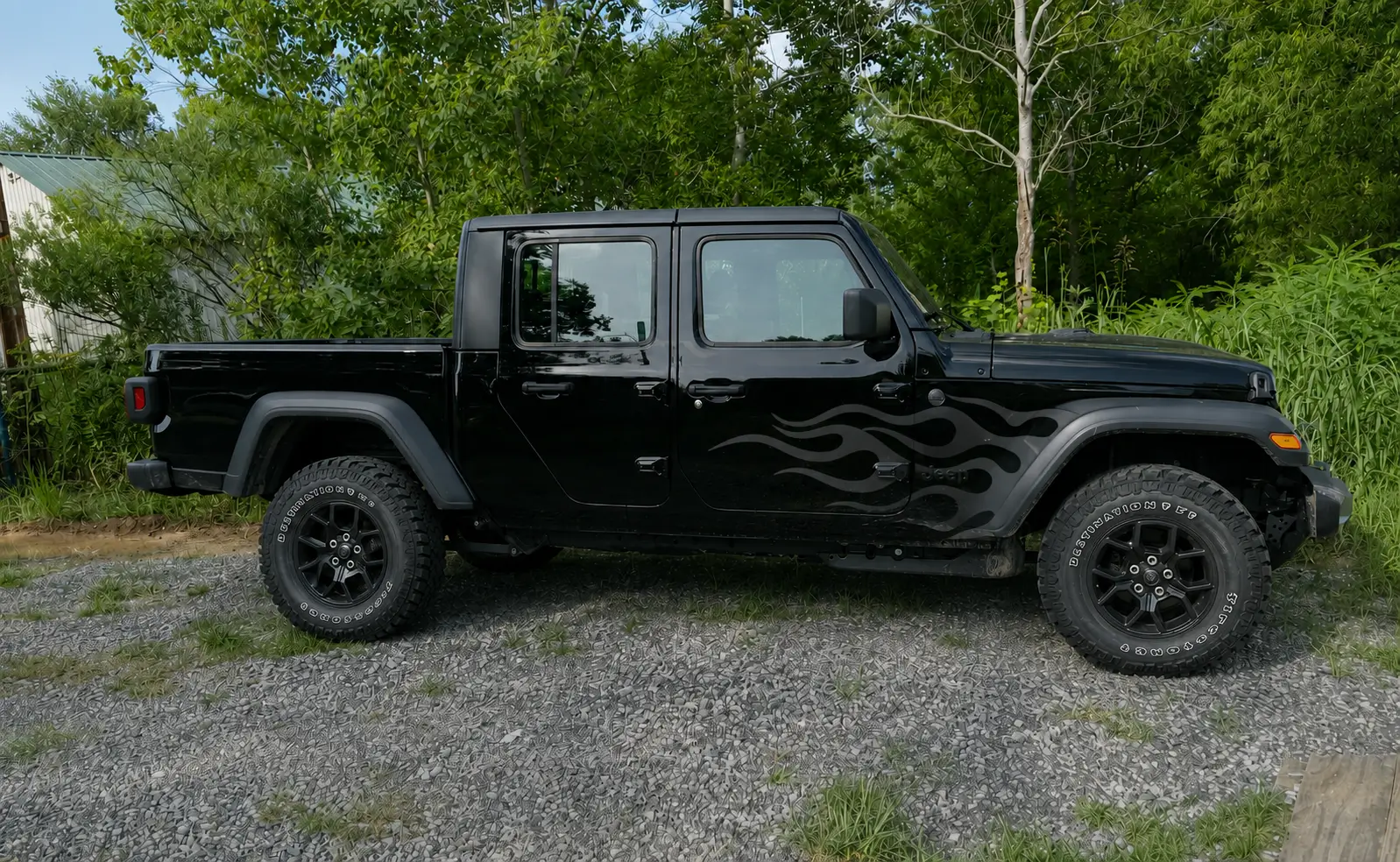

my JT Willys came from the factory with 255/75s on 7-1/2" wheels, as clearly indicated on the window sticker.

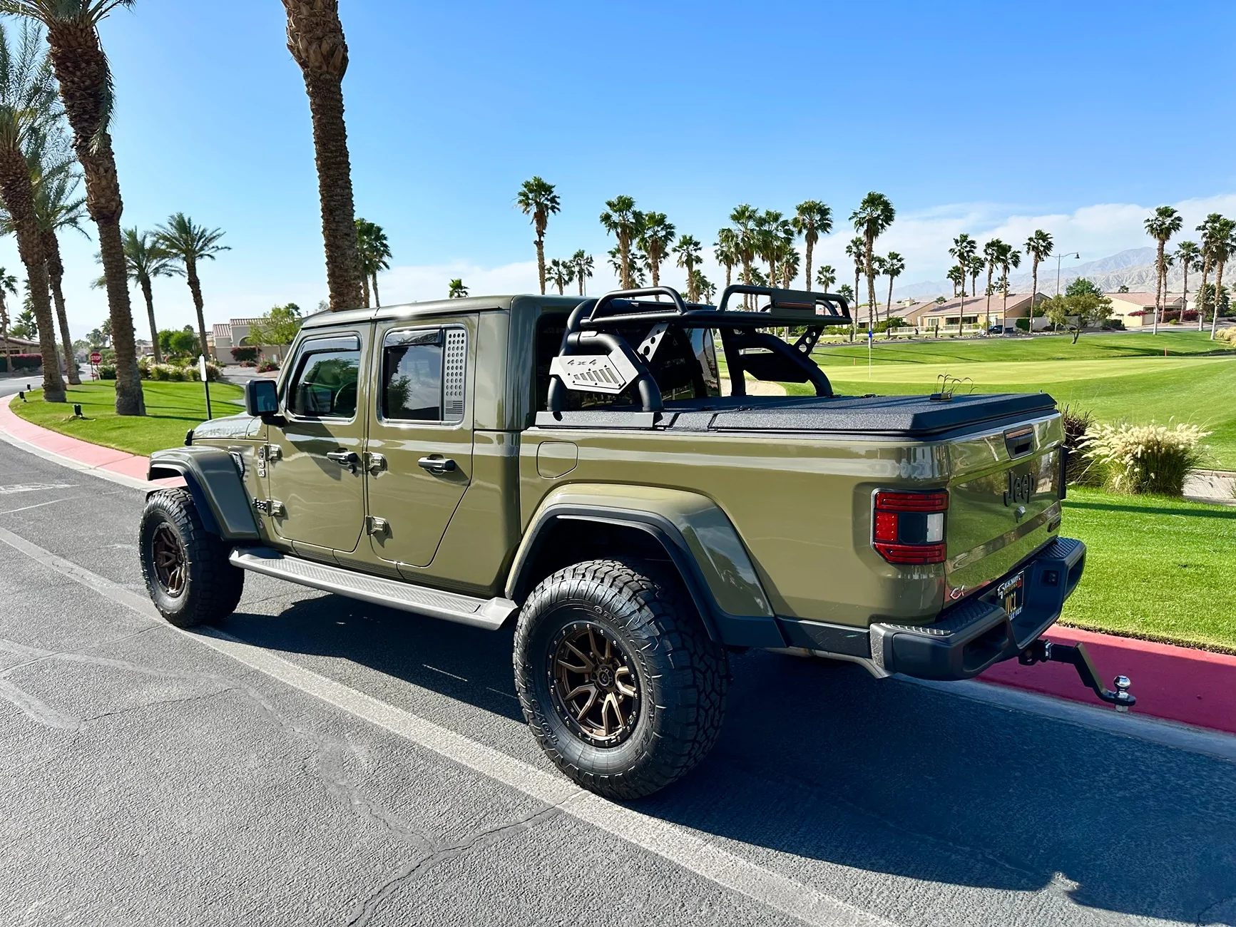

High Tides do not have the wide axles (I don't believe) - so you could have some minor rubbing on the front air dam when turning. You can trim that. You can put the 33s on and then add spacers after the fact if you end up deciding they'll help with some clearances.
We have 35's on our High Tide and have zero Rubbing, we did do a 2" AEV spacer lift but still runs/rides perfectly

Those wheels offset way more than stock would also be helping that lack of rubbing 😄
Cool truck!
