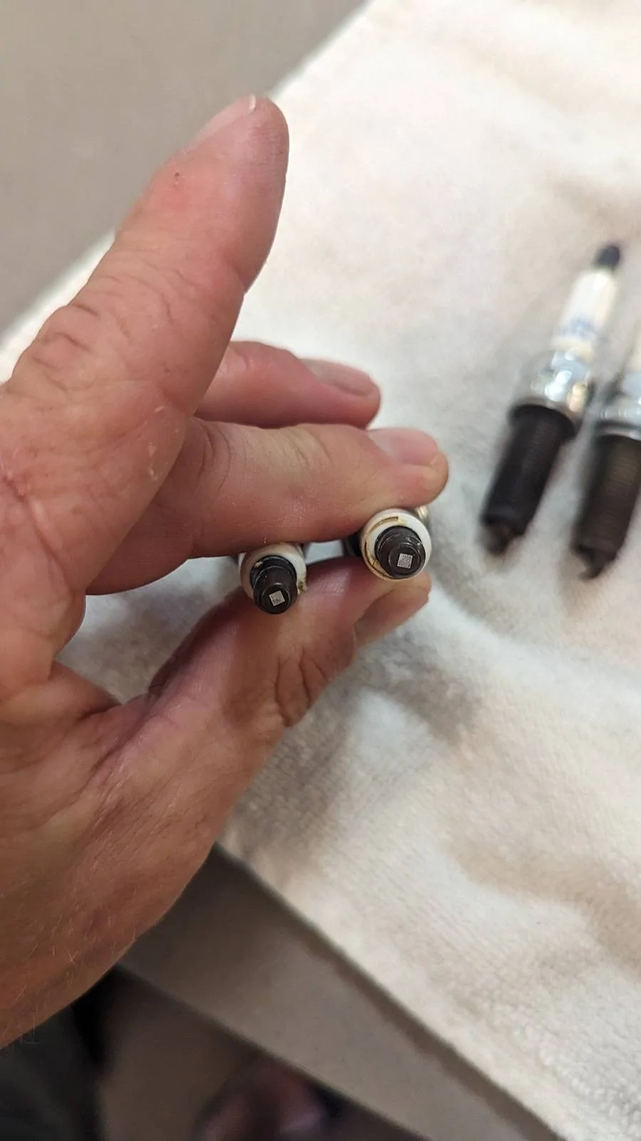

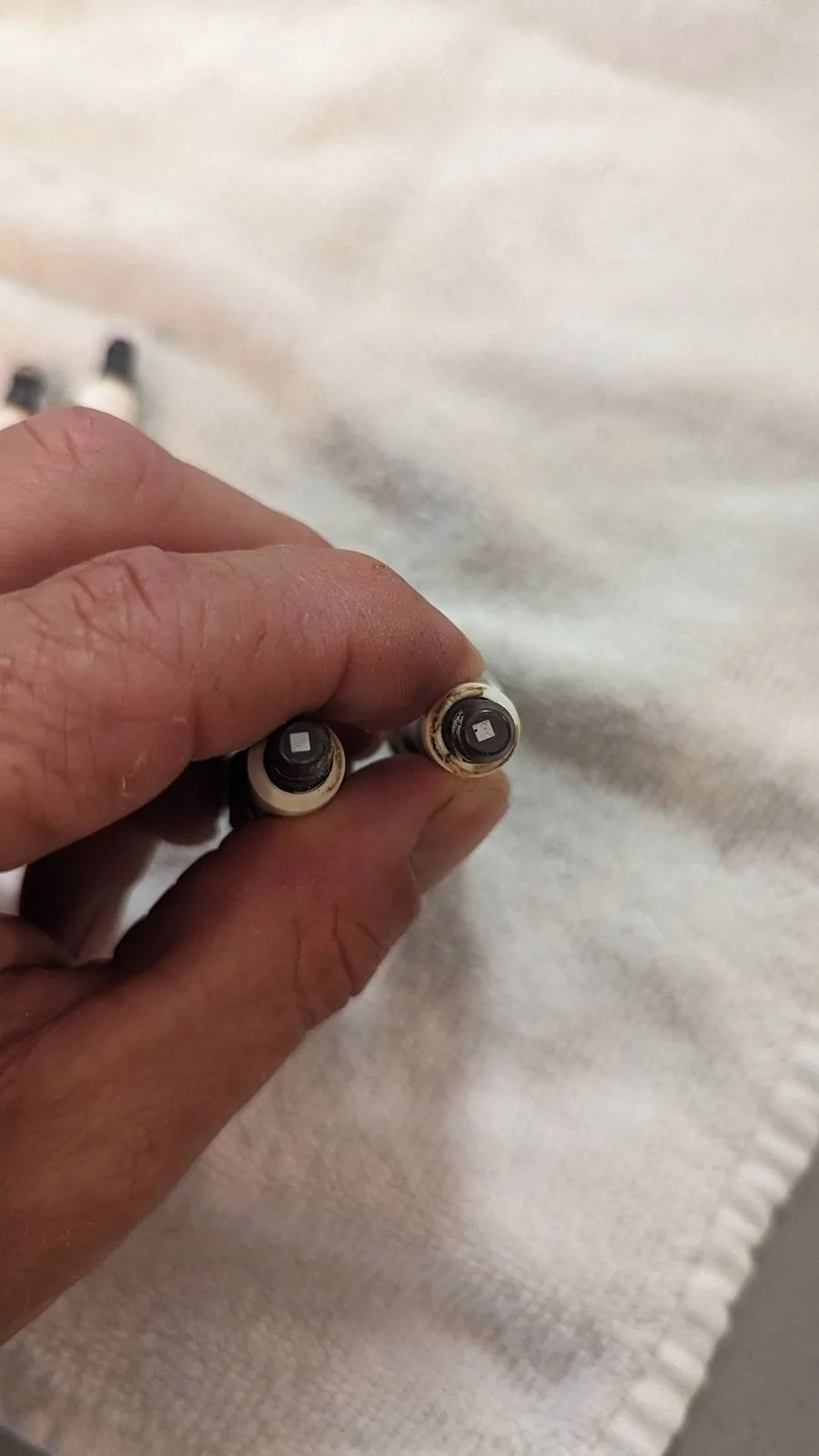

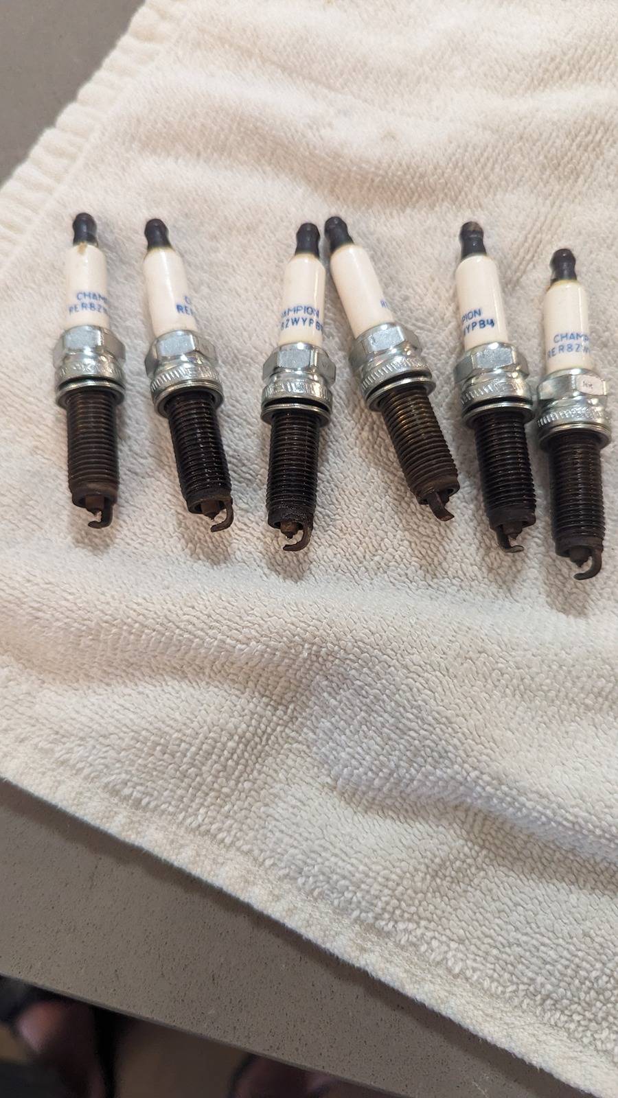

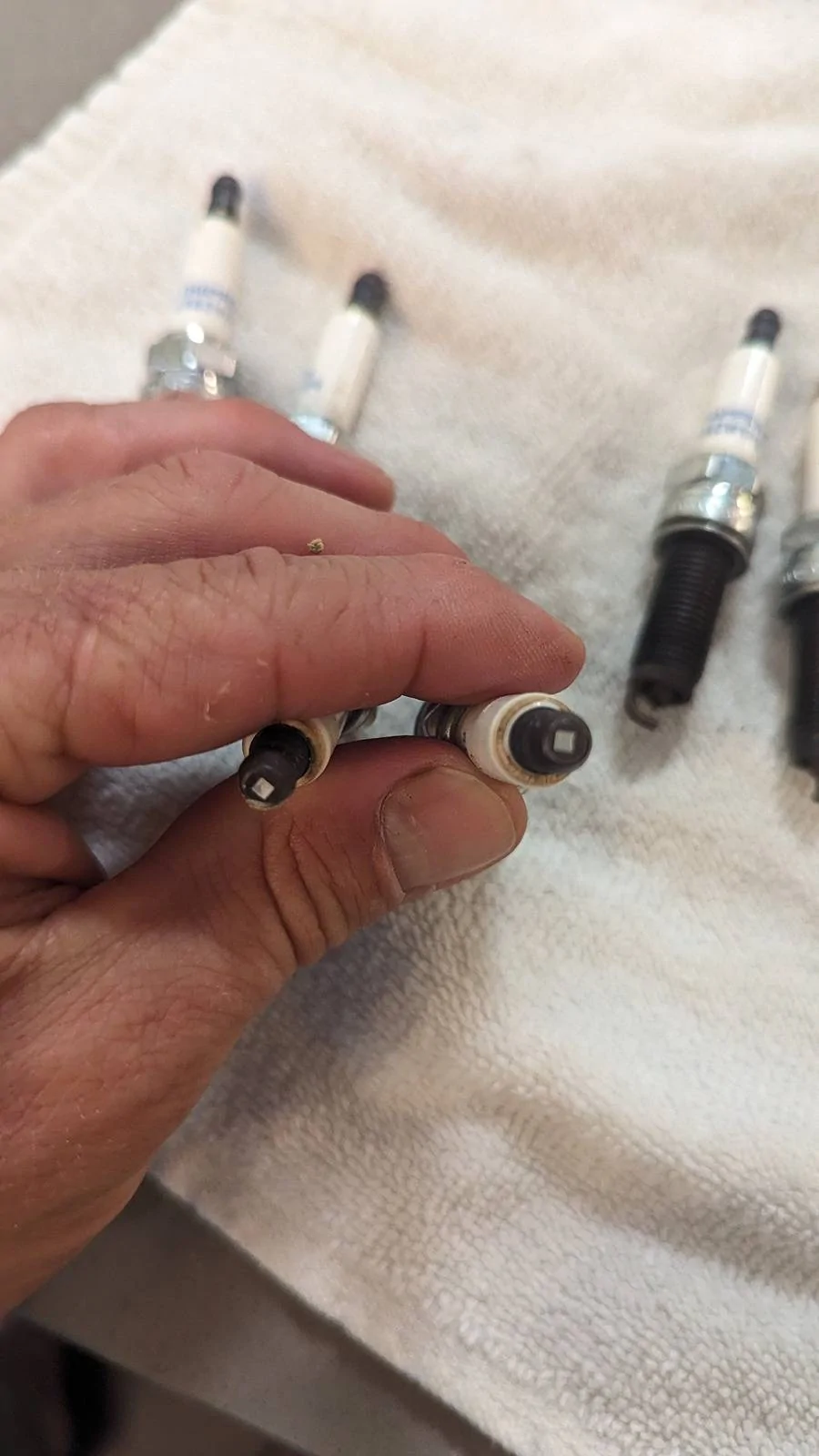

Here are a few pictures of the plugs for you and anyone else that is interested. He said they didn't look to bad. My plugs in my 2010 JKU look way worse than this at 85,000 miles when I did them. My JT has 91,700 miles on it so I'm pleased with how they look. It seems the rough idle is solved as well, time will tell on that I guess but it seemed a lot smoother when we cranked it up. I let it run for 5 minutes and no shutter.
It took him an hour and half to do it and we talked some as well and I saw the process of how it's done. More than I'd like to tackle so I feel like it was worth it to me to let someone else handle it for the price. I could of done it but probably a 5 hour job for me because I'm definitely not mechanically gifted. I can do some things but I'll leave stuff like that to the professionals.
Only a tad worse than mine were at like 47k miles when I did them. They were good enough that I kept them for long trip spares along with the Oem coils. I too was happy they looked as good as they did. But mine runs a little better after as well.

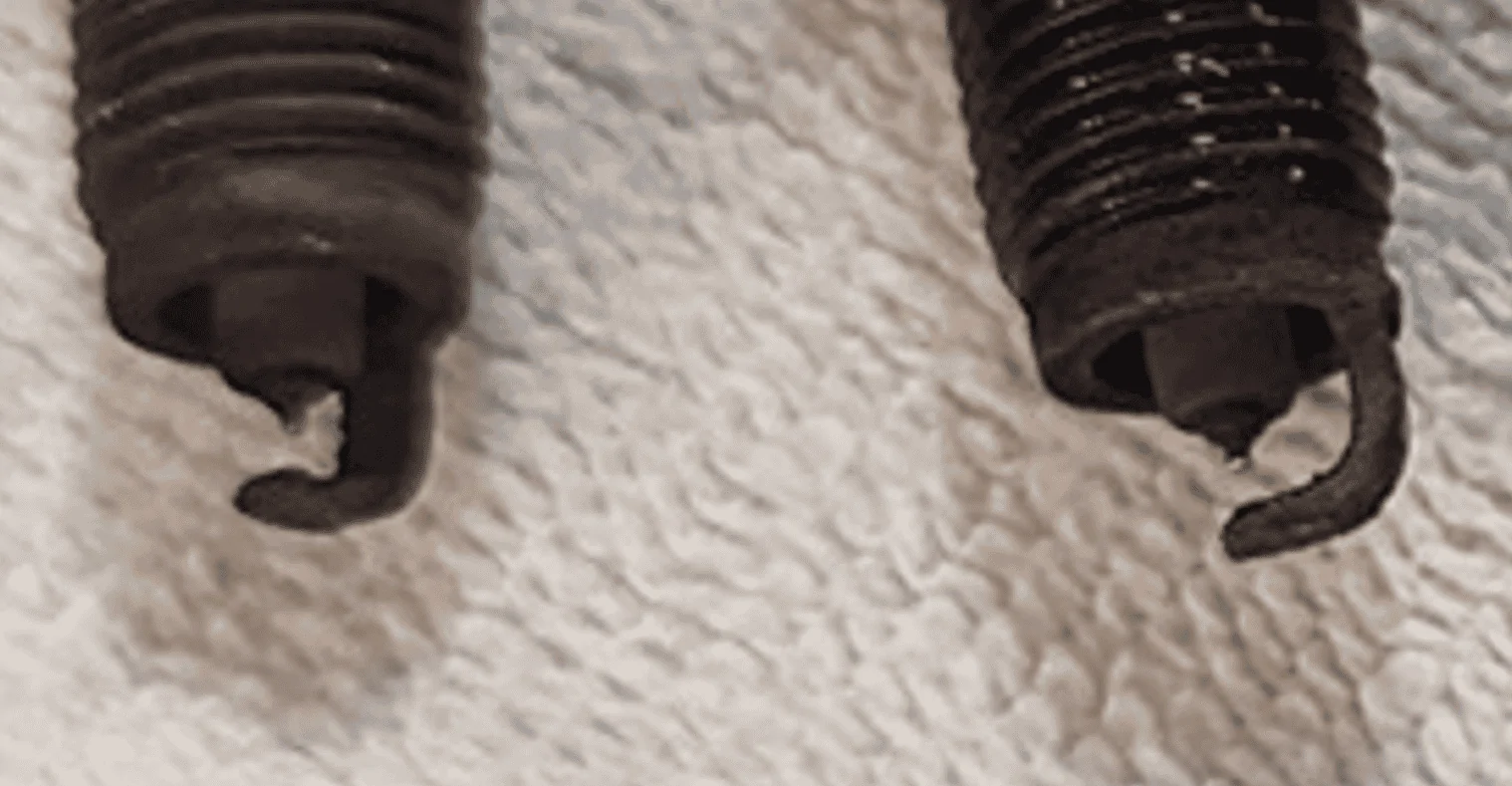

These engines run so close to stoich much of the time so spark plugs shouldn't be a major issue - should look clean, very little carbon and so on.
Here's the end I care about - the electrodes, especially the center and the insulator around it -
Looks like your timing for changing them is about right. The electrodes are normal looking from my fuzzy enlargements.
That was my thoughts when seeing them. I was expecting them to look worse and was surprised at how well they looked. When I pulled them out of my 3.8 in the JKU they were trashed at 85,000 miles. Though a much easier job to do, I'd rather have something last longer honestly
