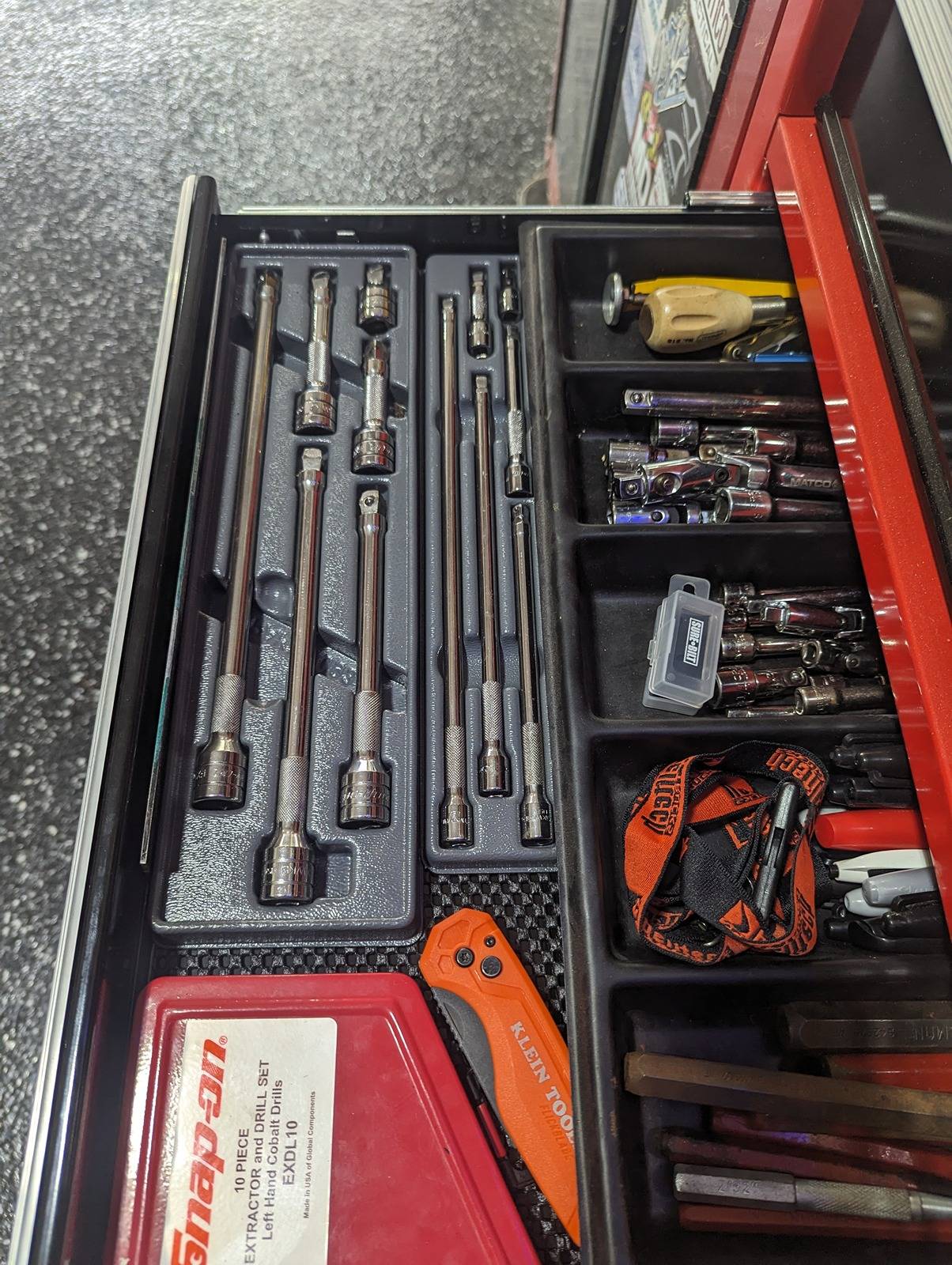

I've never owned "wobble extensions" - just flex sockets. I wonder if there's an advantage to those extensions vs. the flex sockets - which eventually loosen up and require an application of a wind of duct tape on them to keep them from flopping around........
Some of the best money I've spent on the tool truck outside of the turbo sockets
The guy who did mine used a wobble extension on the passenger back one, he said it's the only one you really got to use one on. I have no experience to say if it works better or not but YouTube guys I saw doing it used one in the same spot so I'm assuming there is a advantage.
That's the bolt you really need it for. Any place where you can't get on the head straight is a use for a wobble extension. I use the crap out of mine.
Without a hinged extension, you can’t get to that one.
