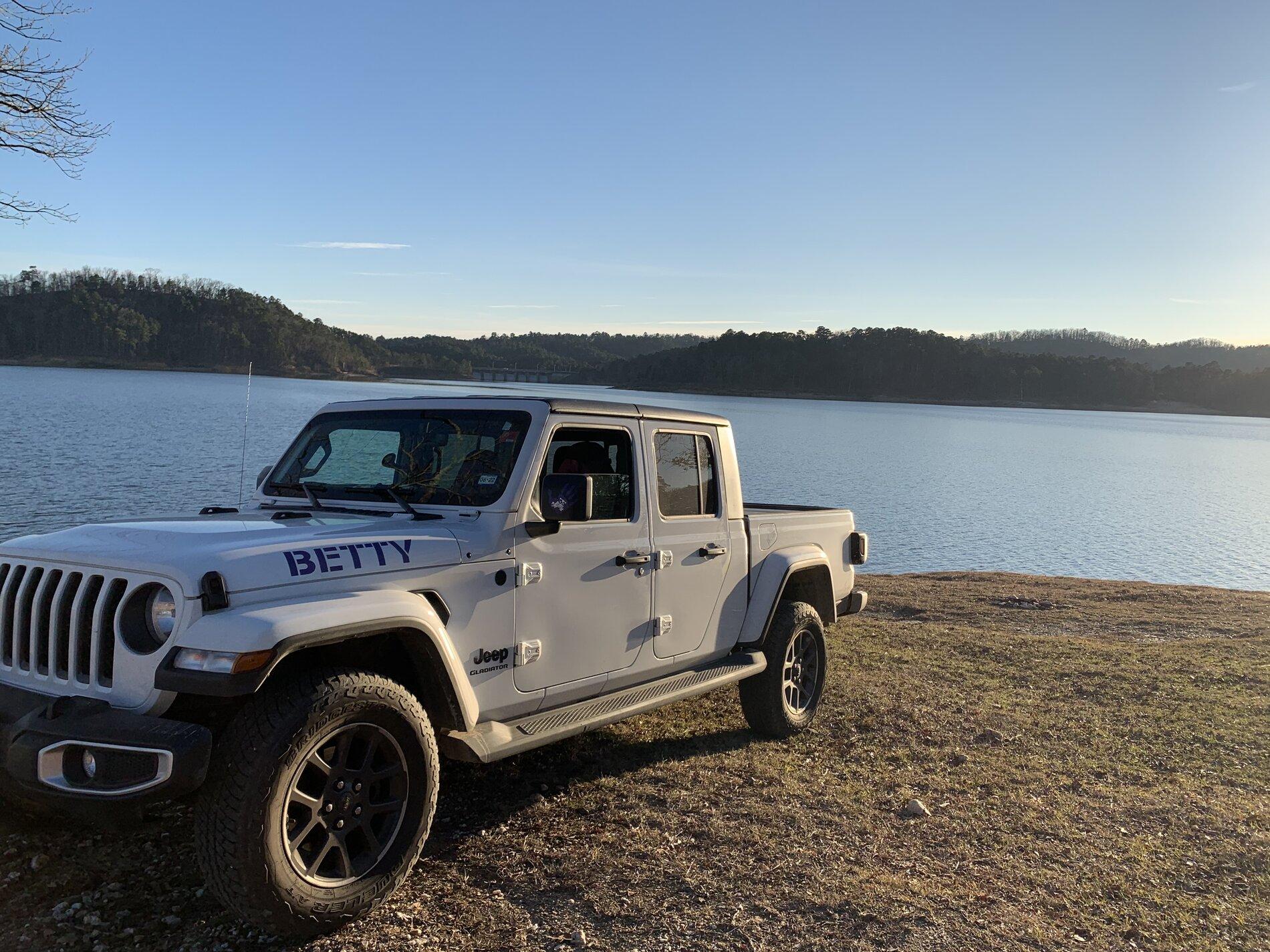

I have a sport s altitude package don’t think I have max tow and I believe 3.73 gear ratio. I love the look of the 35” tire but I’m concerned with performance. It’s gonna be mostly highway and roads on mostly flat terrain of the Houston area may do some dirt road trails but nothing serious and the Jeep will likely see some sand on the beach. Can I expect a Huge drop in performance and mpg or minimal if any. I will be replacing the rims with an offset for back spacing and will be doing a 2.5” rough country lift. I’m not worried about the speed odometer that’s an easy fix. I’m hoping I wouldn’t have to regear with these tires or at least for the next 2 years if at all. Thanks for advice and can also answer questions I may not have thought to add
Jeep Gladiator 35” tires effect on performance 3D0FF281-4395-47AC-B7D4-6B8B0E1CB272

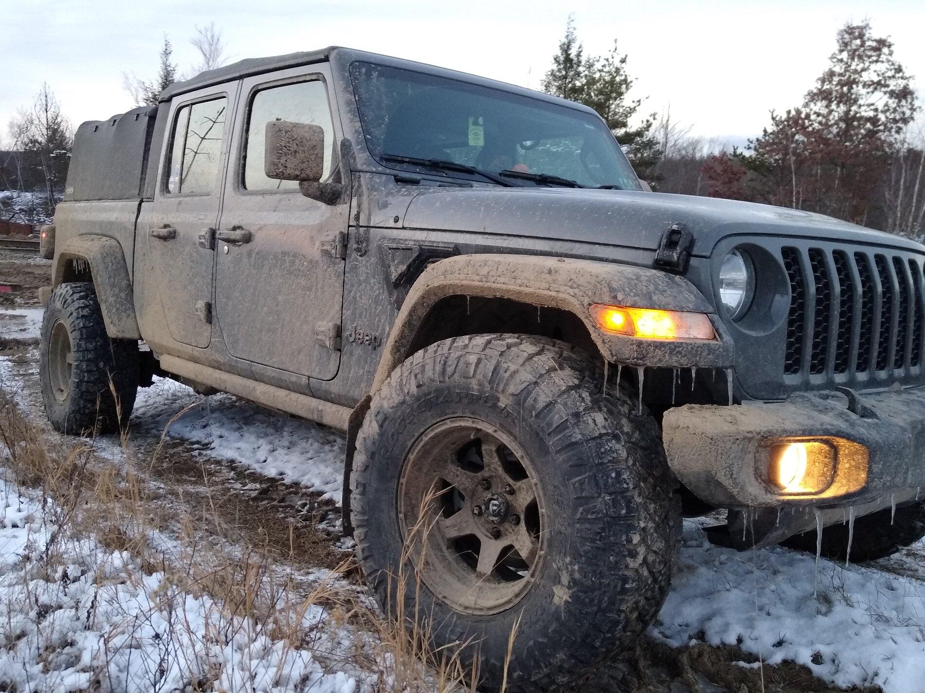

35 x 12.5 Nitro Ridge Grapplers on 17 x 10 Fuel Shok wheels. Not the lightest combination, from what I've read.
