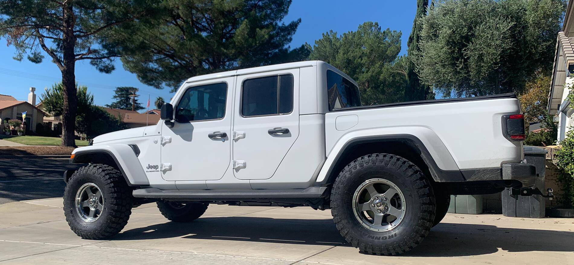

I ran 37s on a 2” spacer up front with no issues until I decided to lift it. You’ll be just fine. Went from 32” minivan tires straight to mud terrains. When those wore out I went to the Toyo Open Country RT Trail and I love it. Been through the snow all the way to Moab and never had any problems. My wife runs load C Patagonias, and my Toyos are load E I believe. We have the same shocks and hers actually feels a little stiffer than mine, but I think it’s because her lift has 5k miles and mine has 45k miles. I can’t tell any difference in tires.
2” spacer with 37s

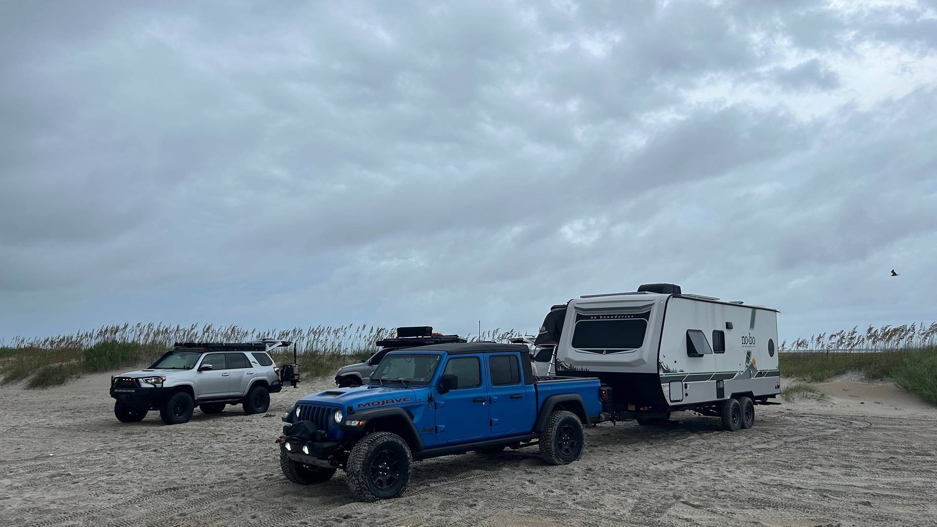

cheap C range bronco takeoffs. handles fine imo
Bro, if you are currently hooked up to your RV, I'm very impressed with the seemingly no or very little rear squat. If not currently hooked up, did you perform any sort of suspension upgrade to pull such a unit with the cushy, stock Fox's?
It has bags on the rear and it’s hooked up.
