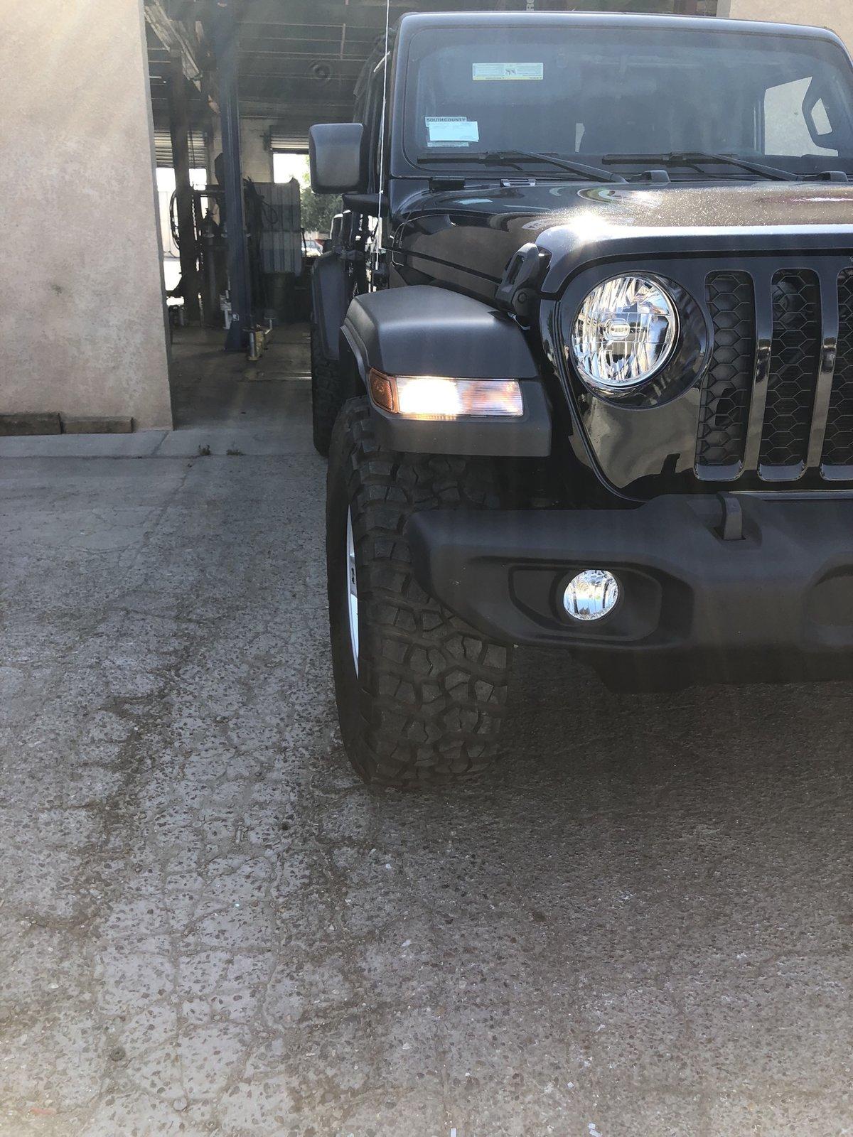

35x12.50 bfg MTs on stock wheels fit under sport max tow fenders completely and legally. These ride smooth and perform great.

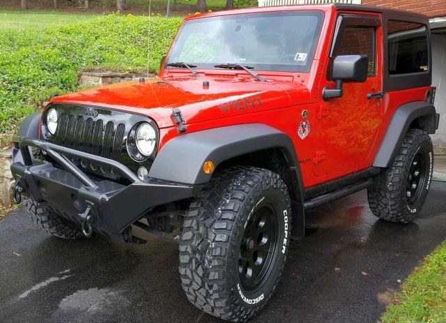

Having done the big tire thing on my previous Wranglers I think I'm going to stay stock or close to stock. I've been looking at 255/75R17 and the pizza cutter 255/80R17. But I prefer white letter tires so the only white letter in the 255/80R17 is the BFG KM2 and I don't really need a mud terrain but I could sipe the treads for better on-road traction. I have a tire groover and have siped tires in the past. My '14 JK had the stock BFG KM and the lugs had no grooves at all and I used the tire groover on all the bare lugs. Or I may go back to the Cooper STT Pro in the 255/75R17. I had the 295/70R18 Cooper STT Pro on my '14 JK Willys Wheeler. Or I could stick with the stock 245/75R17 and get the General Grabber ATX. Waiting for DTD to have another 15% sale.
