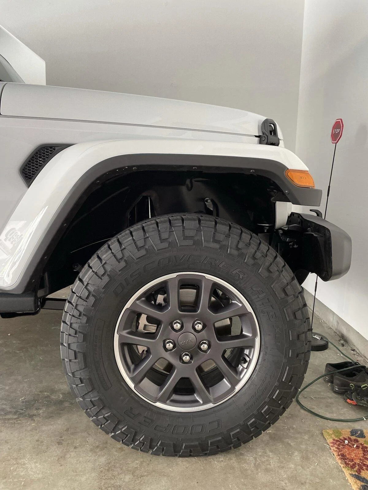

Hey everyone. Seems like a lot of folks have had similar questions (myself included) about running 34s who do not have a Rubi or Max Tow. I didn't see a thread already on this amd thought it might be fun and beneficial to see pics of everyone's 34s and what you all got going on? If this is redundant let me know and I can delete.

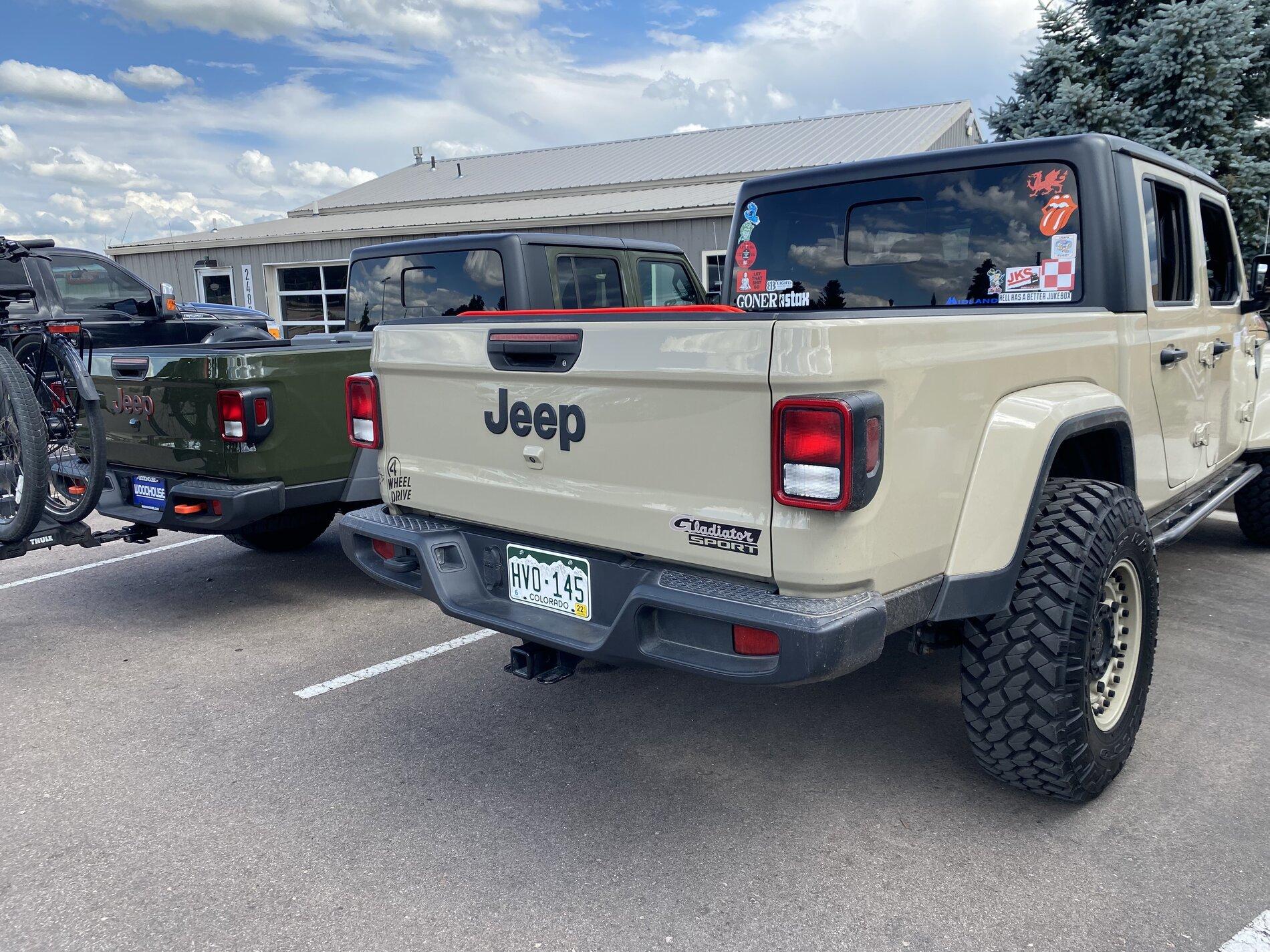

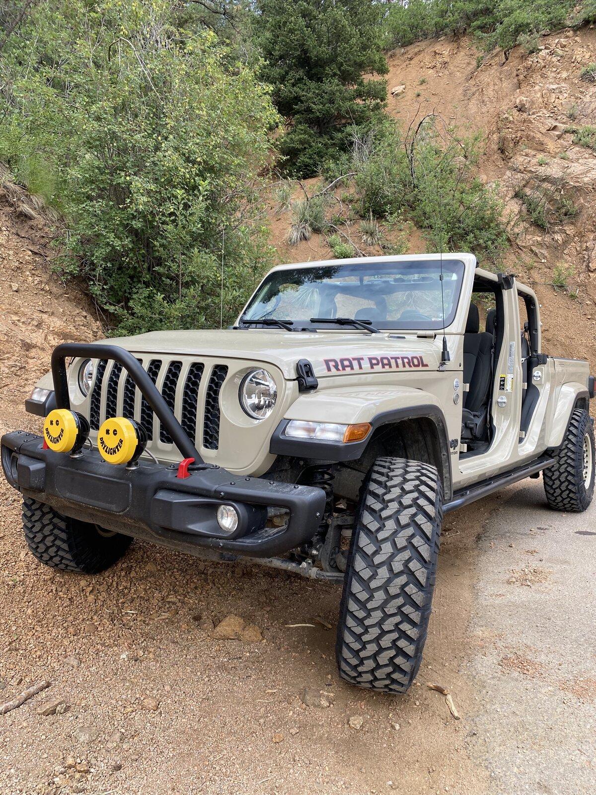

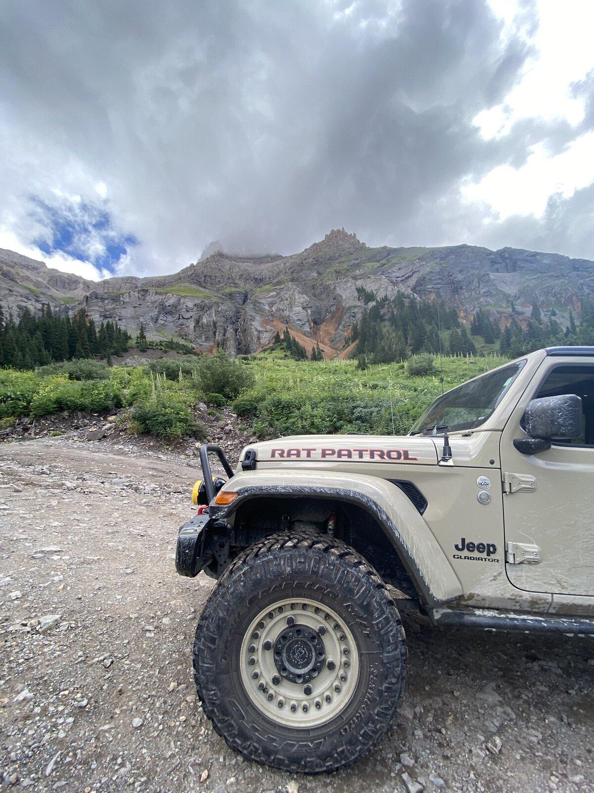

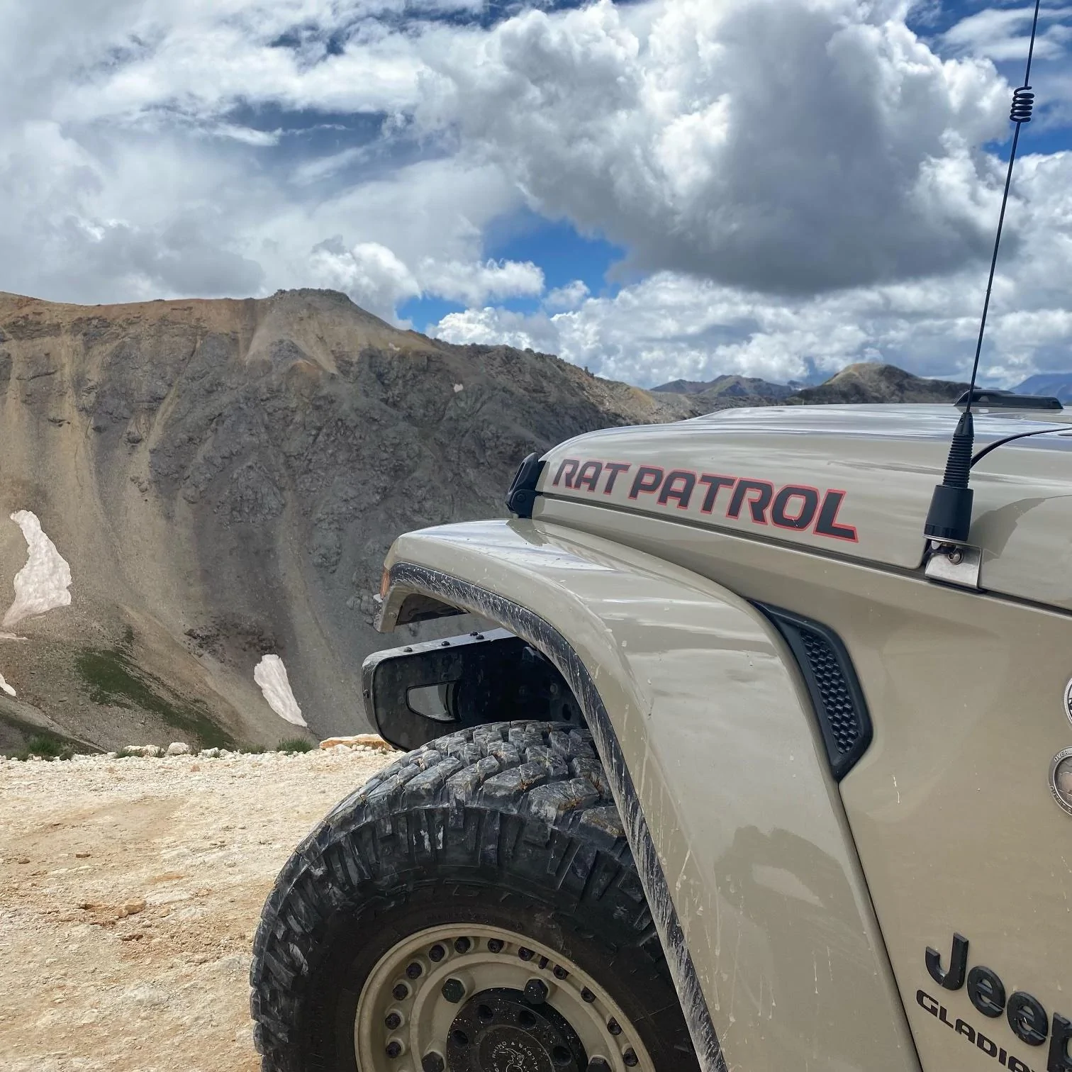

Lost of threads on this. You can do it. Many throw the rubi shocks and springs on. I got mine for $200. Give you about an inch of lift for better clearance. You may also want to remove the air dam between the bumper and fender if you have one.
Mine is a Sport S with 35s. -18 offset on the wheels. I eventually went with a Terraflex Spacer too as I was rubbing on fenders at flex.
Hope this helps.

Really like the wheels! Overall your Jeep looks great. I have a question re spacers. Will spacers cause any problems with the new car warranty?

Did you re-gear? If not, how does the 35's do with the 3.73 gearing?

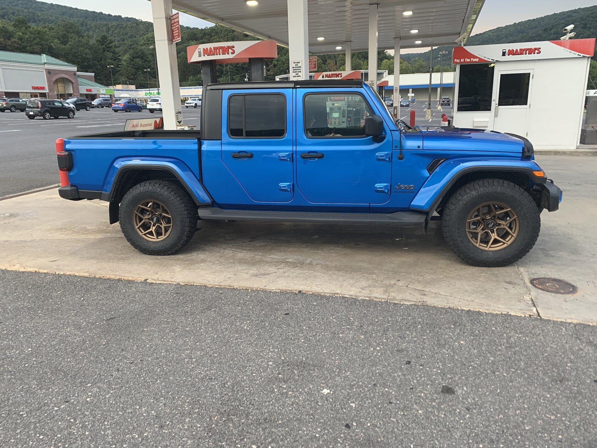

Here you. 295 70 18. 34.3.
33.5 when mounted on the vehicle
2 inch lift.

I would say depends on the dealer. Mine does not really seem to care or notice.

I did. But I live at about 6,100 feet above sea level. It was a dog for me up here in terms of acceleration. I went 4.88. Glad I did. I wheel decently enough and now I see 8th gear on the highway.
