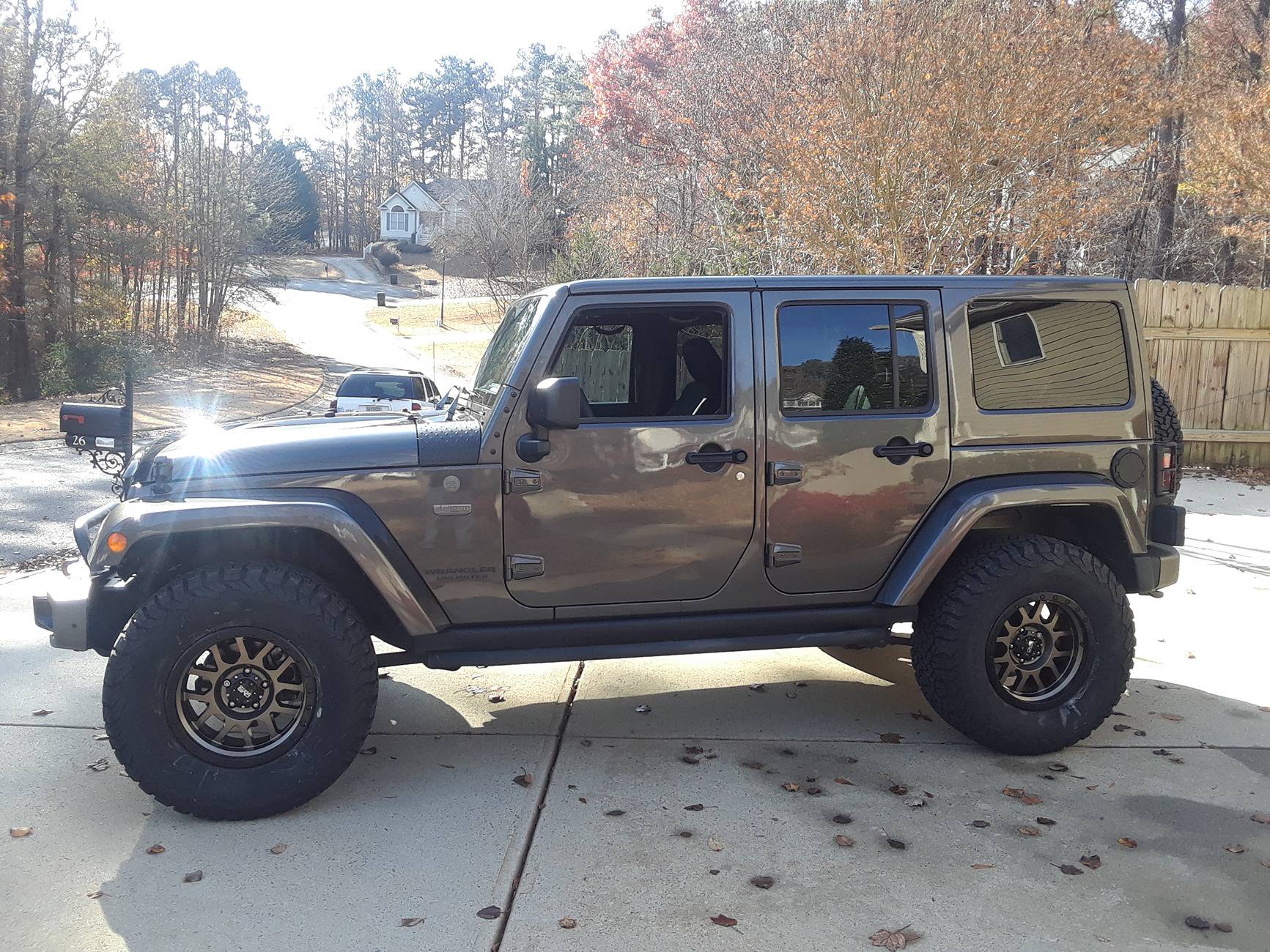

Looks great! What lift was that?
Thanks. I went simple with that one with just a TeraFlex 2" leveling kit. Loved that JKU, daily drove it for over 7 years total until it was traded for my current JT.

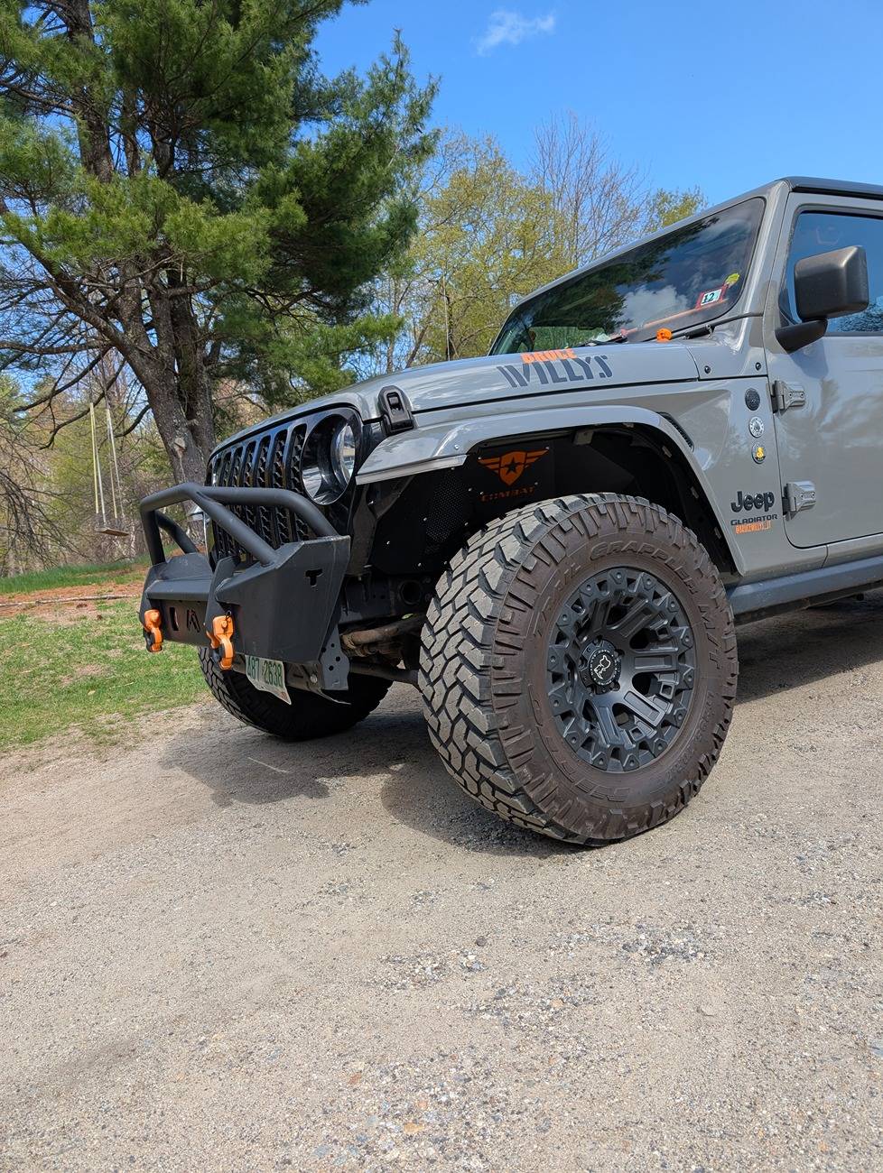

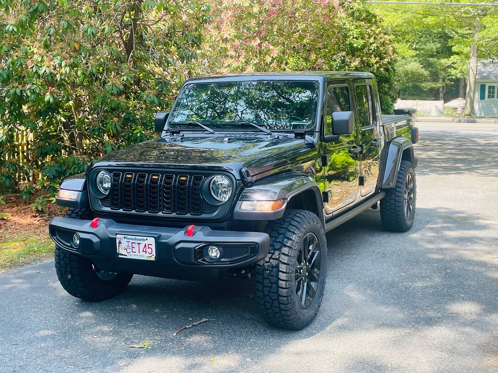

Hey all, I just bought a 2025 Gladiator Nighthawk. This is my 8th jeep, but first one in 14 years. In the past I owned CJs, YJs, and a TJ. They were never daily drivers except when I was a kid. Now it’s going to be my daily driver, I’m thinking 34s with a 1.5 terraflex kit. Any advice on this?
thanks in advance!!
Do it! I've run Nitto Trail grapplers for 3 summers and one winter. They're a great size.
Jeep Gladiator 34s PXL_20250502_195425967
