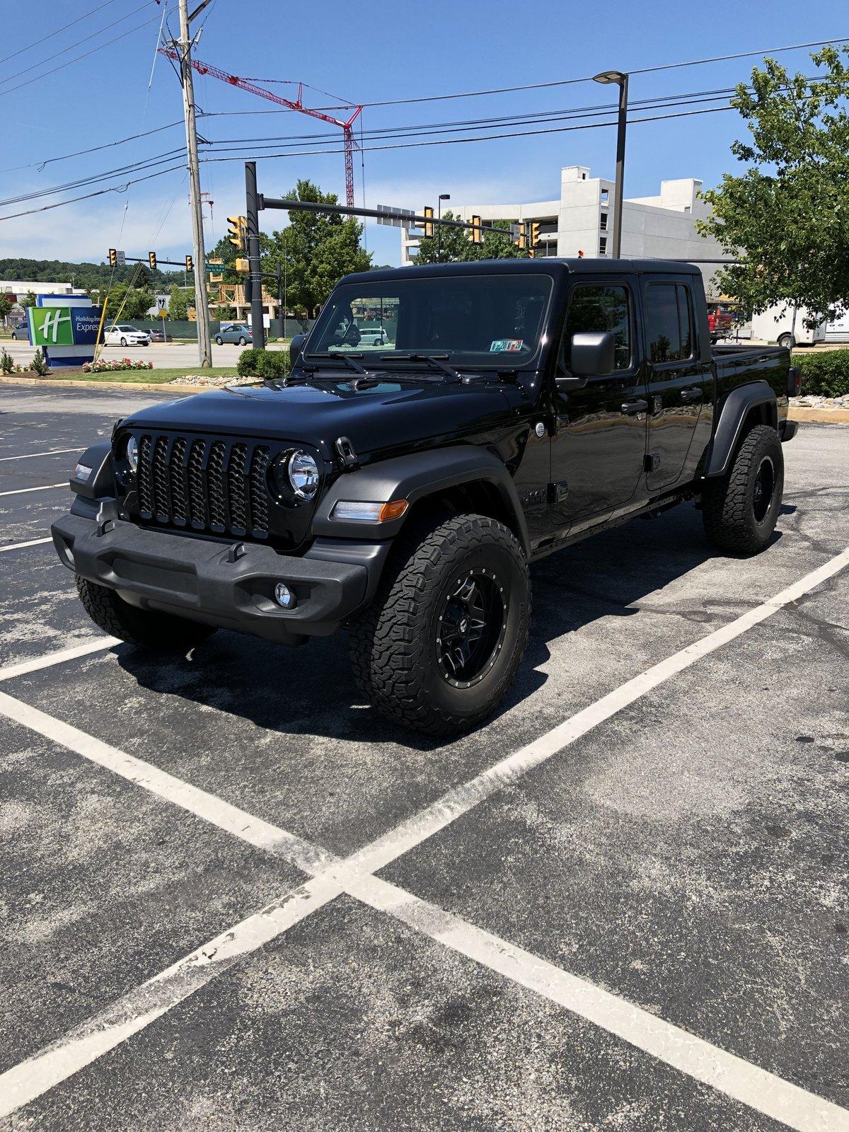

Jeep Gladiator Sport S

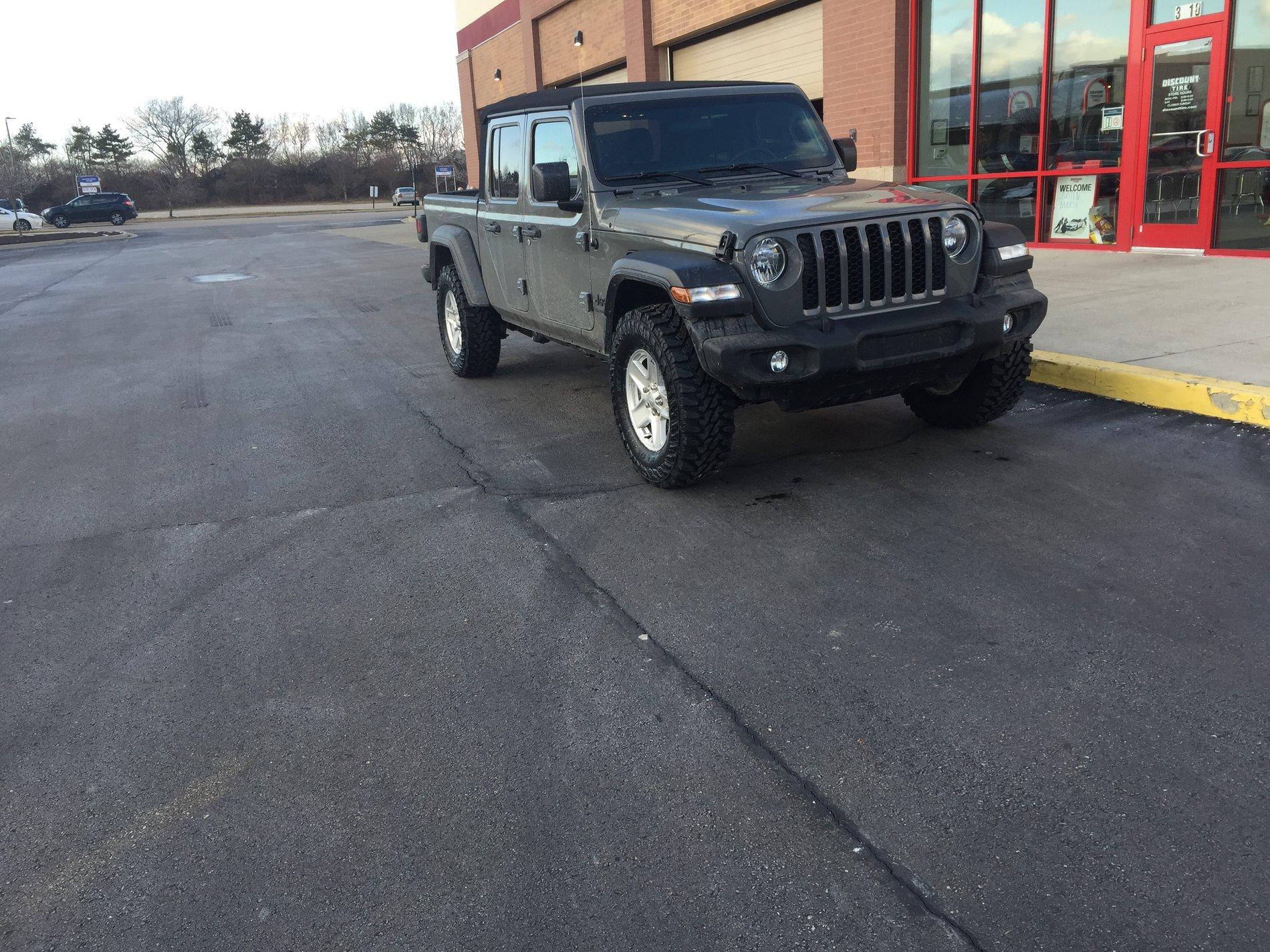

Front no lift yes
Closest I have with lift

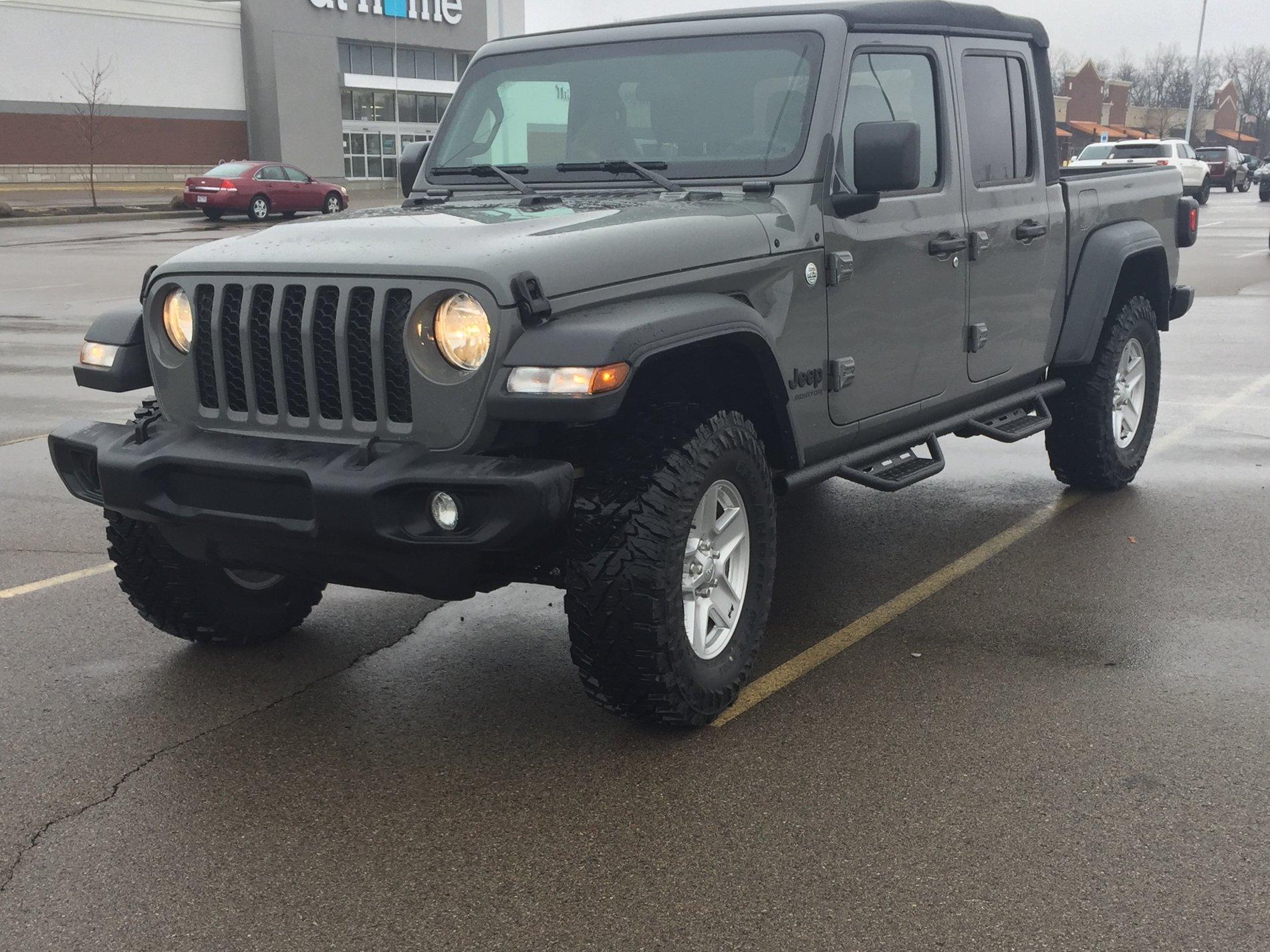

Looks good! I've been trying to find a wheel and tire combo that keeps the tires under the wheel wells like the factory wheels, but I may have to accept some tire sticking out or just keep the factory wheels.

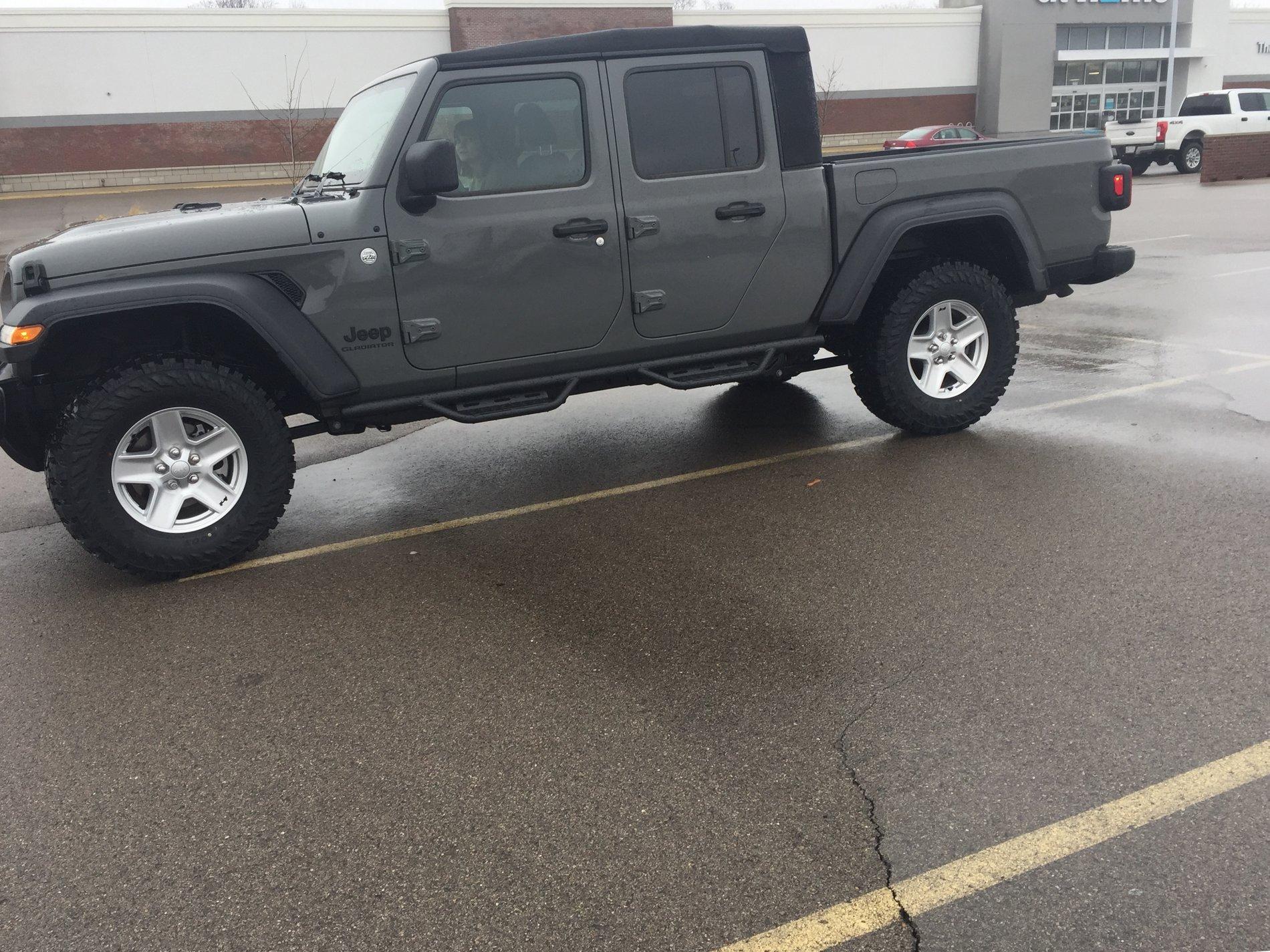

I kept the factory wheels to keep things tucked under the flares so the tires didn’t throw crap all over the sides. Besides I think that the wheels look better with bigger tires on them

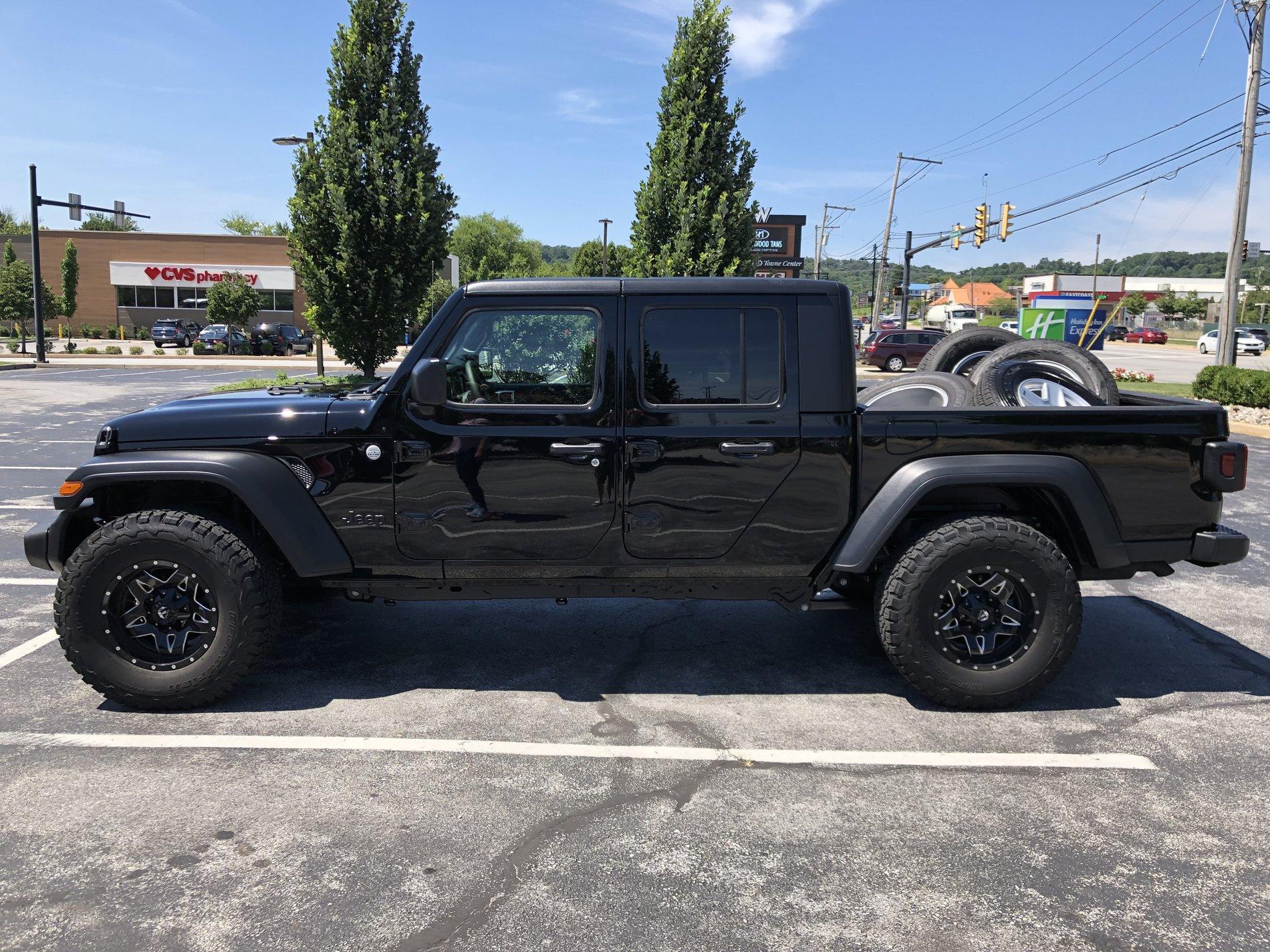

I run the 34’s. Stock and with JKS lift.

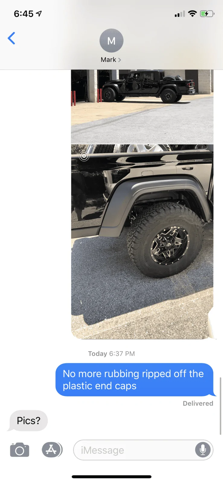

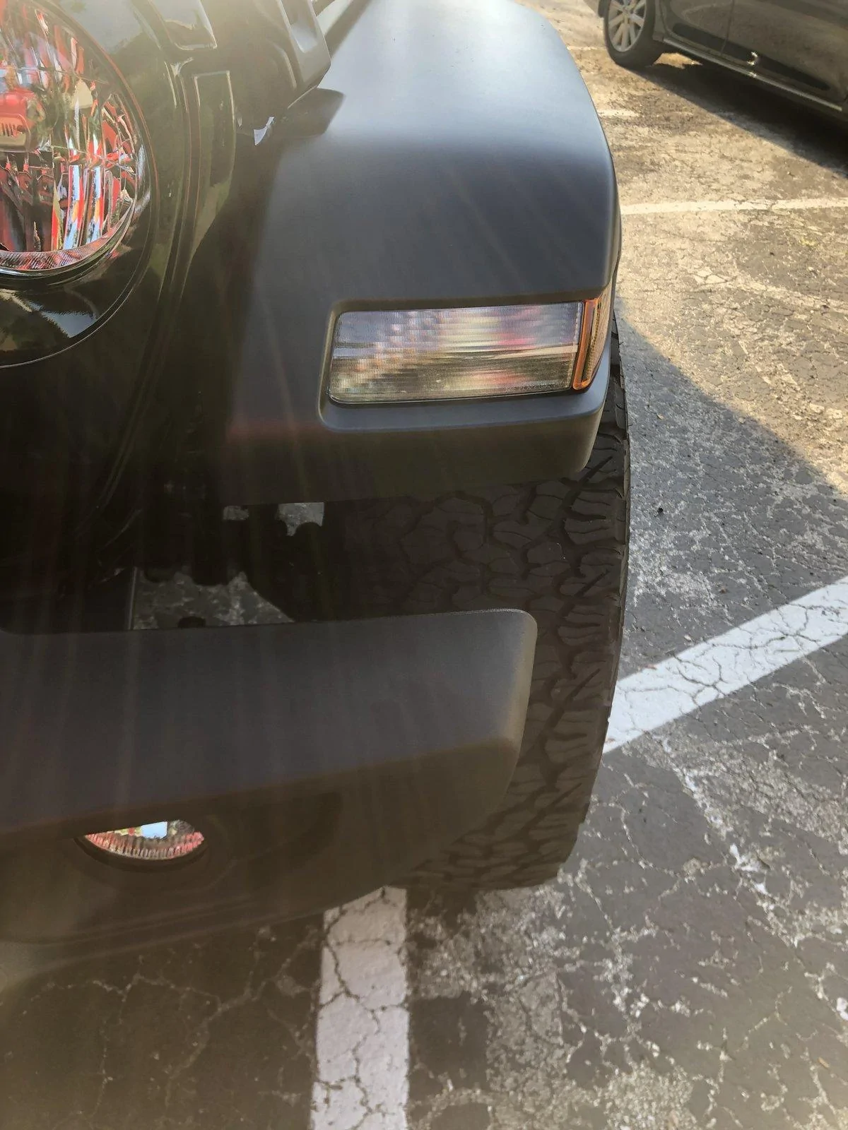

I just read your comment and ran out and ripped my plastic end caps off. Bumper looks so much better! Did you protect the back of the fog lights at all?

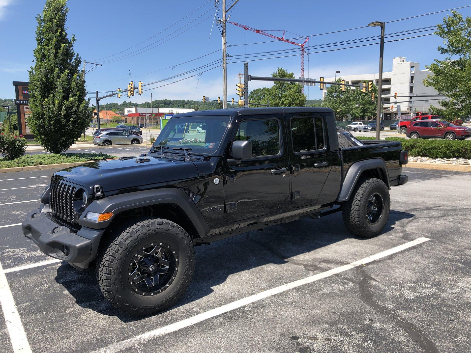

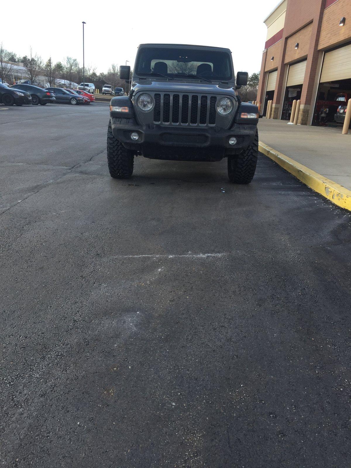

No lift stock ride running 315/70/17 with -12 offset and 4.5” backspacing no rubbing on sport S

Nah I didn’t do anything to protect them.
I trimmed the portion off that stuck out past the bumper using the bumper itself as a template. Then I bolted the covers back on. Weather permitting I will get pics tomorrow

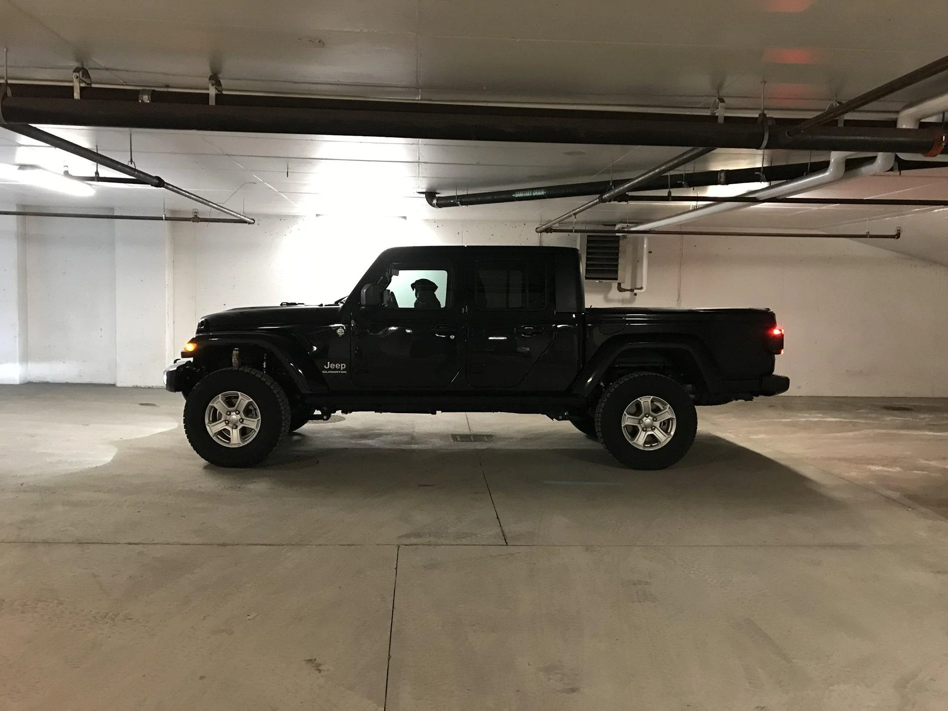

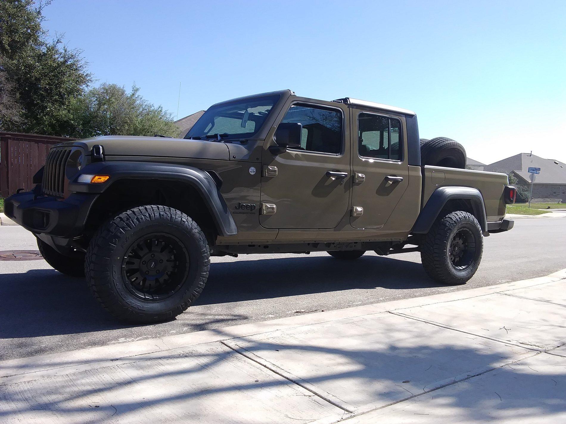

Here's what the 285/70r17 Nitto Ridge Grapplers look like on 17x9.5s with a 1.5" levelling lift up front.
