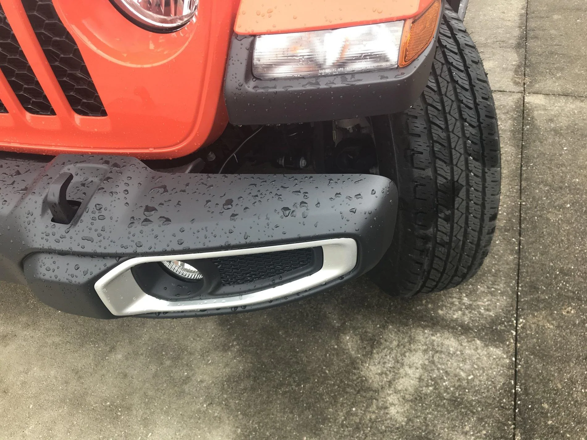

Looks like when I ordered my Sport S, it shipped with the overland front bumper instead of Sport s. Not sure why. But looks like I don't have to worry about trimming the air filler piece. Looks like i can go with up to 34 inch tires as stock then???

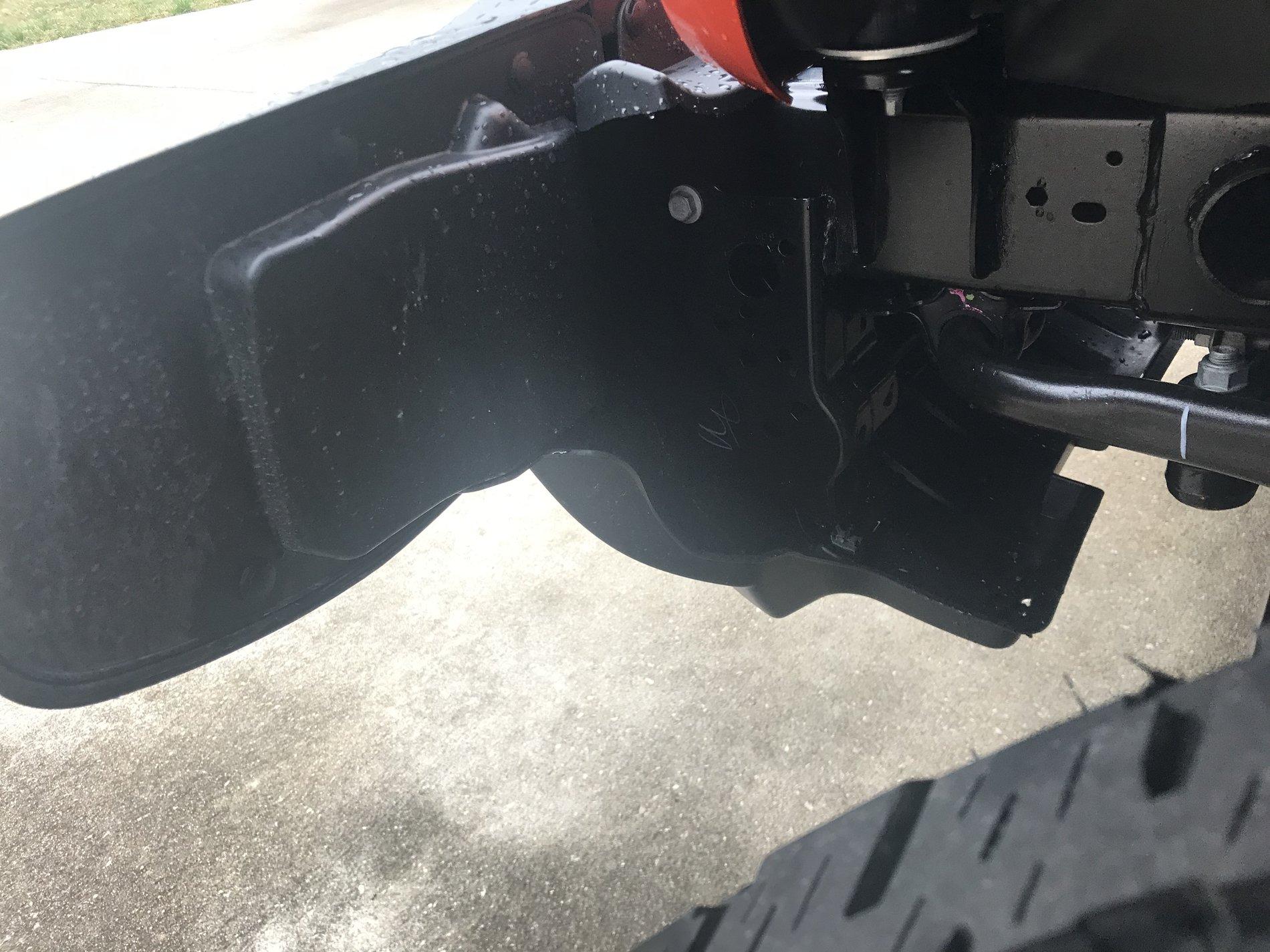

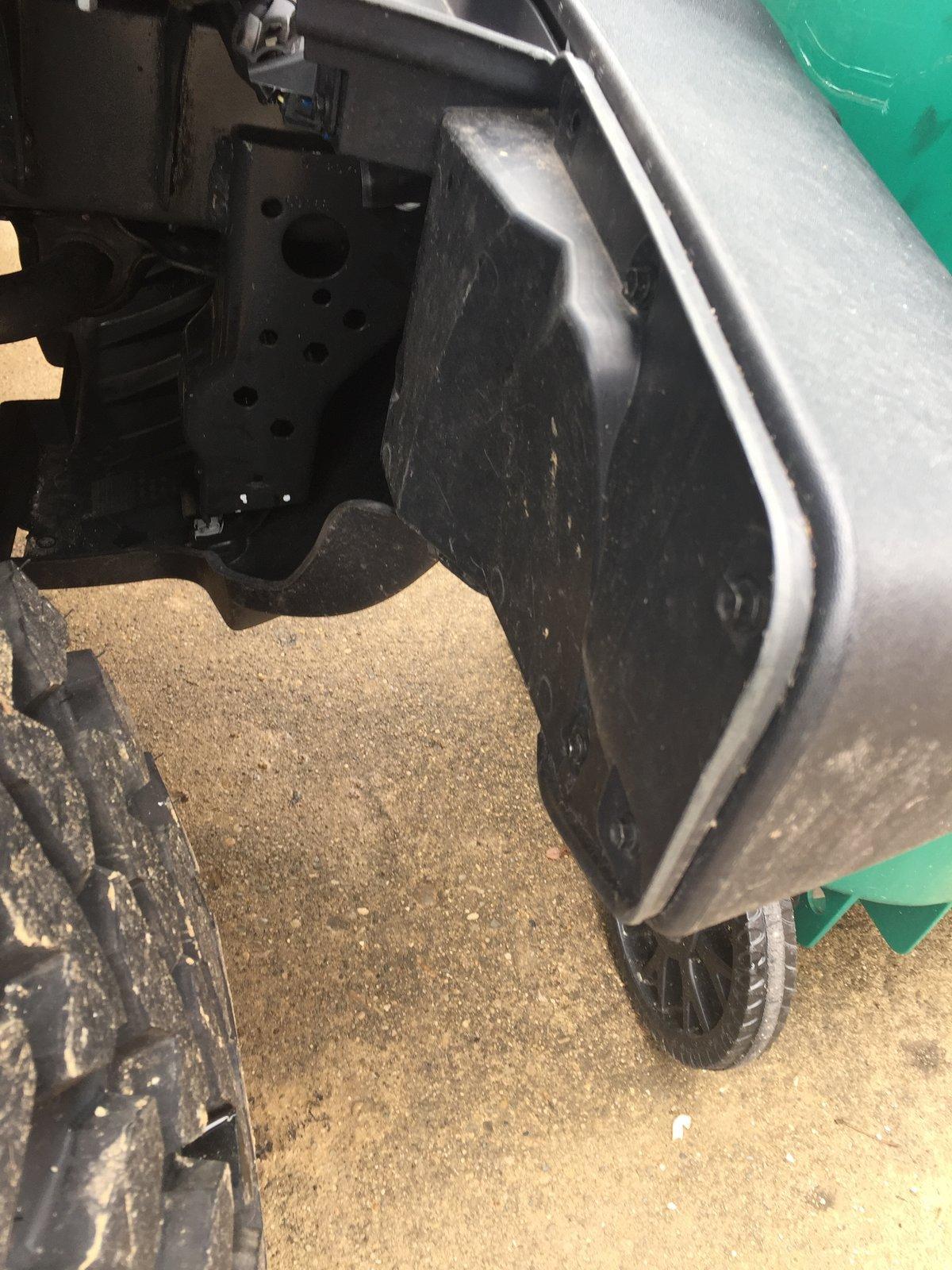

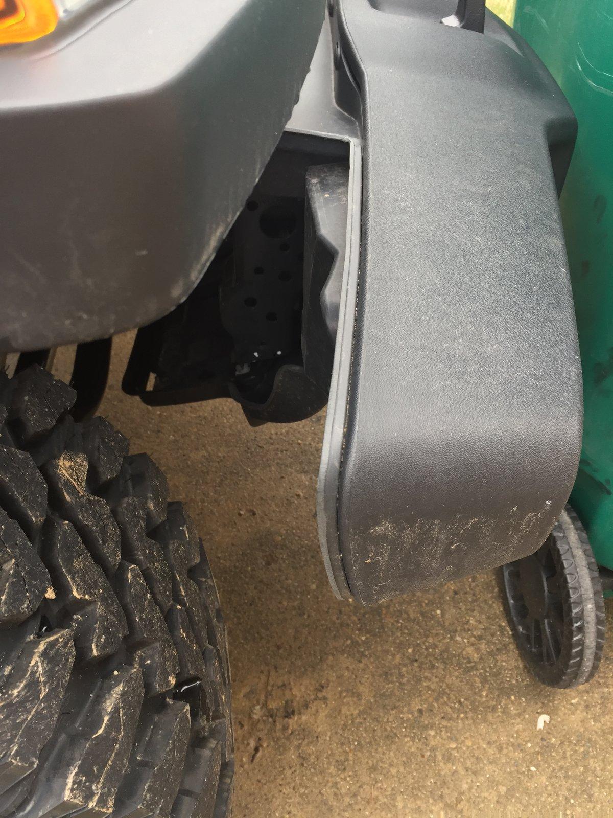

Here is how I trimmed the plastic using a small pneumatic angle grinder and finishing with some medium sand paper.
I just used a sharpie to trace the line of the bumper, popped them off, trimmed them, and bolted them back up.

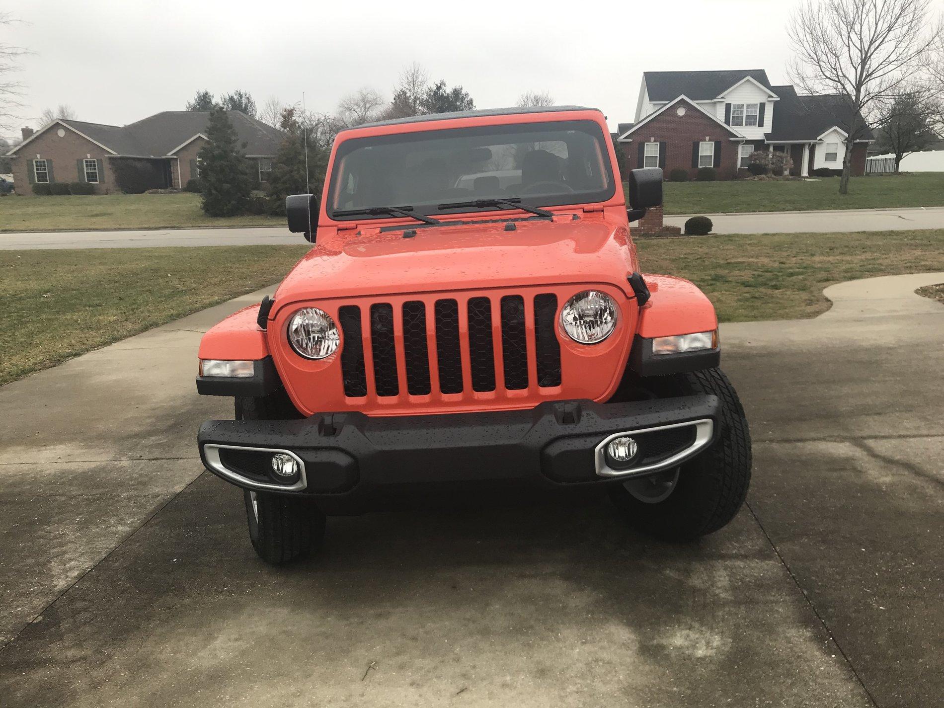

295/70r17 Patagonia MT Stock Sport s, Non-Max Tow, No Lift, Stock Rims It does come with a bumper for some reason that other sport s does not. I am assuming it was part of the side step add or the painted fender upcharge. Not sure. But, fits and looks perfect for my taste. Pics do not show as much of a difference that actually exists. Very happy with the look and ride/noise of these tires on the 60 mile ride home ( just got em today)

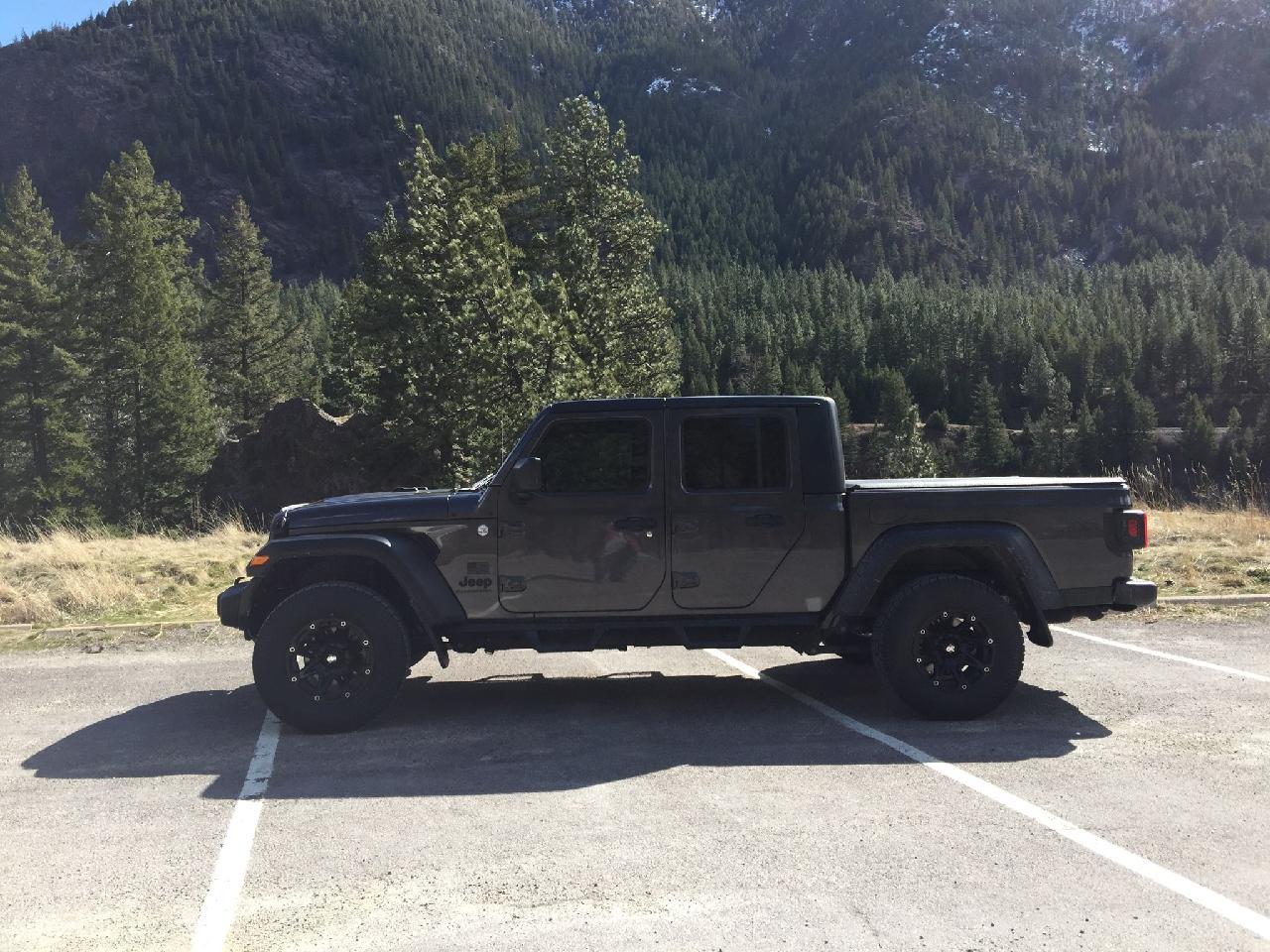

I leveled mine, 1.5", I didn't have to, but it gives me the option of going larger later on.
