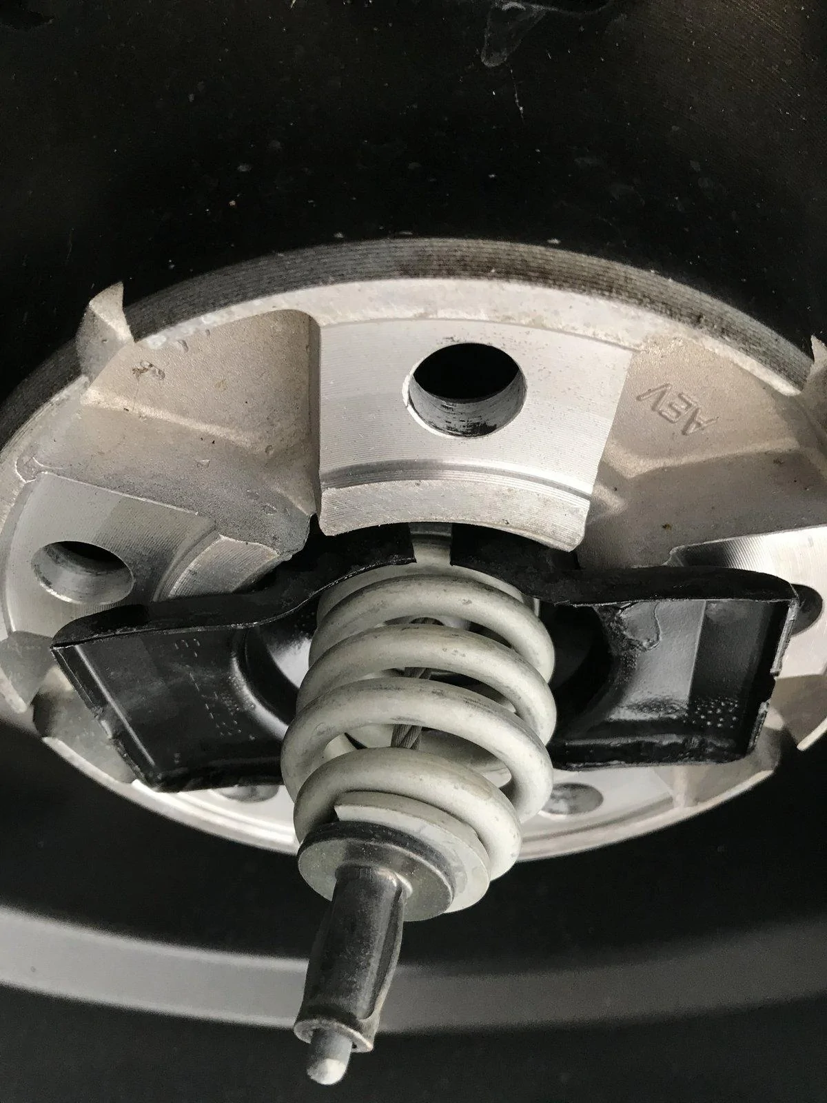

Has anybody mounted a 35 on a factory akuminum wheel and put it under there? I havent tried yet but the center bore for the factory aluminim wheel looks too small to fit the piece with cable to fit through..........

Hey i had the same issue with AEV wheel the center bore was too small so with someone’s advice on here i cut a slot in the wheel keeper so i could slide it off the cable, then put the plate on the other side of the wheel & it worked great.

Yeah my metal plate wouldn’t fit through the smaller AEV hole

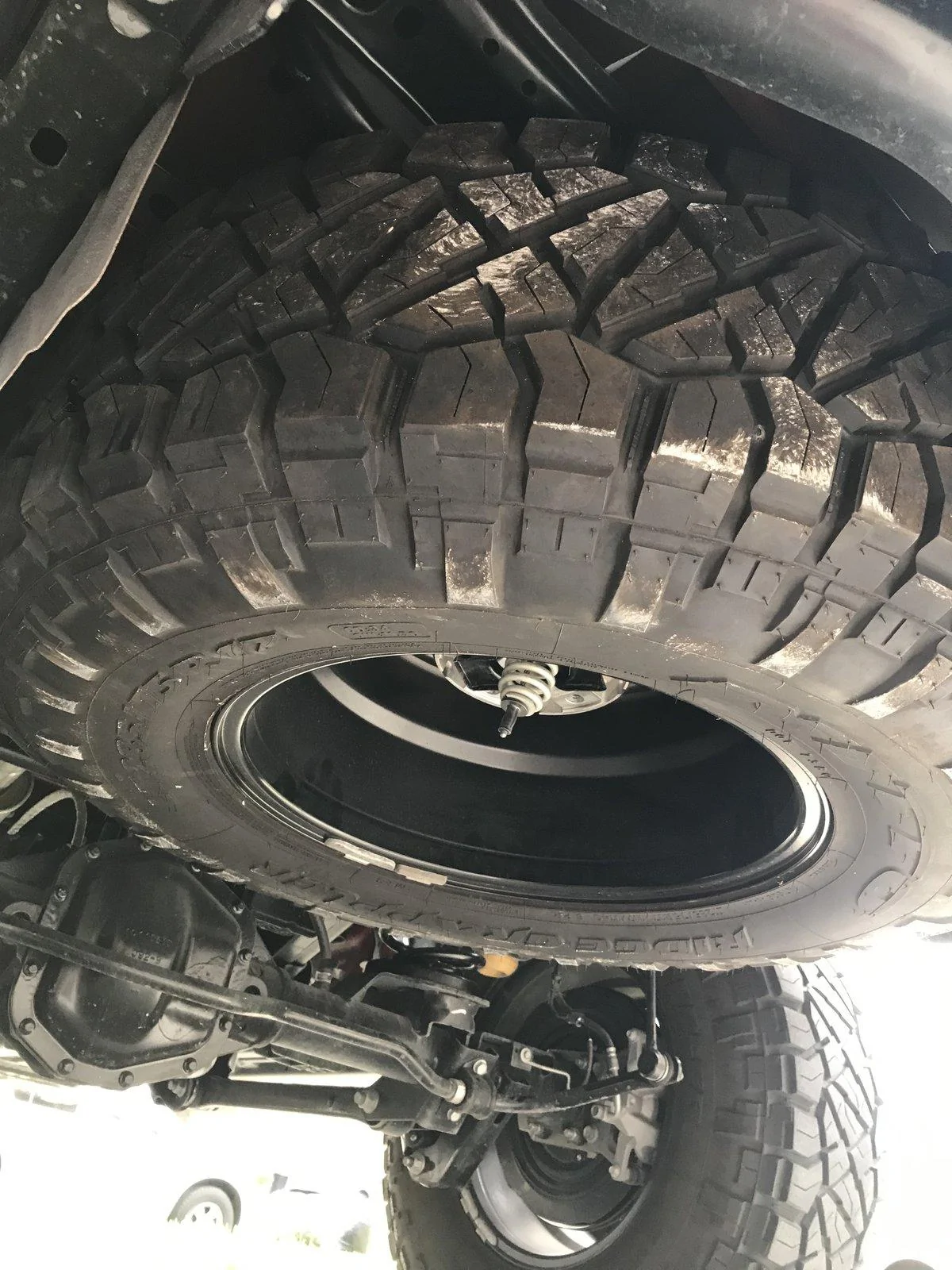

Jeep Gladiator 35" spare tire issue 20200330_153514

Yes I have a 35 12 1/2 x 17 NATO Terra grappler on a 17 x 9 fuel wheel went up underneath there with no problem just hangs down real low kind of ruins your rear Clarence a little bit
