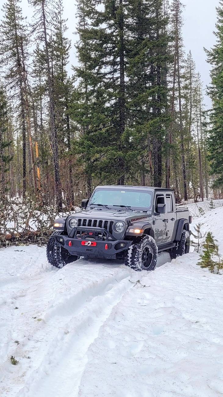

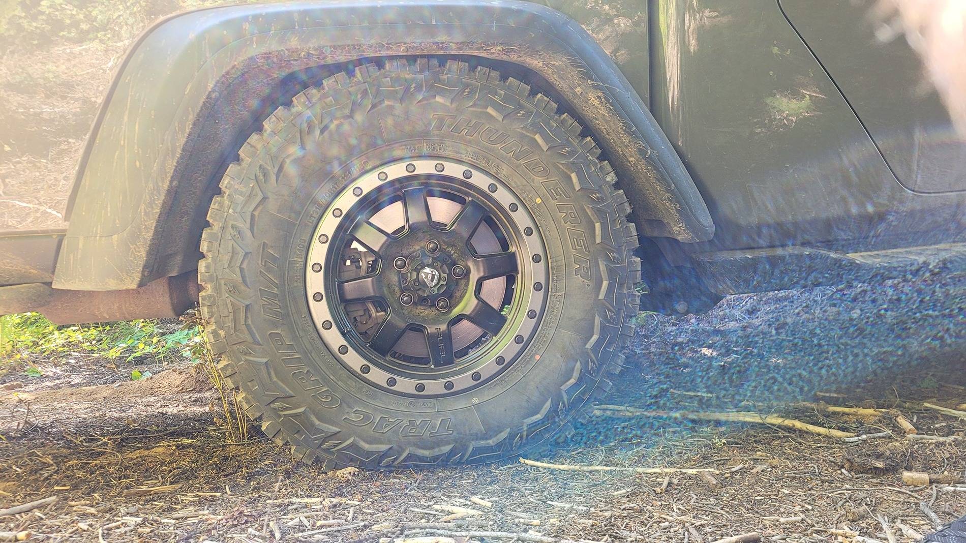

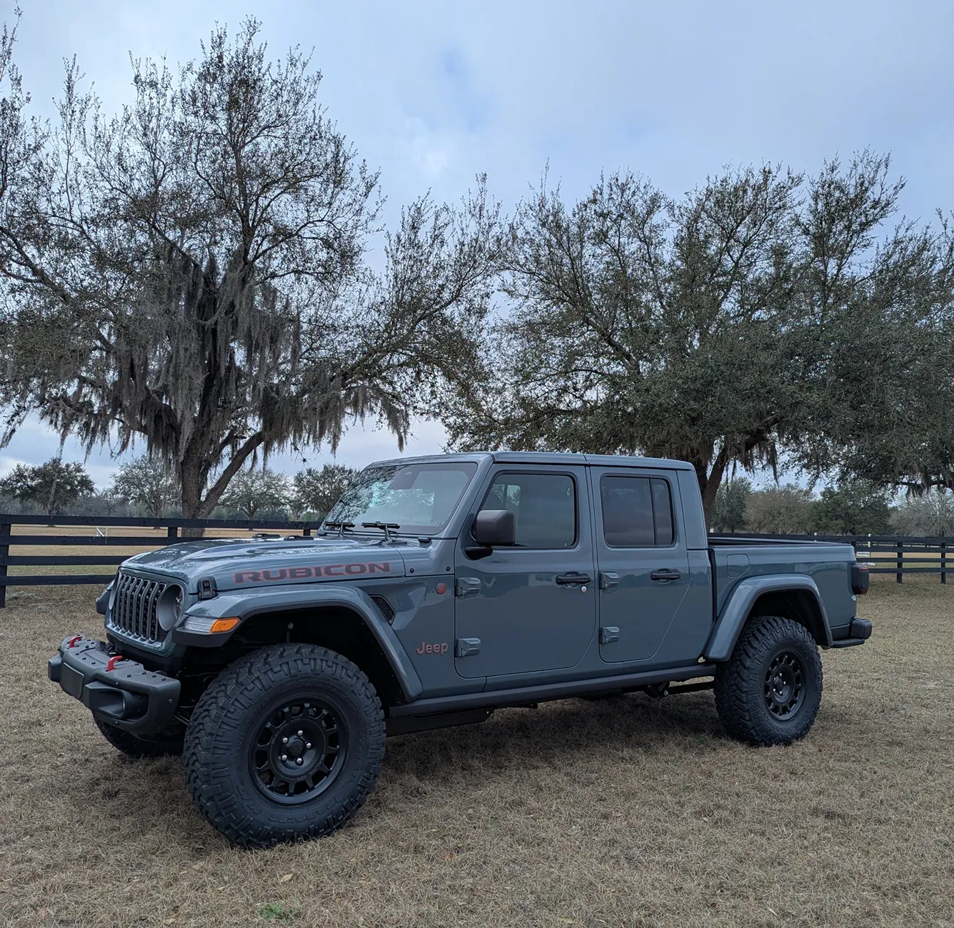

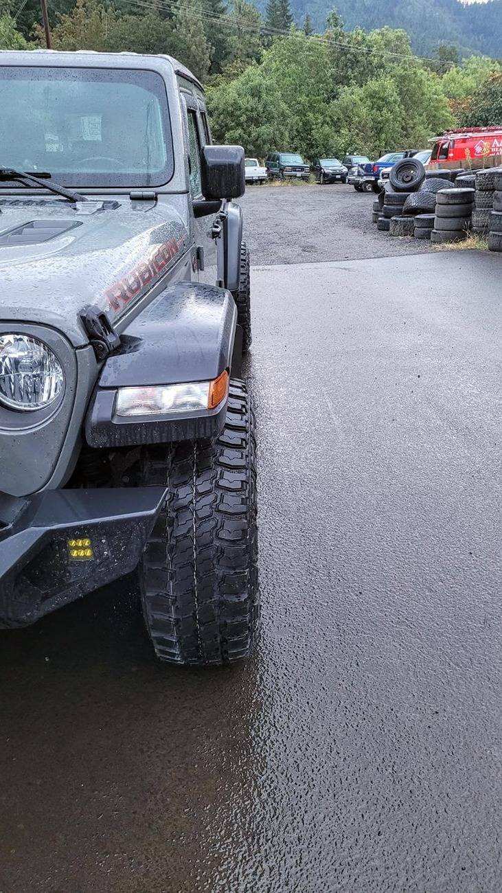

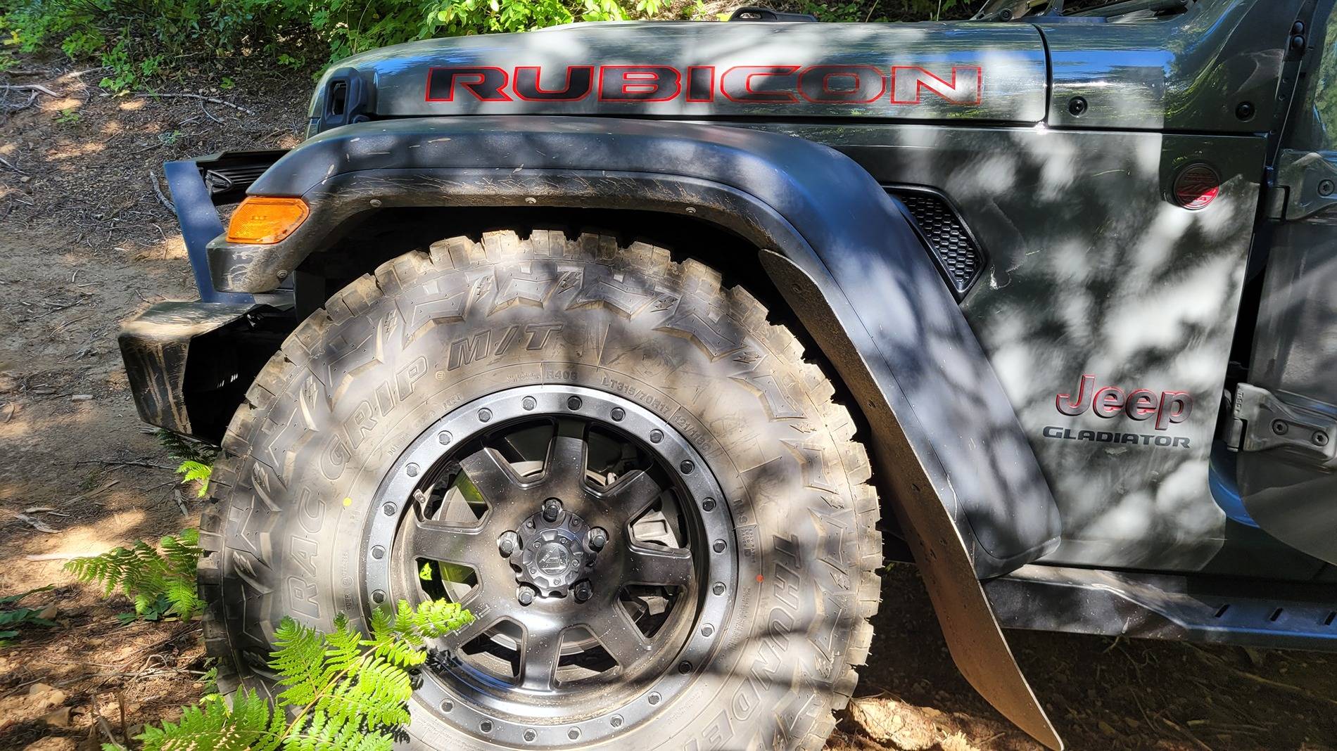

2022 JTRD, 315/70r17, Fuel D551 Trophy wheels 17x8.5 +6 offset, 5.0" backspacing, 3/4" spacer lift to offset the metal bumper and winch. No rub so far.
Jeep Gladiator 35s and No Lift Thread 1742146812759-dz
Jeep Gladiator 35s and No Lift Thread IMG_1534~2
Jeep Gladiator 35s and No Lift Thread image
Front full stuff...
Jeep Gladiator 35s and No Lift Thread 20240830_122941
Rear full stuff...

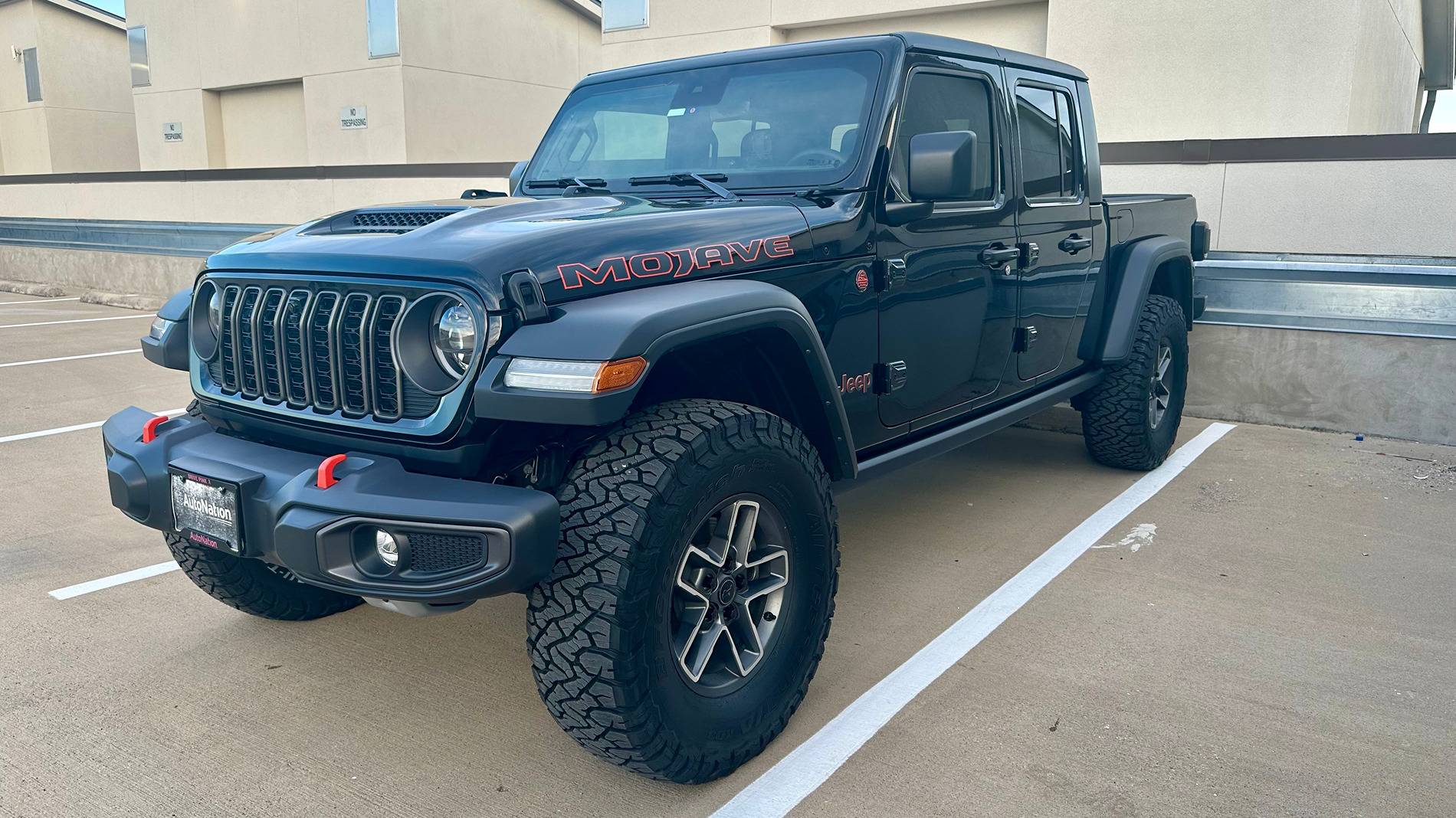

My hometown @Discount Tire set me up with a new set of BFG KO3's in 315/70-R17 this evening. Definitely helps fill up the wheel well. Greatly improved tire over the KO2!
