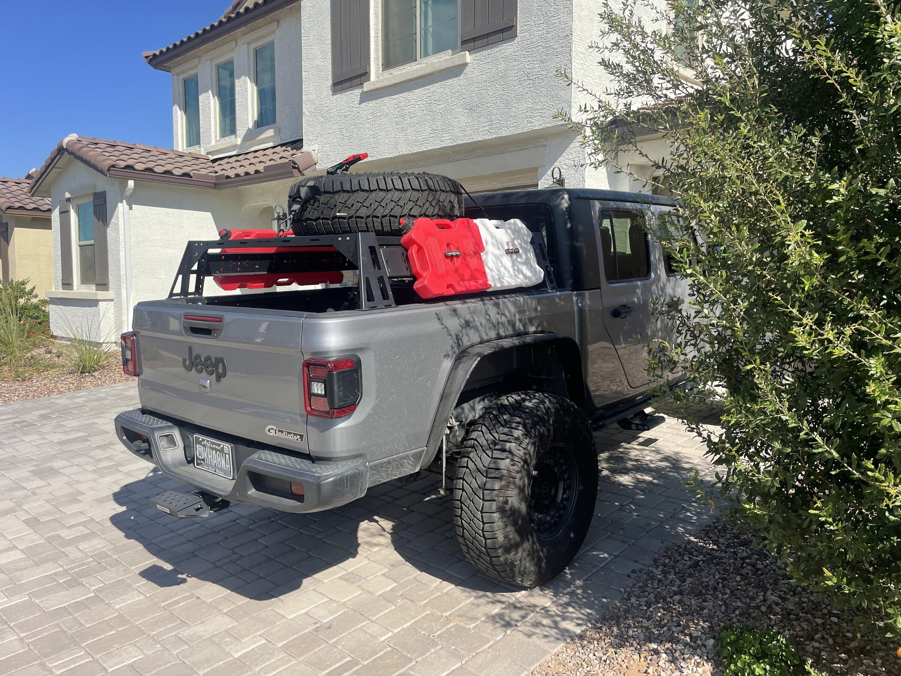

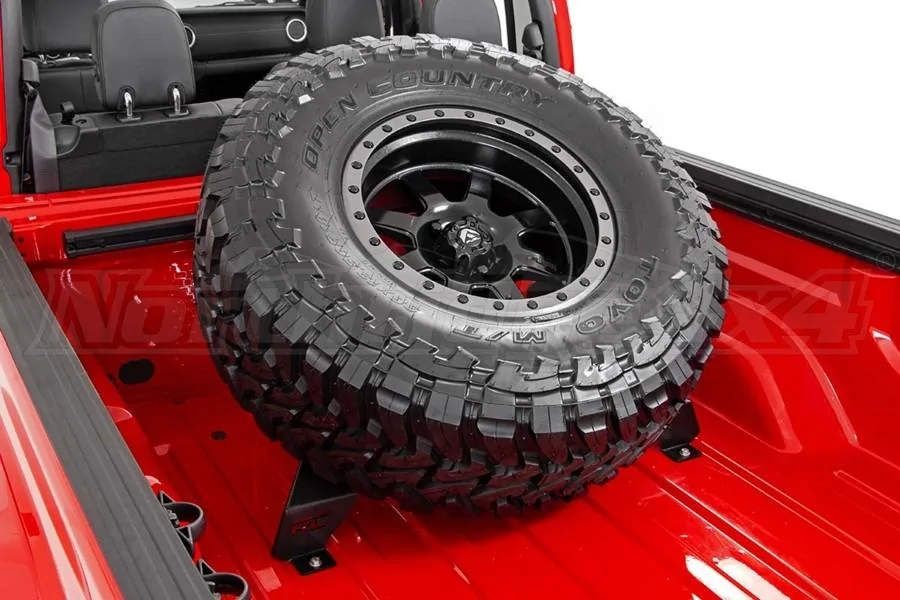

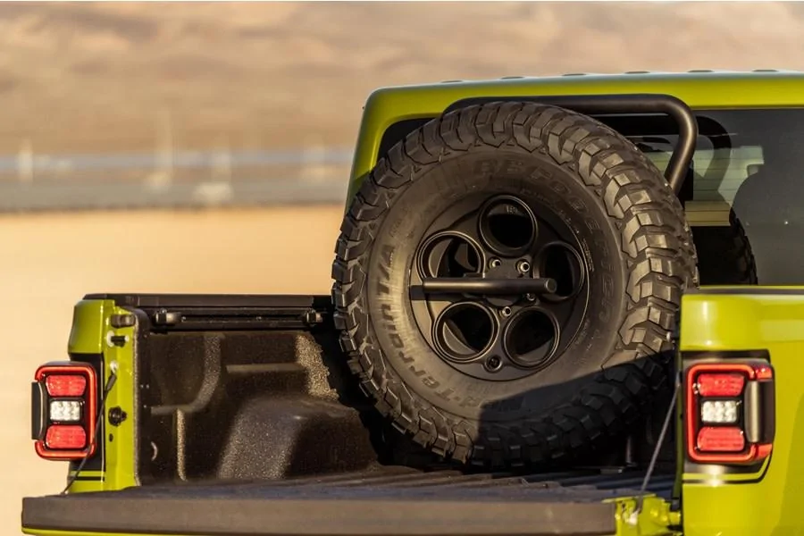

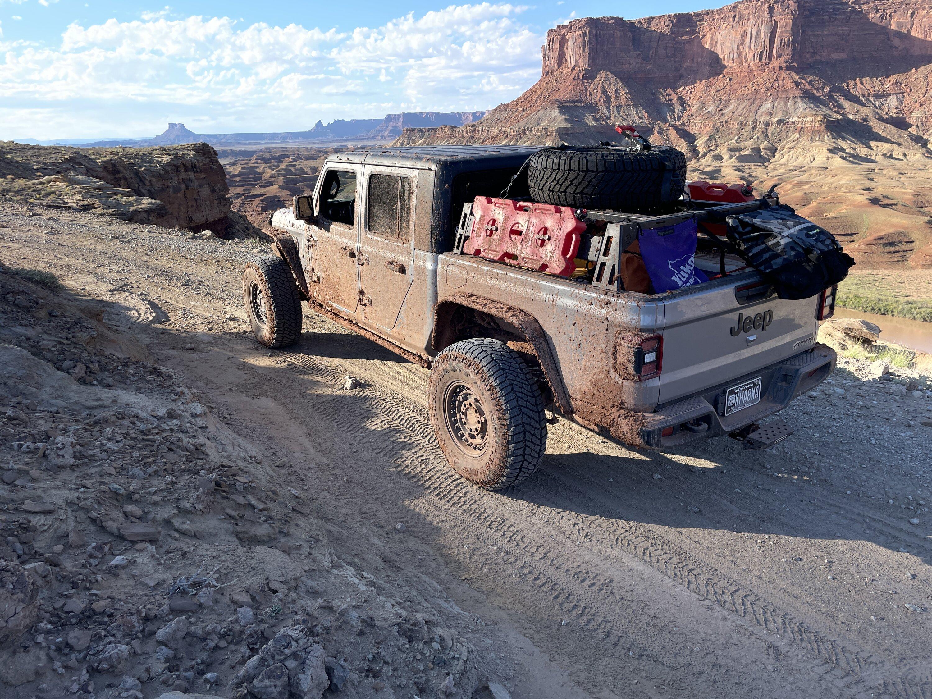

You're not annoying anyone, I'm just trying to ask specifics to help your search. As far as advise, the factory location is ideal for weight distribution and leaving the bed open for other fun activities.
To answer your question though... a 37" MT Baja Boss M/T 100% fits. Please refer to the spare tire thread = https://www.jeepgladiatorforum.com/forum/threads/37”-spare-tire-list-of-tires-that-fit-under-the-bed.24091/page-18#post-873042
another example:
my spare MT Deegan 38 fits too:
Hope this helps and now you know that any possible mounting location works and you can decide on what suits your fancy :)
