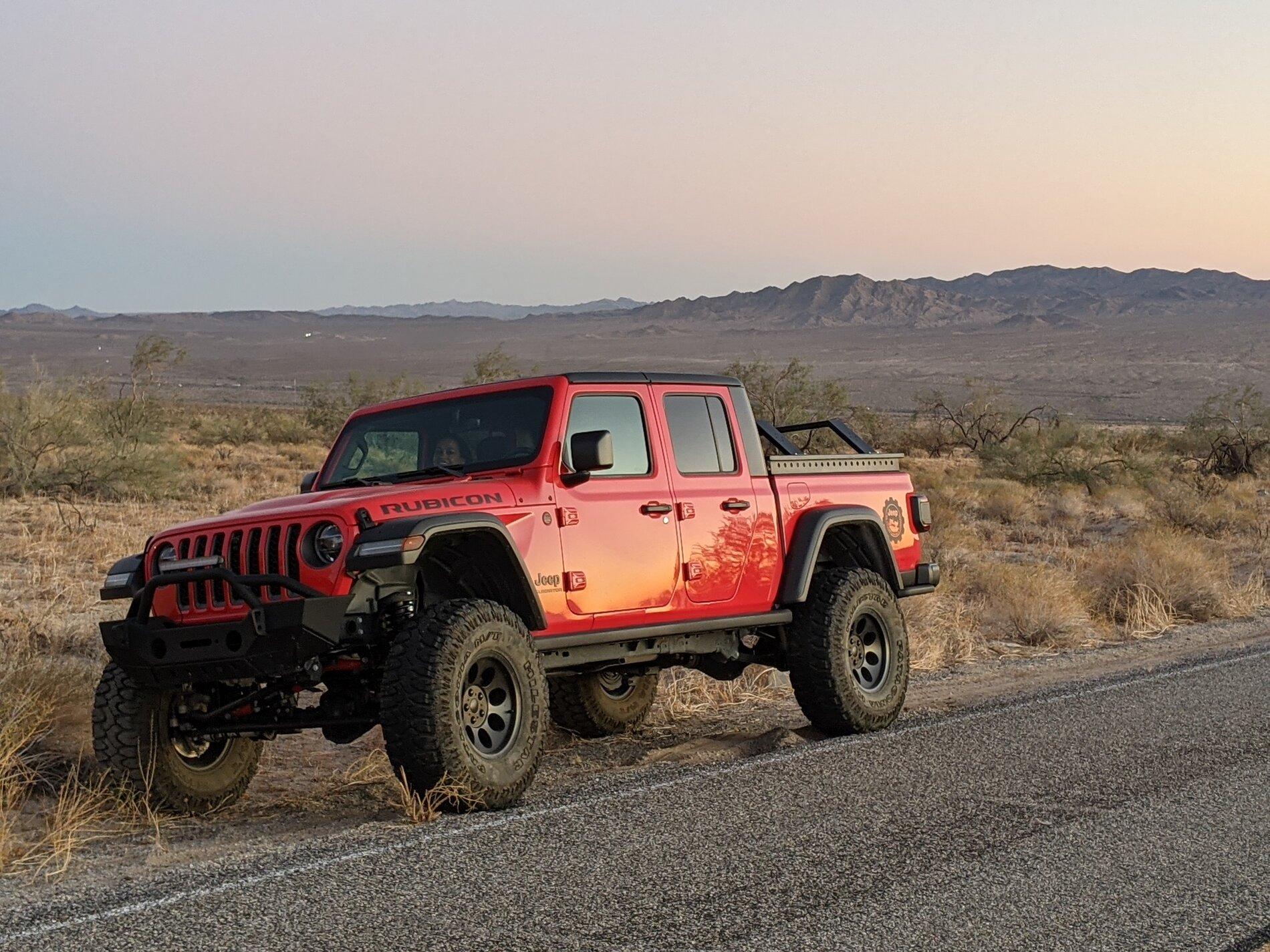

I started with 38" Patagonias on a 4.5" EVO lift and the only upgrade that might come eventually will be 39" BFG or 38" Falken MTs for better potential in desert and mountain trails. I'm running Steer Smarts track bar and I have the Steer Smarts Drag Link and tie rod )with aluminum tie rod to install along with a front Adams driveshaft.
I drive 70 miles roundtrip to my work and of any downtime, I have my 2003 TJ Rubicon as a backup.
I don't see any reason to downsize to a 35" tire, although I have run my OEM AT3Ws when I had a trail run to make and a bad valve stem that needed to get changed out. My wife complains about the step in height of the truck, and I plan to get some rocker protection that doubles as a step.
