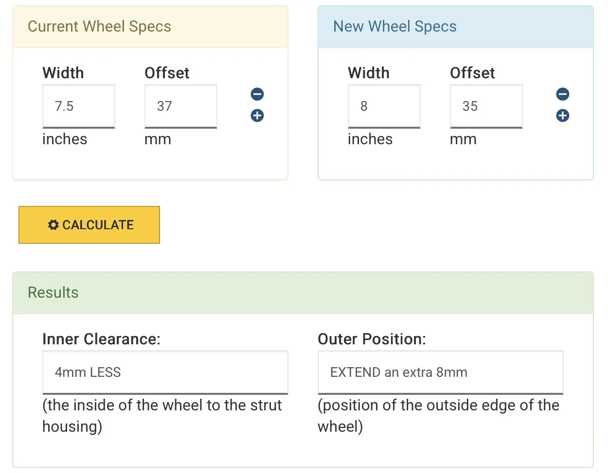

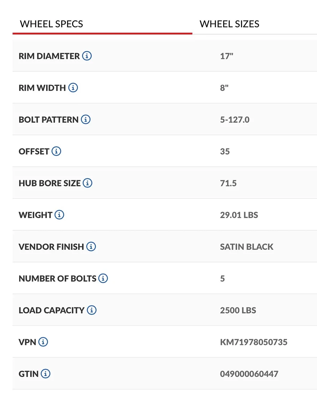

After looking though a LOT of options, I found some wheels I really like; KMC KM719 Canyon. 17" diameter; 8" width, offset of 35; backspace 5.88. Running this through one of the calculators I come up with this result. I would not this this would be a problem, but really would like an expert opinon.

Wheel specs look right to me:

Might be tight on the inside. (that's what she said)
Appreciate your thoughts (and humor)! But do you really think 4mm closer inside could be a problem? Again, i'm not an expert, but looks like a lot of room in there.

Method 316 is a nice alternative for me, with 25mm offset; yielding 6mm more inner clearance and 18mm more poke . . .

Hi again: Another way to ask the question--what do you think is a reasonable amount closer (Inner Clearance) that would be safe to run? Less 0mm, 5mm, 10mm?
I am keeping the stock 33" tire size.

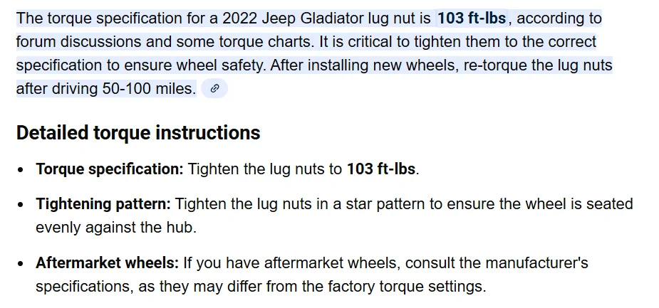

Manual says 130
Odd, a sheet I got from the forum here says 120
But I looked in Lunentucker's torque spec images and those do say 130.
This is why you should be very careful with things looked up on the internet - I had to laugh as I was looking for where it said 120 here (I've got it printed in my shop, but doesn't matter since 130 is the correct factory spec - I was just curious why I initially printed out what I found on the forum)
Check out this AI response -
Jeep Gladiator Changing wheels, a couple rookie questions . . . 1763090649438-43
