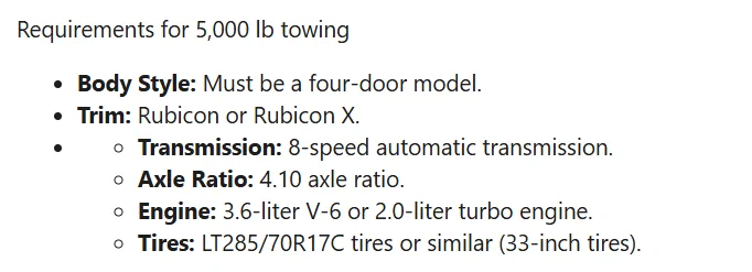

Requirements for 5,000 lb towing
  • Body Style: Must be a four-door model.
  • Trim: Rubicon or Rubicon X.
    • Transmission: 8-speed automatic transmission.
    • Axle Ratio: 4.10 axle ratio.
    • Engine: 3.6-liter V-6 or 2.0-liter turbo engine.
    • Tires: LT285/70R17C tires or similar (33-inch tires).
Seriously, pure logic and it's been covered back about 4 dozen pages ago or so.
To get HP, you burn fuel. To get more HP, you burn more fuel.
Burning fuel creates heat of combustion. Some of that, not nearly what people think, is converted to mechanical energy - the rest is rejected - out the exhaust and through the cooling system and a tiny amount via the air surrounding the engine (miniscule, so no, opening vents doesn't really do much)
The HP jump between the engine sizes is large - so is the extra heat put out. So, how are you going to remove it?
They struggled just to get the 3.6 to pass muster - packed all they cool for a cooling system under the hood. Engineers and design team went back and forth - pretty much restraining what the people working on keeping it cool could do.
2024 they changed the grill style - hmmm, did that coincide with the bump from 3,500 to 5,000 pounds towing for the JLU. Well, isn't that interesting............ they made other changes and wanted to bump up the tow rating (different rear axles, for example) but ran into cooling problems. So out comes a new grill design.
It's a puzzle that makes sense if you consider all of the pieces on the table.
So if the 3.6 (when properly equipped) is rated for 5,000 pounds after the new grill and different rear axles (started with 2024 model year) - why not the beloved hemi?

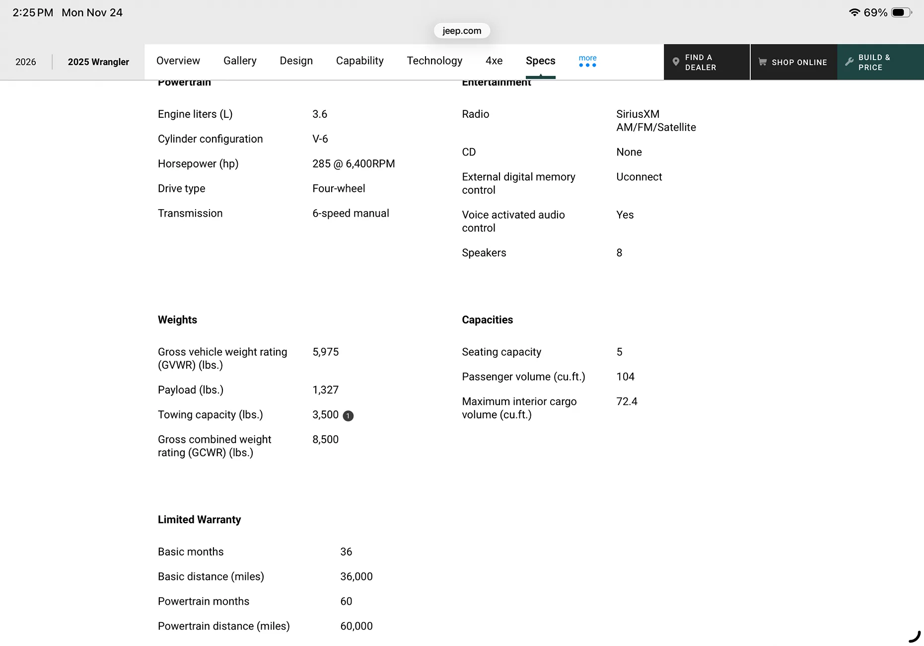

the rubicon to rubicon is a better comparison and the towing capacity of the Wrangler is 3500#’s
Bill please answer my post #773 if you can…
If you click the little #1 it mentions that 3,500 lbs is the base configuration.
that's OLD and incorrect. They always show the BASE. You have to click into it to get the better info.
I posted the specs from Jeep - and it clearly states 5,000 and the dealer even told my wife last week - "hey, the one you are looking at can even tow 5,000 pounds now".

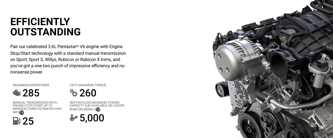

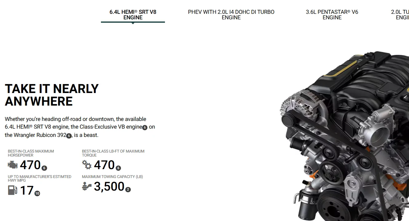

Below is the Rubicon to Rubicon comparison changing ONLY the engine.
So, here it is AGAIN, proving it's 5,000 for the 3.6 and 3,500 for the hemi -
First I chose the Rubicon with the 3.6 and I get this -
FIVE THOUSAND for the 3.6 but choose the HEMI and you drop 1500 pound towing capacity -

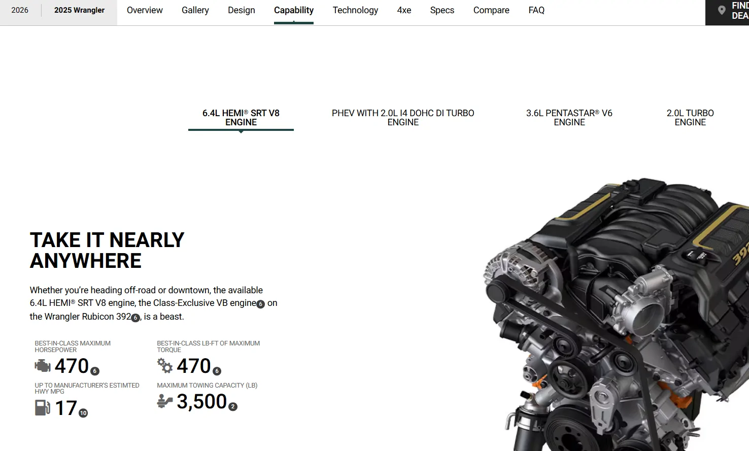

I simply changed the engine to a hemi -
As far as "proof" it's cooling - do you really think Jeep has that published anywhere?
Put the puzzle pieces together, and with some pattern recognition, experience with engines and cooling and critical thinking, you see - gee, identical vehicles, but the one with 200 more HP and that burns a lot more gas and puts out more heat - when they had trouble cooling the 3.6 to get their ratings and once in a while a diesel owner talks about heat and towing - it makes total sense.
Another way to look at it - with all of the issues, all of the trouble that Jeep went through to get the ratings for the JT - squeezing hard, and then later changing grill design - hmmmmm.
Sorry, I don't have a youtube channel with inside sources telling us that it's about the cooling - it's simple math, logic, pattern recognition, critical thinking.......
Do you really believe Jeep is going to publish this type of information? Why would or should they?

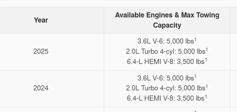

The change goes back to the 2024 model year - from 3,500 to 5,000. The same year with the new grill.
Almost 200 HP more - that takes gas.. Dropping from 25 t 17 mpg - yeah, it burns gas. And where does that energy go? Cooling system. It's an engineering thing. Heat rejection.
But....but....but Ram..... but nothing. It's got a larger cooling capacity. The grill isn't confined so much and they shove air up from under the bumper.

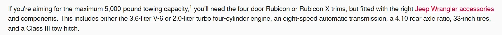

It neglects to mention what exactly 'properly equipped' is 😄
Here is that list - my dealer has it, as well as some others, and an article about Wranglers and towing. They all say the same thing -
