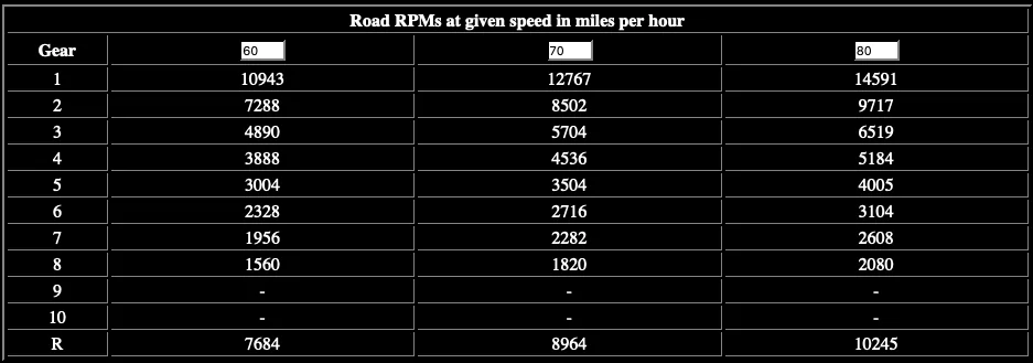

First off, here is stock 4.10 on 33" tires (31.5 in calculator). You can see at 70mph you're just over 2000 rpm in 8th gear. Great on flat land but any kind of hill I was downshifting to 7th or 6th more than I think reasonable in the mountains:
Jeep Gladiator 4:10 rings for $200 with 12K on them - for 35" or 37" eventually? Screen Shot 2020-09-29 at 1.12.34 PM

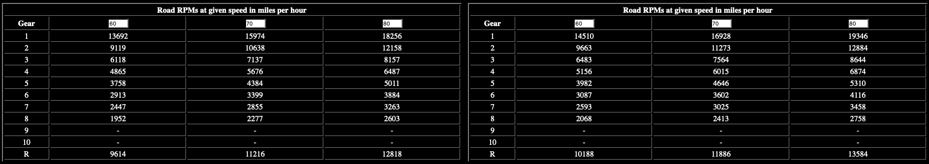

2nd: here is 4.10s on 37" tires (35.5" in calculator). This is where the thing was a dog when it comes to hills (even in Nebraska and SD and ND where we recently took a long trip)--way too much downshifting on ever tiny bump in the road. only held 8th on complete flats or downhill (and not enough torque to hold 80mph in 8th):
Jeep Gladiator 4:10 rings for $200 with 12K on them - for 35" or 37" eventually? Screen Shot 2020-09-29 at 1.16.25 PM

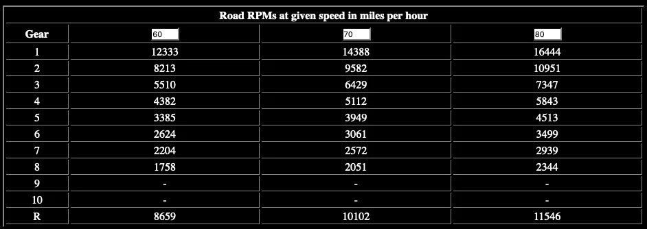

So here are some alternative scenarios I have (running at 5.13 and 37" tires--35.5" in calculation on left and 35" tires -- 33.5" for the calculator on right. not a huge difference at 70mph between the two but much more power and still in a happy place for these pentastar motors to cruise efficiently from what I have read.
Jeep Gladiator 4:10 rings for $200 with 12K on them - for 35" or 37" eventually? Screen Shot 2020-09-29 at 1.07.54 PM

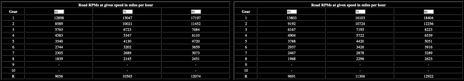

Given my earlier thoughts for you I also ran it with 35" tires (33.5 in the calculator) with 4.56 on the left and 4.88 on the right. Note at 4.56 you've got just about 100rpm advantage over the 4.10/33" factory config in the first chart (which I think is slightly under powered in CO) and 4.88 puts you in a better power band on 35's in our area with the option of getting away with 37s in the future without giving up too much power:
Jeep Gladiator 4:10 rings for $200 with 12K on them - for 35" or 37" eventually? Screen Shot 2020-09-29 at 1.10.51 PM
