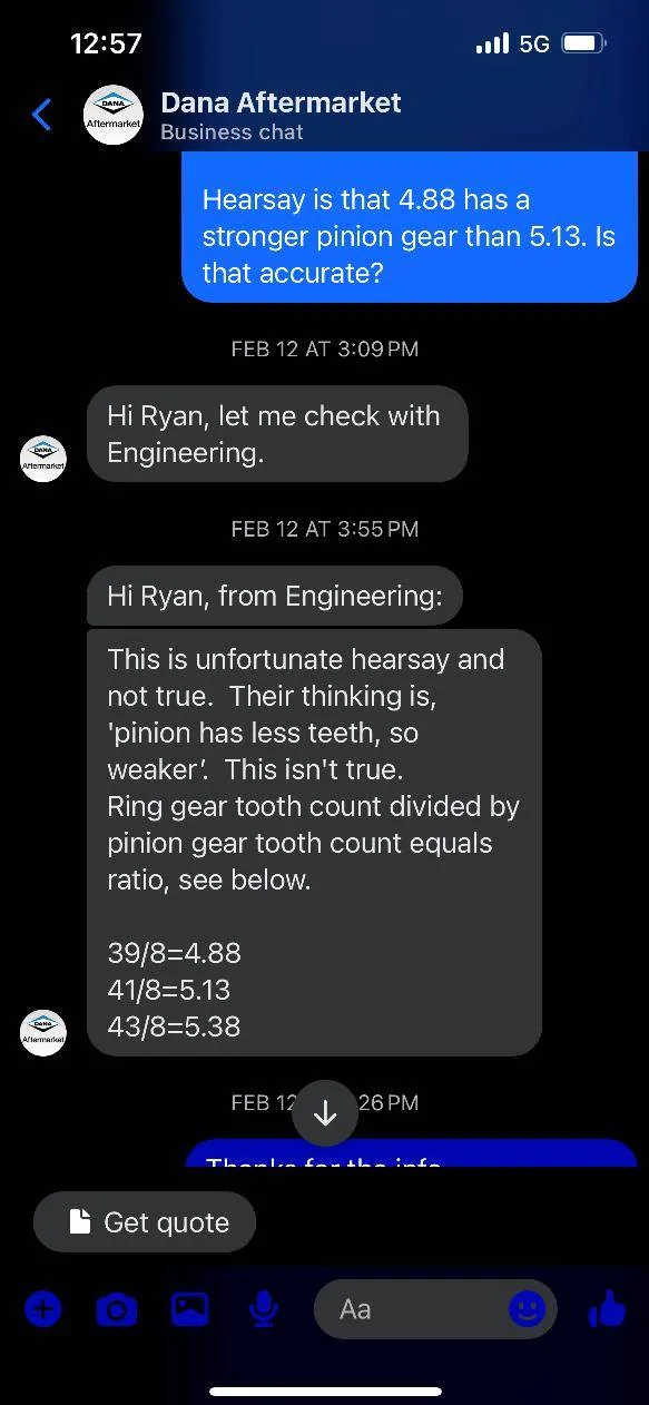

Don’t ya’ll have concerns about the teeth being too thin in that gear ratio?
Reason I say that… back in the day… we had a built YJ with Dana 44’s on 35’s (from a Grand Wagoneer). We put 4.56 gears to keep the ‘teeth’ stronger versus 4.88’s or higher.
But then again….. back then, 33‘s and 35’s were popular and 37’s were considered HUGE. Today? Holy crap….people be putting 40‘s on without batting an eyelash. 😳

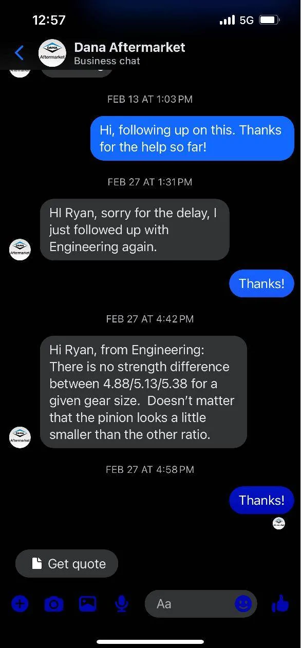

The teeth don’t get thinner or weaker as ratios change. It’s an old myth. The overall size of the pinion head is smaller which leads to the incorrect conclusion it’s weaker. It’s not. Between different ratios, the tooth counts are different so they have the appropriate tooth size and tooth surface contact areas.

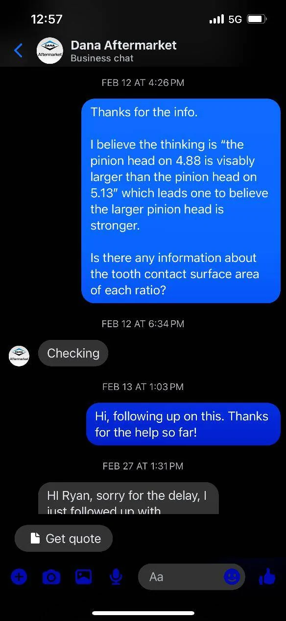

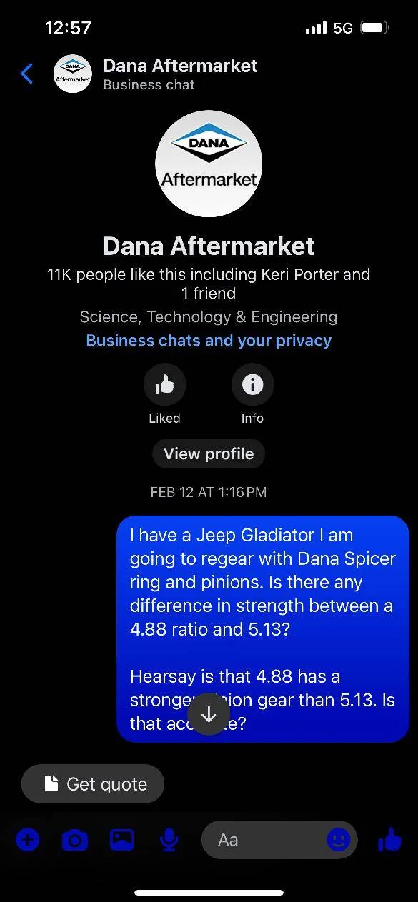

I know that's what everyine says , but to tell you this I am sure I will see backlash . Let's see the data , let's see a study, let's see as many teeth stripped off a 4.10 or 4.5y pinion as a 5.13 pinion. Show that to me so I can have a different opinion.
I don't know of any data that proves this.
Best I can do is a chat I had with Dana a few months ago.
Jeep Gladiator 410 gearing to 488's Dana ratio strength #1
Jeep Gladiator 410 gearing to 488's Dana ratio strength #2
Jeep Gladiator 410 gearing to 488's Dana ratio strength #3
Jeep Gladiator 410 gearing to 488's Dana ratio strength #4
