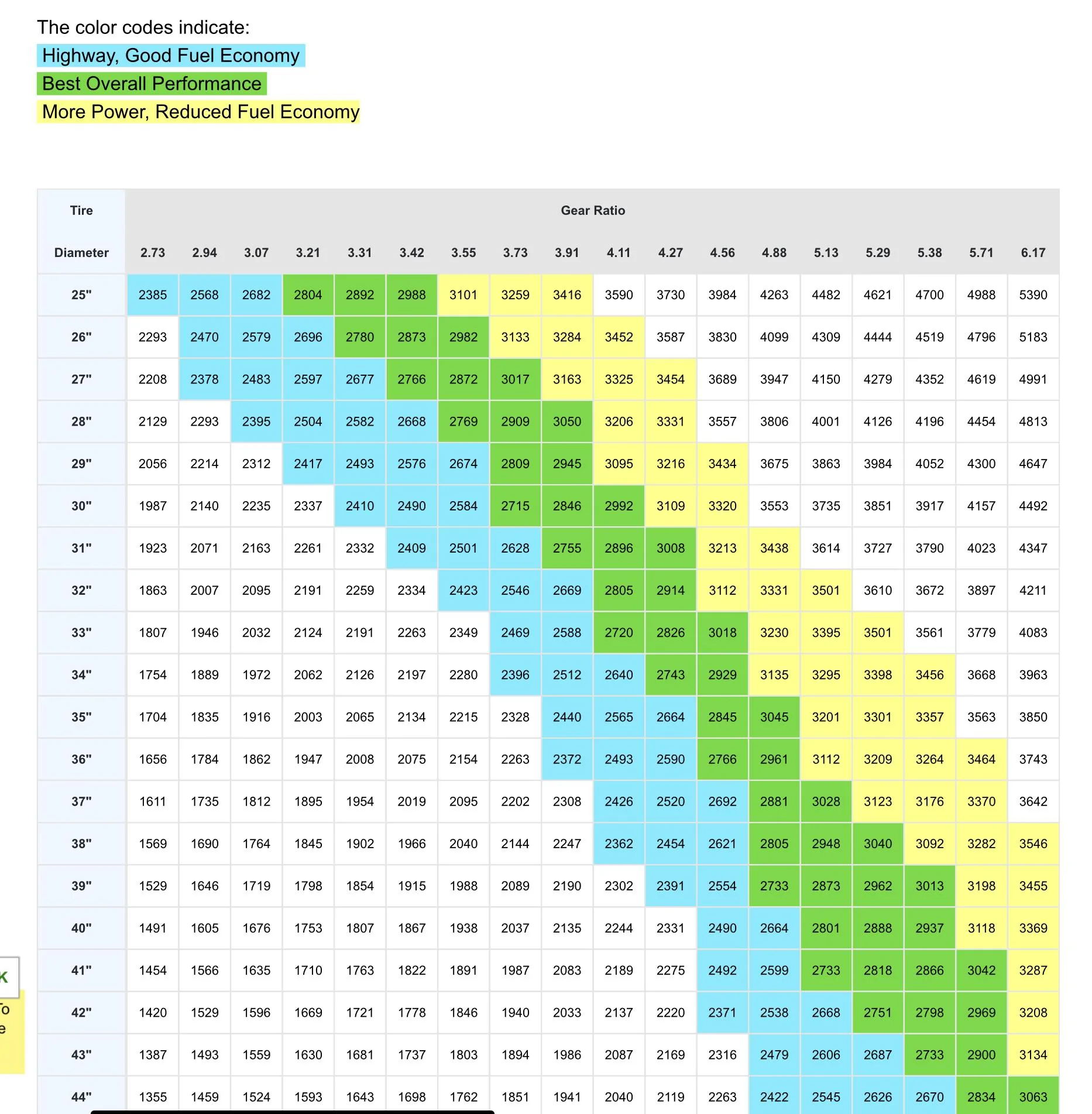

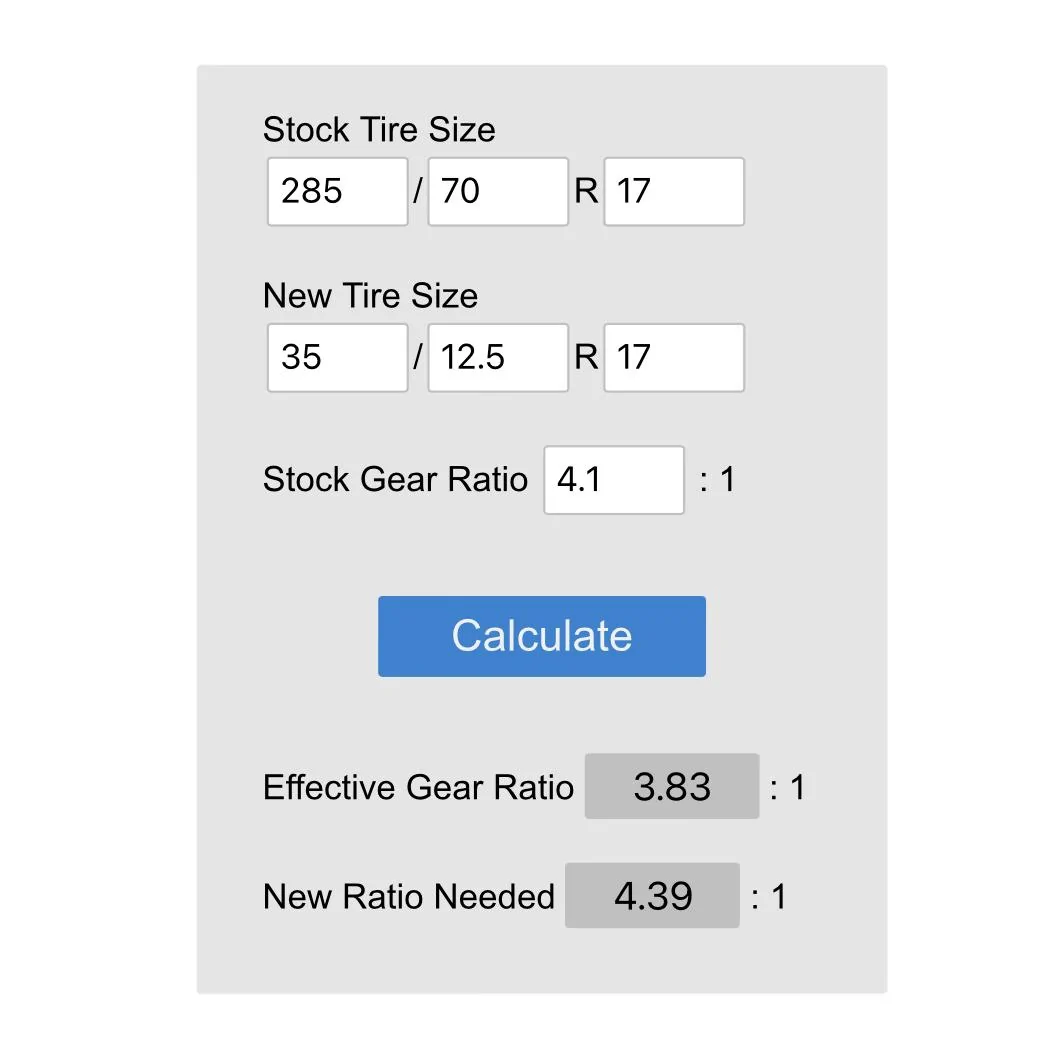

This gear ratio chart is your friend. Going from 32.7” tires to 35“ tires drops your effective gear ratio to 3.83, which is below 4.10, so you will notice a difference in performance. The new ratio needed to get back the feeling of the original stock ratio (4.10) is 4.39.
https://tiresize.com/gear-ratio-calculator/
Good for the mathematical calculation but there's a ton more that goes into it. Larger tires are significantly heavier and all that weight is as far out as can be so while this chart is good for getting your RPMs where they need to be, it's not going to translate into feel and you'll often need to go an additional step up.
Yea, sure. But it’s a good starting point for people who want to understand the fundamentals of regearing when it comes to tire size.

It's not just the weight but where the weight is located. All else held equal (including ratio), a lighter weight tire can feel heavier depending on the size of the two because an increase in diameter has a greater impact than a proportional increase in weight. Where larger tires get in trouble is that they not only require more energy to move because of the above, but the reduced mechanical ratio is also generating less force than it was previously. Gearing can fix all but using the calculator/chart like above will only fix the second issue.
There's so many variables there really can't be an absolute statement here but I've done a lot of tires and a lot of gears and the only people who were happy targeting a similar ratio were the ones who wanted fuel economy... everyone else wasn't thrilled with how the truck felt off the line.
