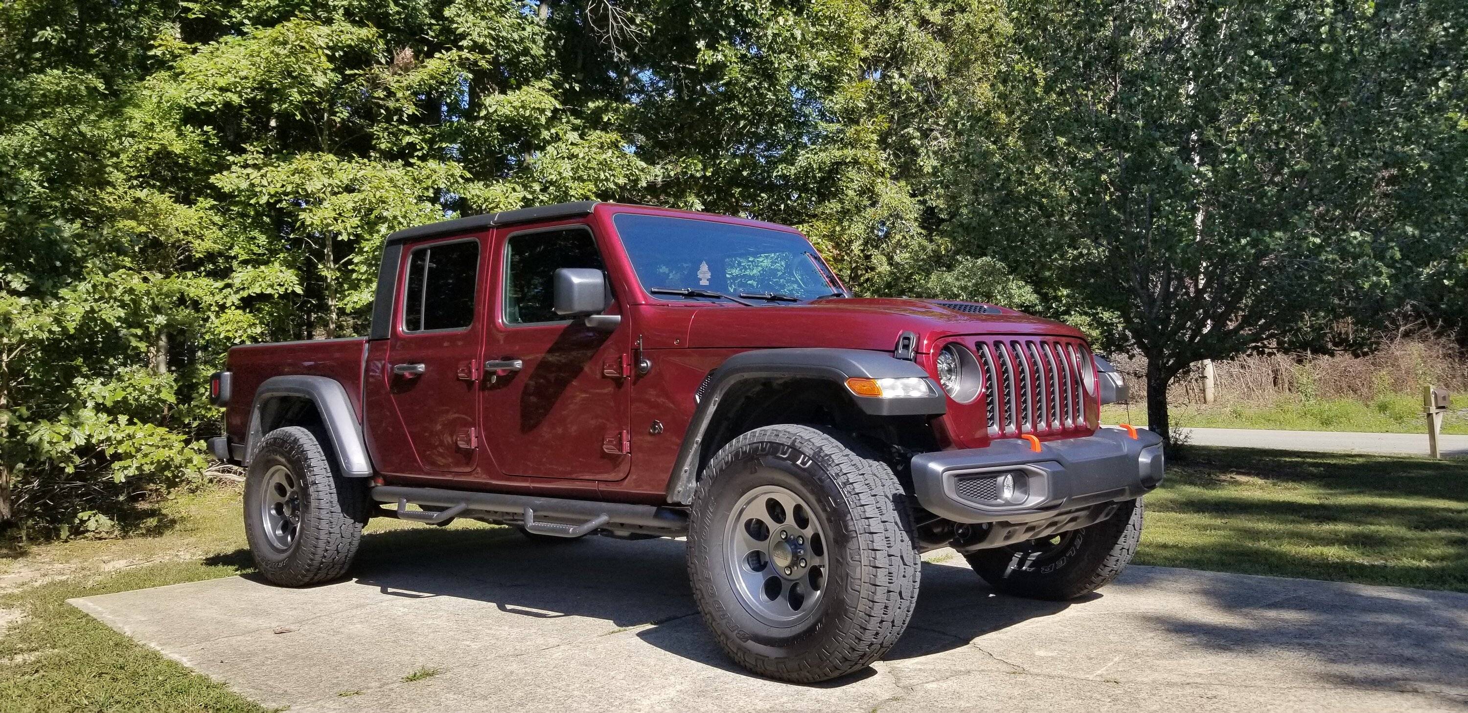

Mine did, but it handles and tows and hauls so much better with E load Revo 3s and the ride is exactly the same as long as you don’t go over 35 psi. I got 60k out of my last set running them at 33-34. They wore evenly and they all had 4-5 32nd left. Those tires didn’t last long on my Jeep. I hated them and took them off when it was almost brand new.

My E Load Revo 3s are only about 62 lbs. 62 or 64. They’re larger than Mojave tires (33.7”).
