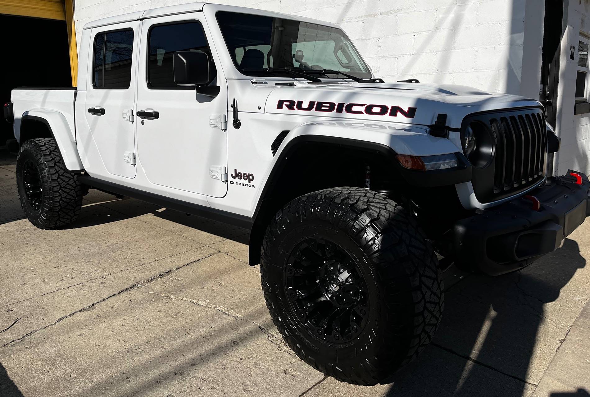

As others said, you don’t need a lift for 33s. To find the best shop around you for other mods, join a local Jeep group on Facebook and ask for recommendations. You might make some new friends to go wheeling with as well
