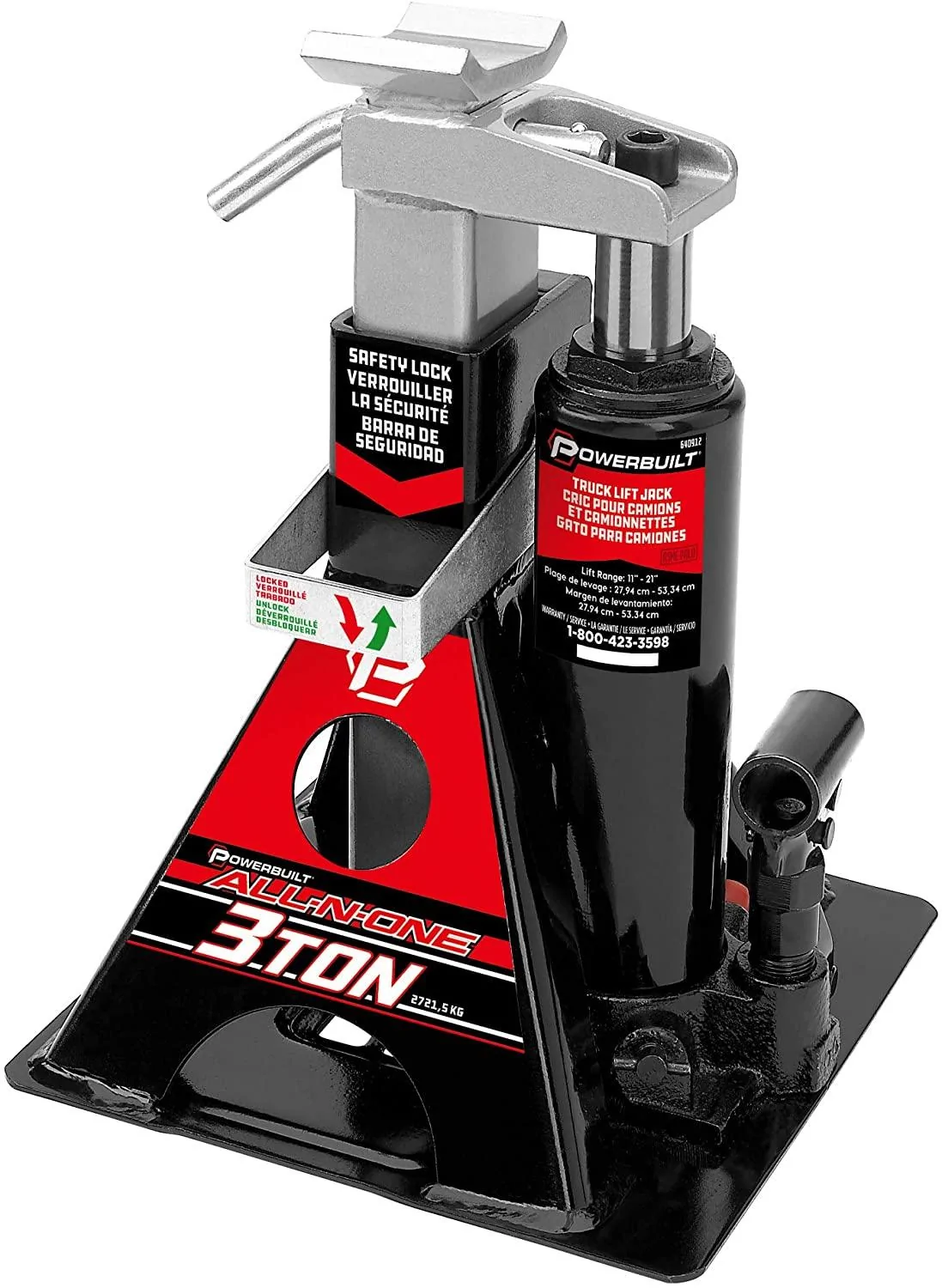

Bottle Jack is the way to roll my friend. I have a 5 ton with extensions & a 1 & 1/2" thick plywood for it as a base. It is 40 years old and has recovered many a Jeep going back to my high school days.
I realize the benefit of a bottle jack is that they dont' move laterally as they go up. But can you get one with any significant extension beyond just a few inches?
