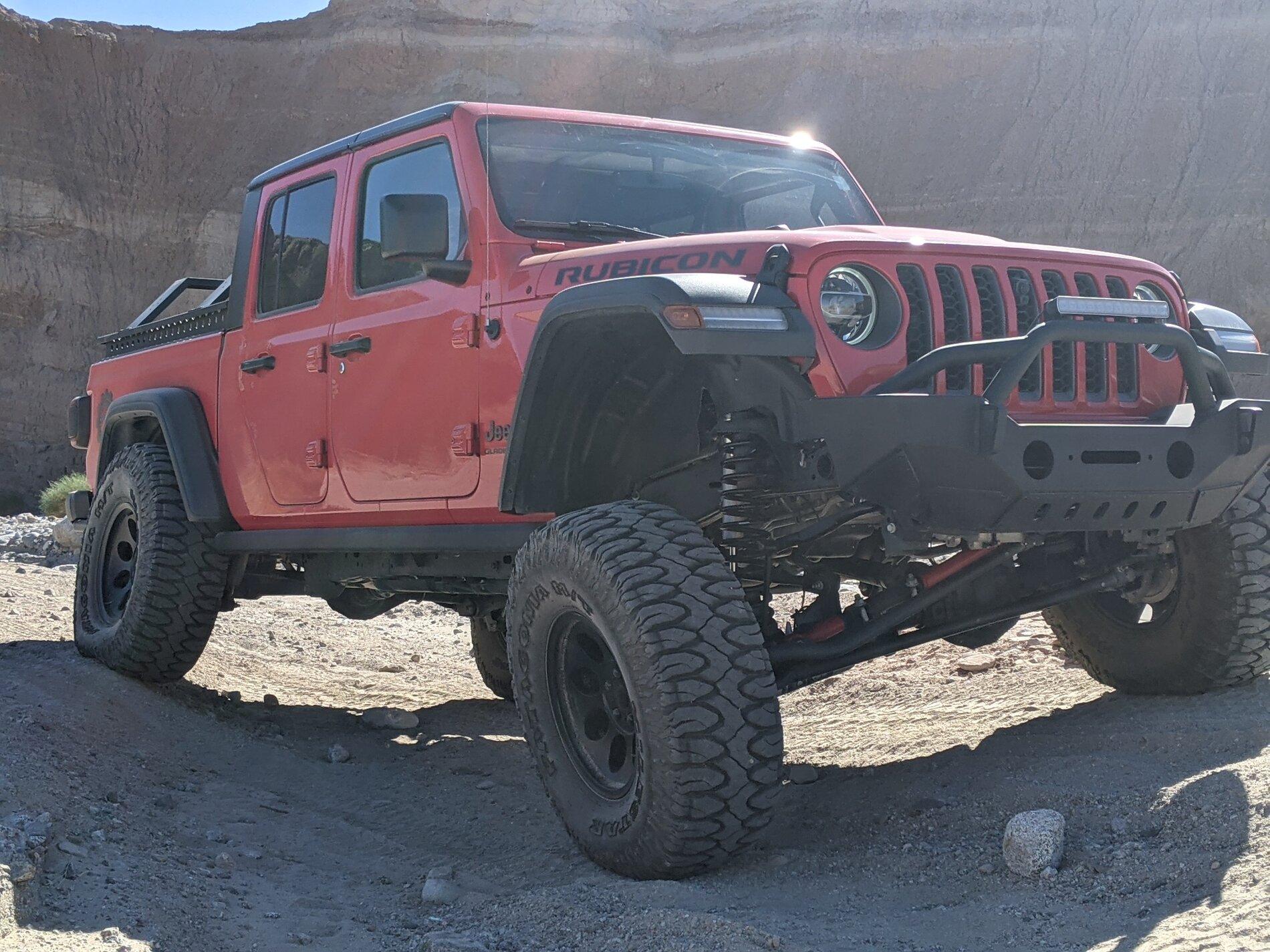

Full build sheet - 2019 build notes
The Build Sheet
Jeep Gladiator $7000 = Mopar Lift + Wheels/Tires!? PXL_20211113_200011417
4.5” EVO Enforcer Overland $1,160
https://www.northridge4x4.com/part/...ring-4-5in-enforcer-overland-lift-kit-stage-1
Fox 4.5-6” Rear 2.0 Shocks $162+162
https://www.northridge4x4.com/part/...ies-2-0-smooth-body-shock-rear-4-5in-6in-lift
Fox 4.5-6” Front 2.0 IFP Shocks $162+162
https://www.northridge4x4.com/part/...mance-series-2-0-ifp-shock-front-4-5-6in-lift
Computer
Tazer JL Mini $329
https://www.morris4x4center.com/z-a...WpIR5Ryx8TWWh-d_Ubklm9Ve11i7DkaRoCAD8QAvD_BwE
Steering
Yeti Drag link $429
https://steersmarts.com/collections...oducts/yeti-xd-jeep-wrangler-jl-jlu-draglinks
Yeti XD Track Bar $260
https://steersmarts.com/collections...cts/yeti-xd-jl-jlu-adjustable-front-track-bar
Yeti Track Bar bracket $150
https://steersmarts.com/collections/brackets/products/yeti-xd-jl-jlu-track-bar-relocation-bracket
Yeti XD Tie Rod (Rubicon). $425
https://steersmarts.com/collections...xd-jeep-wrangler-tie-rod-assembly-jl-jlu-2018
Wheels
Baja Extreme II $129.99x4
https://www.quadratec.com/p/quadratec/baja-extreme-ii-wheel-wrangler-jk-jl-gladiator-jt/black
Tires
Milestar Patagonia 38’s $249.99x4
https://www.walmart.com/ip/38X13-50R17LT-119Q-C-6-BW-MILESTAR-PATAGONIA-M-T/776392809
Driveshaft $552.00 BLEEP20 for 20% off Adams Driveshafts
https://www.northridge4x4.com/part/...ms-driveshaft-1350-solid-cv-front-driveshafts
Control arms
Rear lowers
https://www.northridge4x4.com/part/...ufacturing-rear-lower-adjustable-control-arms
Rear uppers $397.00
https://www.northridge4x4.com/part/...orcer-rear-upper-adjustable-control-arms-pair
Front uppers
Rear trackbar $184.00
https://metalcloak.com/jt-gladiator-rear-durotrak-track-bar.html
Steering stabilizer - Fox 2.0. $~150
Coil spring correction pads -
https://www.northridge4x4.com/part/...d0WQJn8D8dcVdMwK4jS6vam6ADFY4afRoCQcAQAvD_BwE
$3,600.00 already paid
$2,275.00 to get onto the trail/road
Alignment - Dave’s Wheel Alignment
Appointment: 8 am Tues morning
