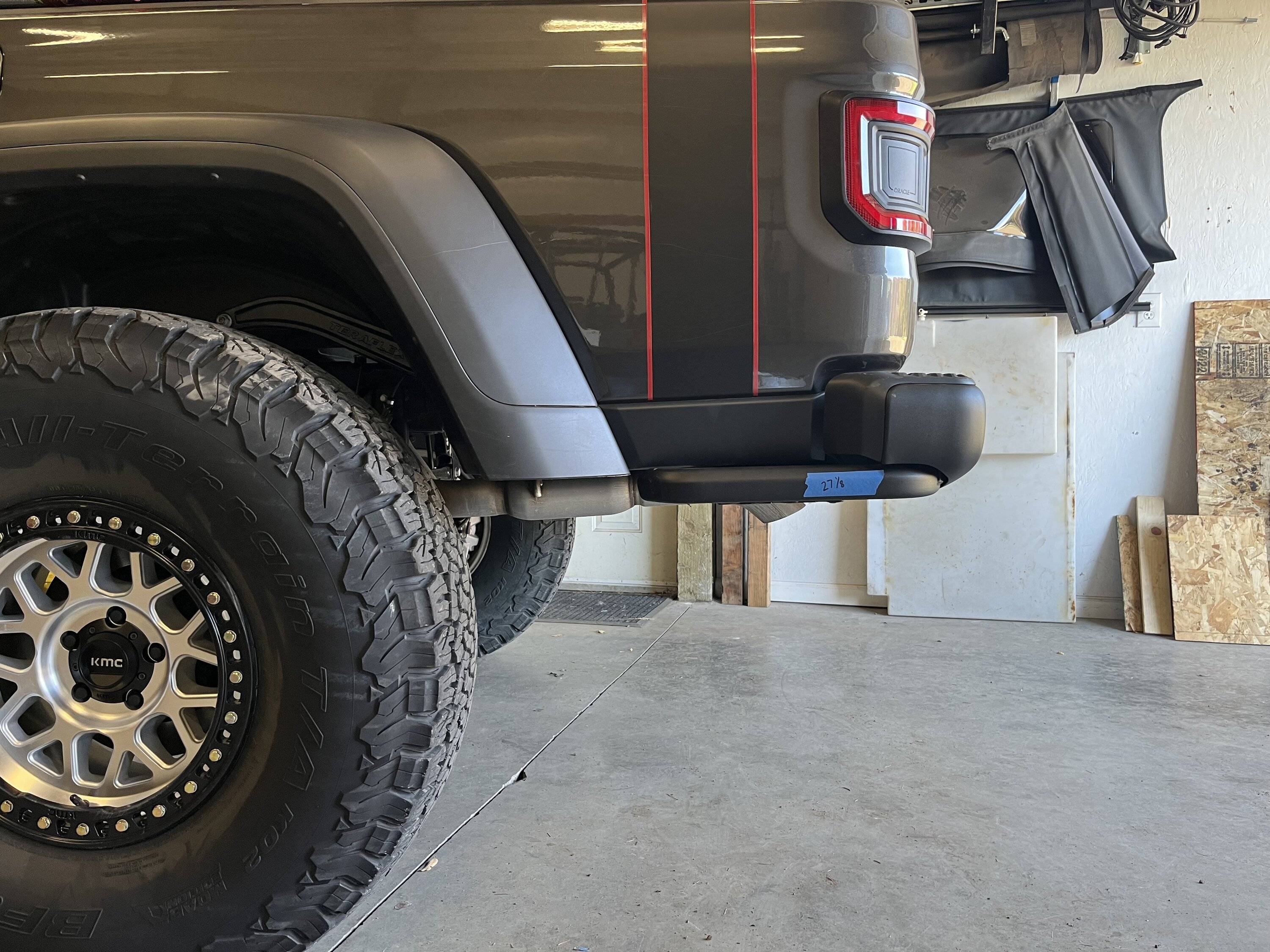

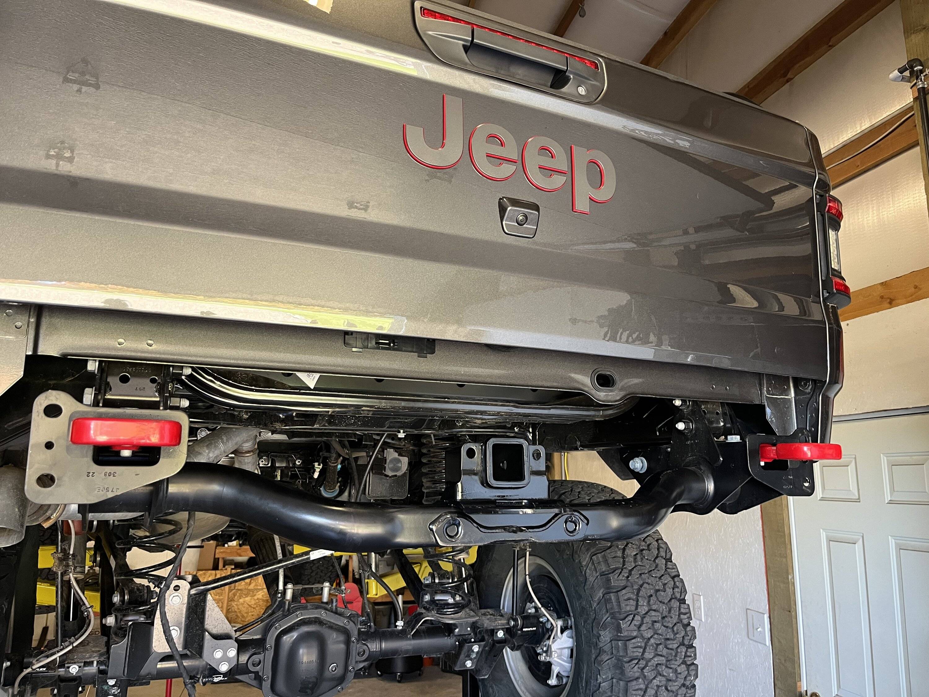

I'd finally had it with the low-slung factory receiver hitch:

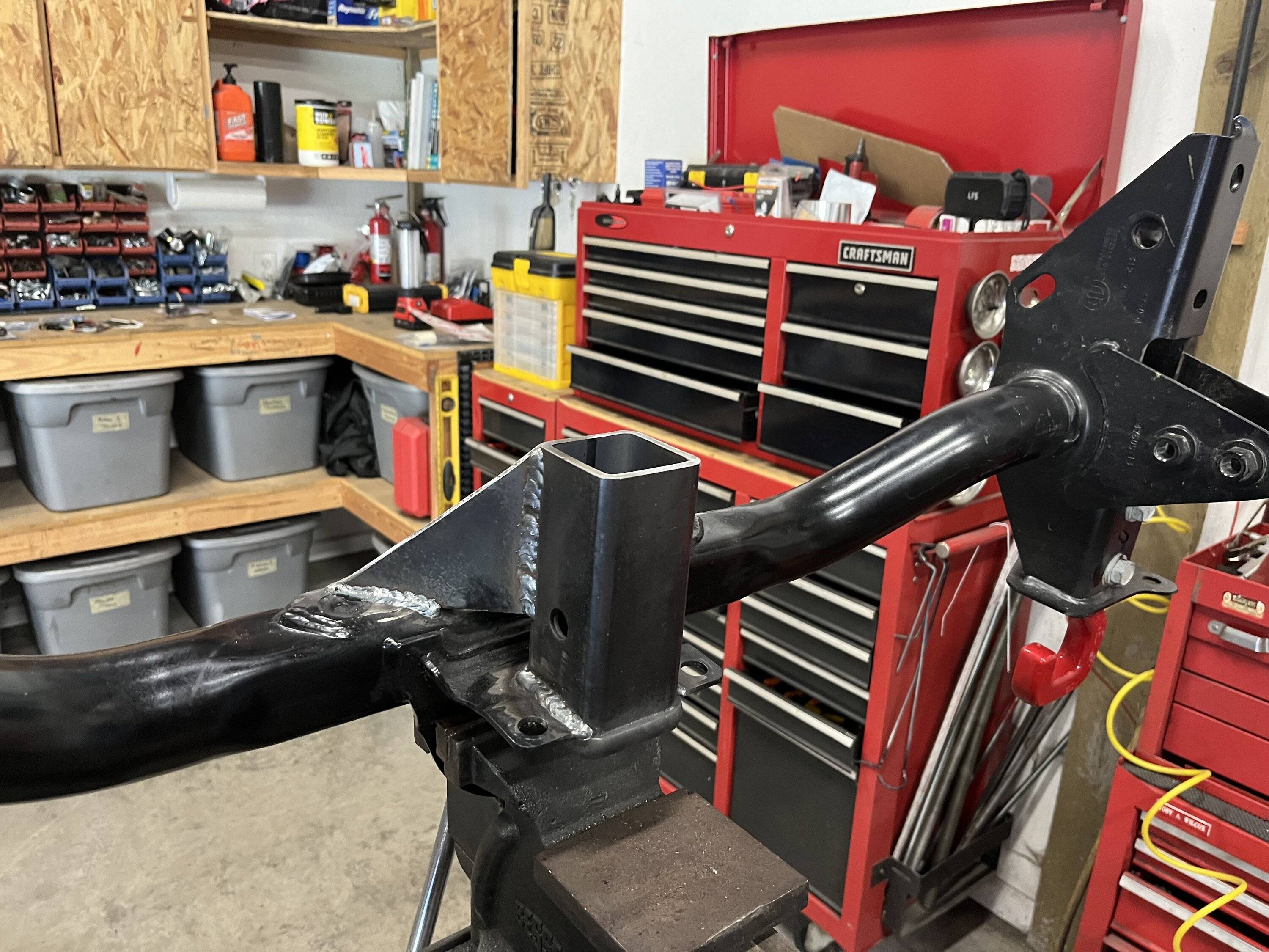

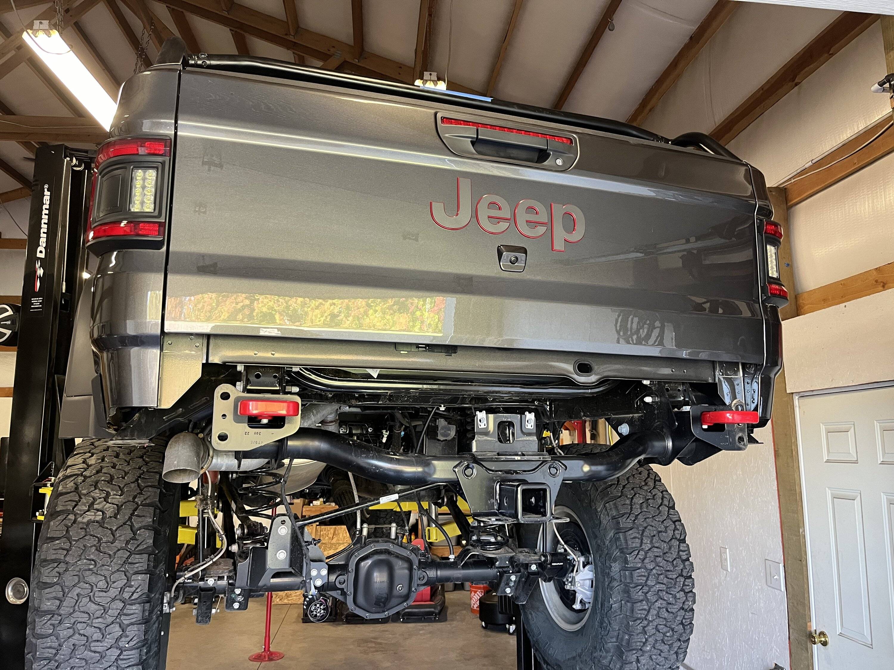

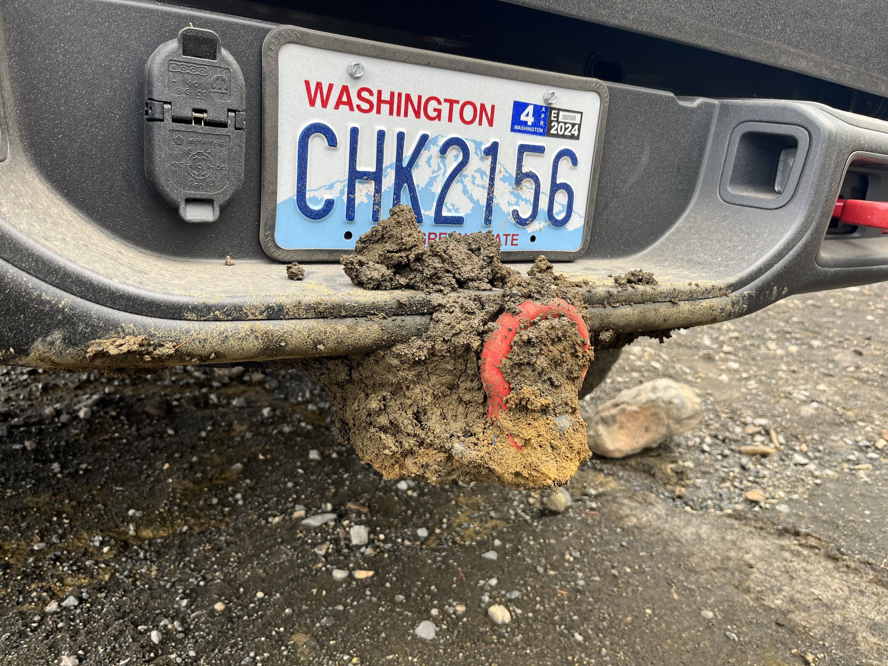

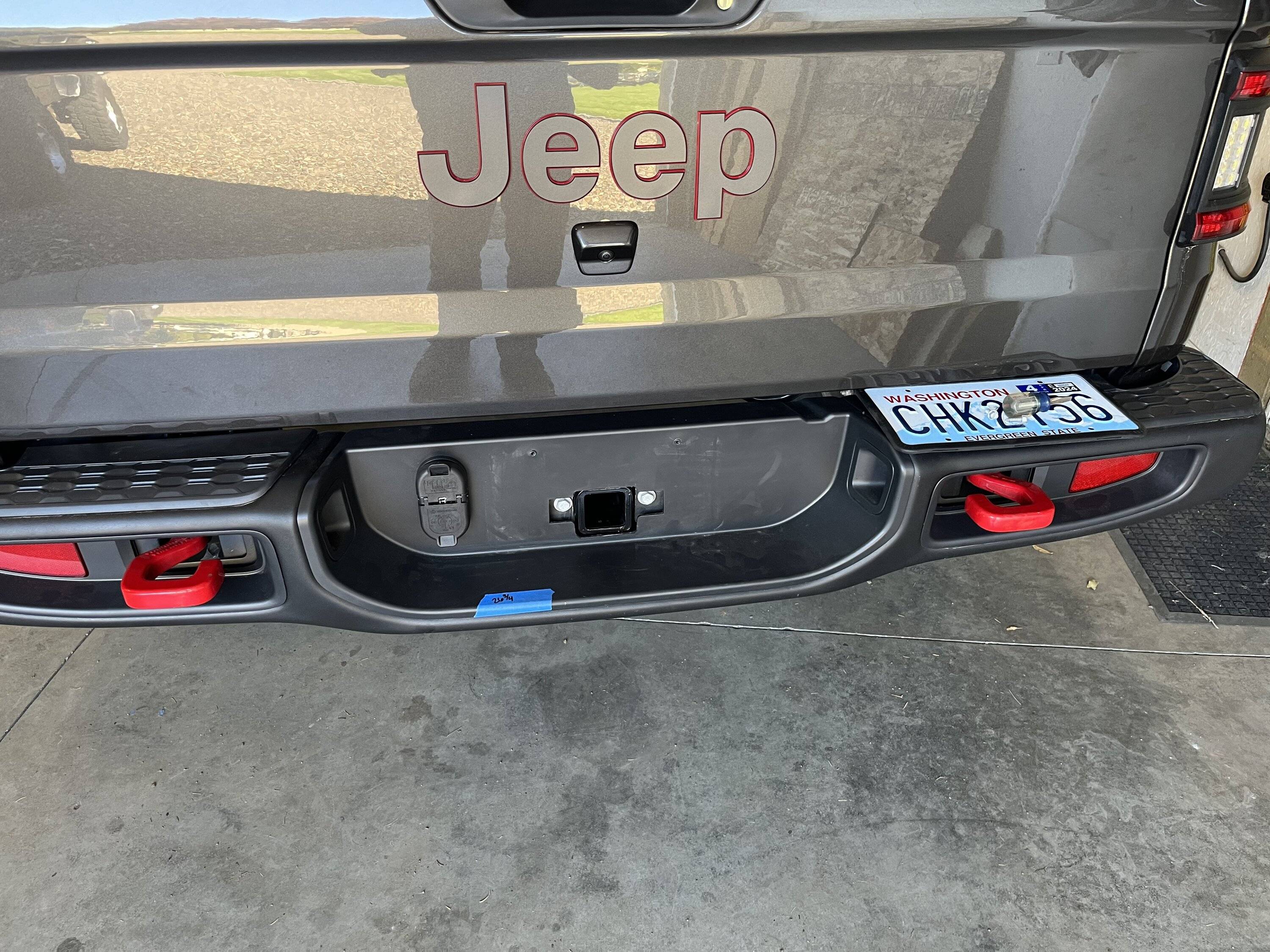

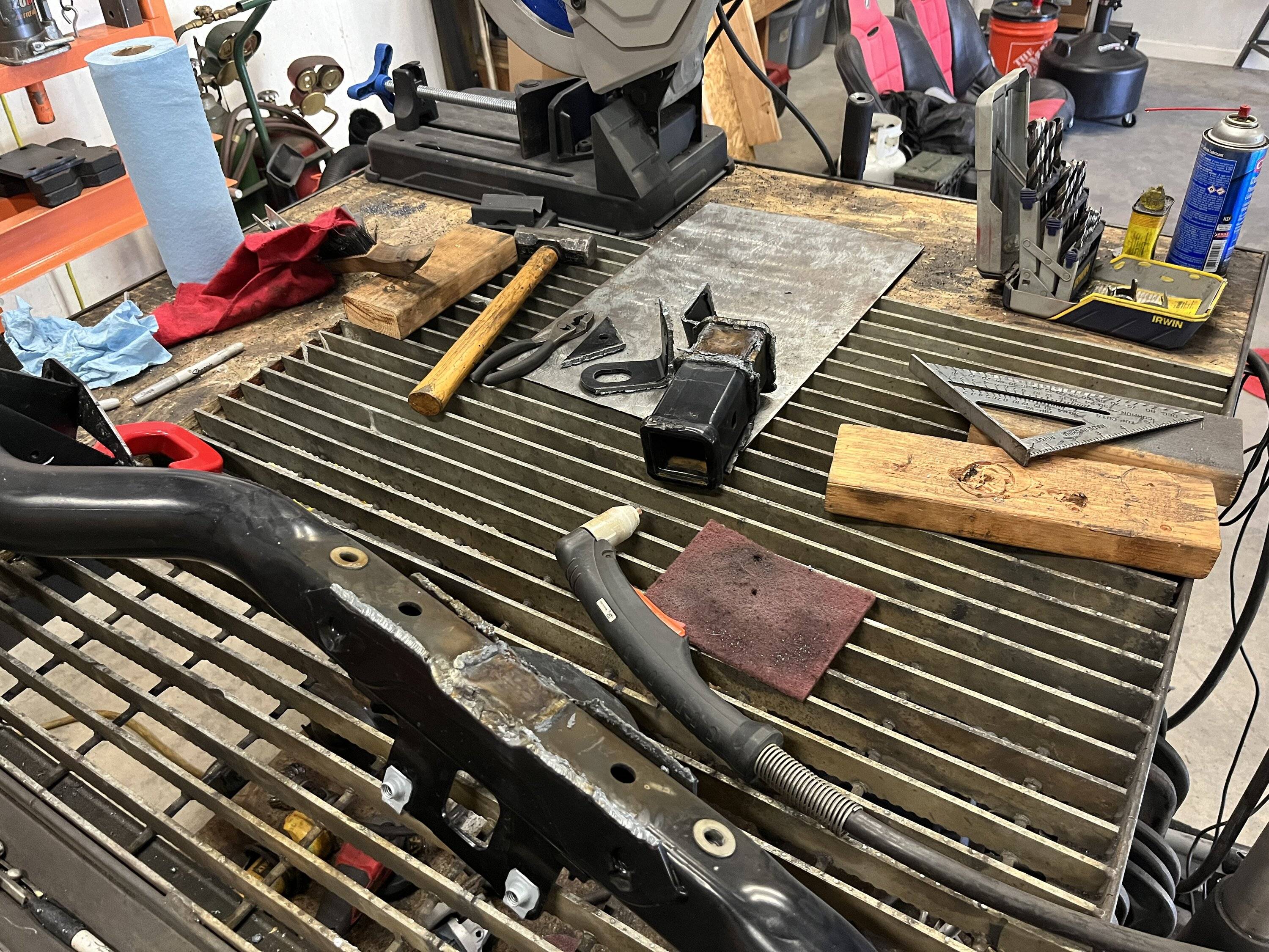

I spent a couple hours pulling the factory rear crossmember/hitch, carving off the receiver from below the crossmember, and gluing together a new one above the crossmember:

Looks nice but how do you hook up your safety chains?
I'm fabricating a simple extension that will incorporate the safety chain loops and allow me to use a drop shank when necessary. Also working on a flip-up license plate bracket.

Hitch extenders reduce your hitch capacity, don't they? And pretty quickly as you add length if I remember right.
Also, how hard is it to get at the hitch pin? Looks pretty tough from the few photos up so far.
I do have to say, though, great welds on there and supports.
Just curious of how easy to use a mod like this would be if you tow more frequently and what you lose in the process.

Seems to me that safety chains on the ball mount won't comply because it's very possible for a ball mount itself to come free of the tow vehicle receiver.
In other words, chains should not be connected to something that isn't actually part of the truck - so an extension that pins to the truck isn't considered legit safety chains. Something could happen with that pin, leaving the whole thing to drop.
Safety chains must be secured to part of the tow vehicle.
The laws are pretty clear - attached to the tow vehicle, not something plugged into the tow vehicle.

Ah, found it - federal law - IF I am reading this correctly - can't connect to an extension or something pinned to the tow vehicle - so the safety chains must go to the structure of the vehicle (or a receiver which is in effect part of the very structure of the vehicle and isn't merely pinned in place)
Anyway - the laws says back to the drawing board - can't hook safety chains to an extension that's pinned.

I thought that might've been the case, but wasn't sure. I know my personal feeling has always been that chaining onto an extension kinda defeated the purpose of the chains and was an unneeded risk, but I never looked into the legality of doing it.
Then again, I actually like the receiver being below the bumper. Means I can put a skid plate on the hitch very easily there and protect the rear end of the truck when wheeling. After all, if it's getting that much ground contact as it seems in the first photo, all that contact is going to be on the plastic bumper now.
But to each their own, I know that not everyone's approach. It looks like a good job for someone whose goal was just to get it out of the way without losing it entirely, and not really planning on doing any towing.
