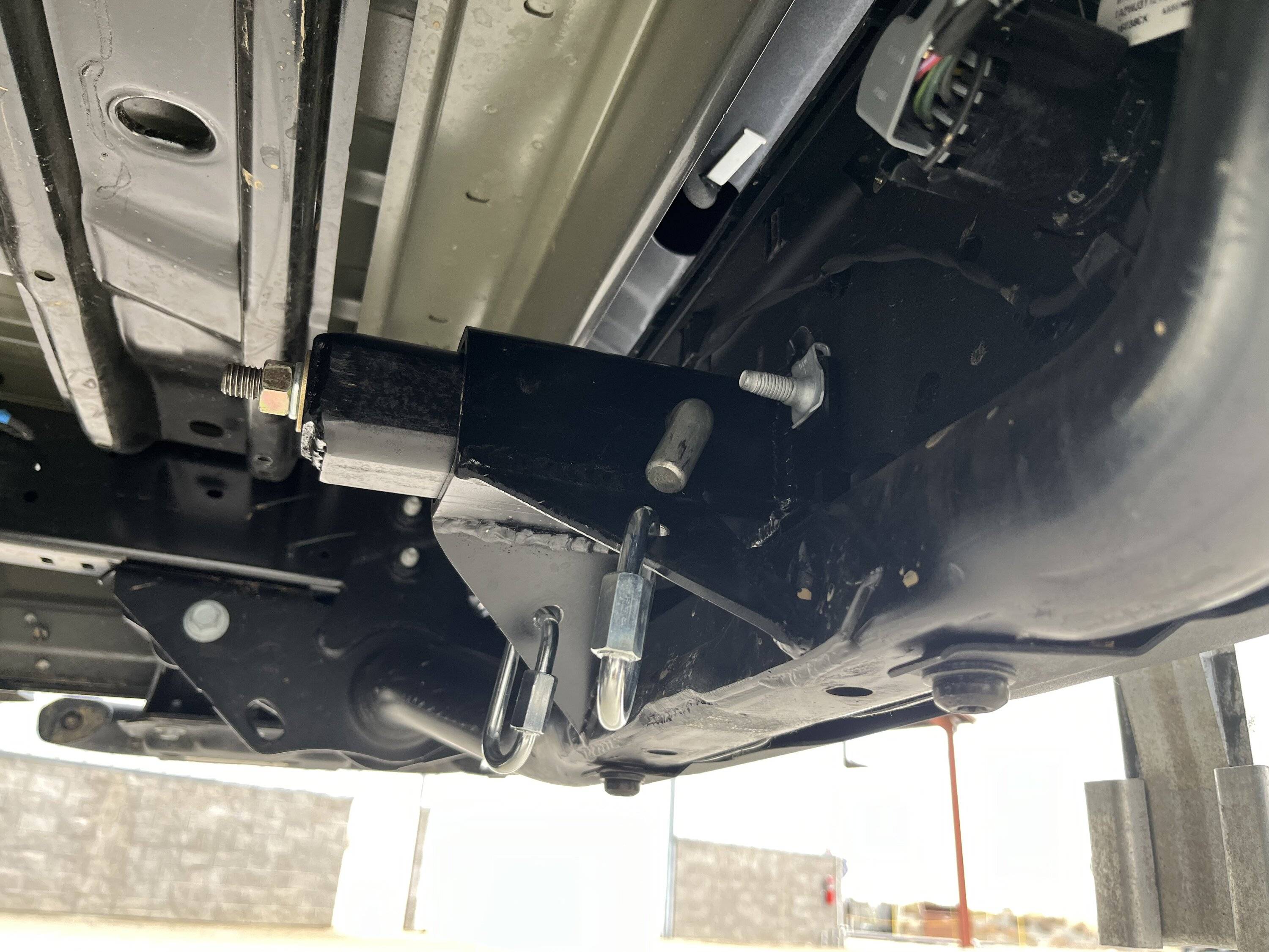

Realized that I never addressed the concern brought up here about safety chains... Simple as a couple of holes and quick links:

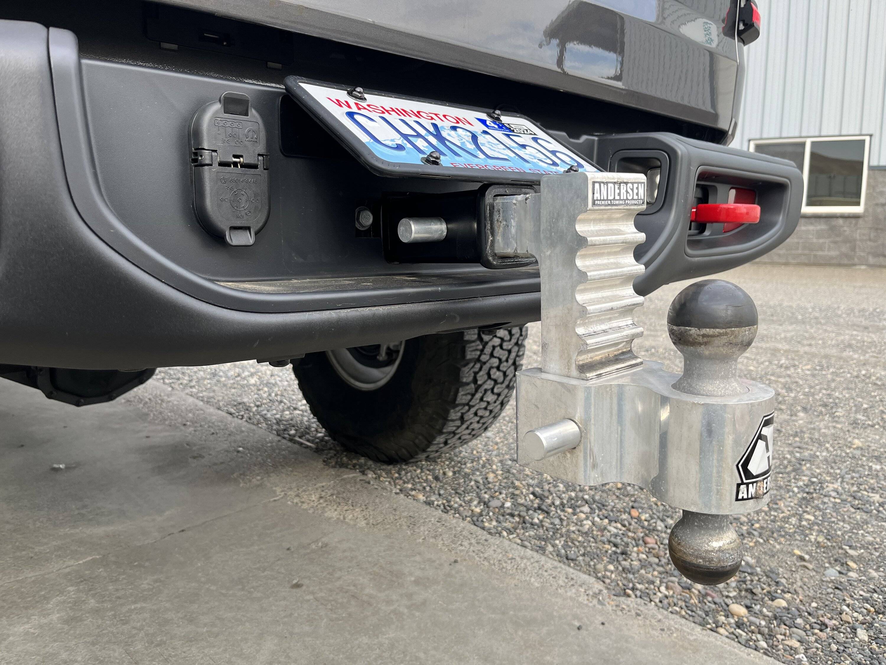

I built a quickie hitch extender that incorporates a sliding wedge to keep things rattle free:

The below are my personal opinions only... I despise debates on forums on the interweb, but I figured I'd address your comments just to shed light on the fact that I'm doing this for my specific use case. What I do isn't what anyone, and I do mean anyone, else should do.
The problem with adding a skid to the hitch is that you are making the problem worse... the point of my modification is to get it out of the way so that it doesn't hit in the first place. My issue isn't so much with coming directly down on the receiver hitch, it's when you can't scale an obstacle on the first crack and the receiver, being ~3" lower than the bumper, becomes a pogo stick that prevents you from backing up and realigning. I'm simply not a talented enough driver to make everything in one shot, so I find myself backing up for attempt #2, #3, #4..... Coming down backwards onto the relatively smooth underside of the bumper will help me greatly.
All of this applies to going forward as well, of course. Not having to contend with that extra 3" (or more if you add a skid plate below it) can make all the difference in the world.

Now the ball will drag! LOL just silliness on my part. Looks like a great job and totally works for your setup.
all our balls drag. <rimshot>

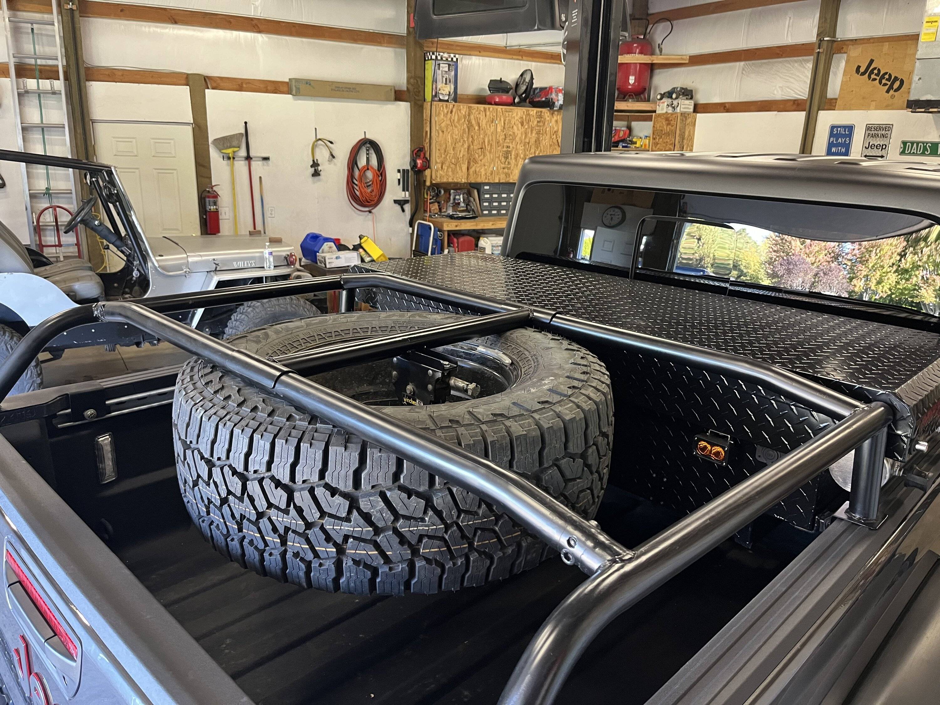

great solution. what about the spare? Or is that in the bed?
re: chains - they don't always work. Years ago we were leaving a cabin with snowmobiles on a small 2-place trailer. Hooked it up, latched it up and took off up the hill.
Unfortunately there must have been some snow/ice in the locking mechanism, and the trailer never latched around the ball. So a big dip made the trailer bounce, lift off the ball, and because of the incline, roll backwards and off the side of the road. The chain hooks straightened right out.

Chain links or forged hooks don’t straighten out, but most trailers come with the bent 3/8” rod “S” hooks, can’t blame trailer guys people just want the lowest price.
Relocated the spare up into my "bed rack"... I don't know what else to call it since it's just something that, again, I fabricated for my specific application ?‍♂
fabricators are a dangerous breed. ;)

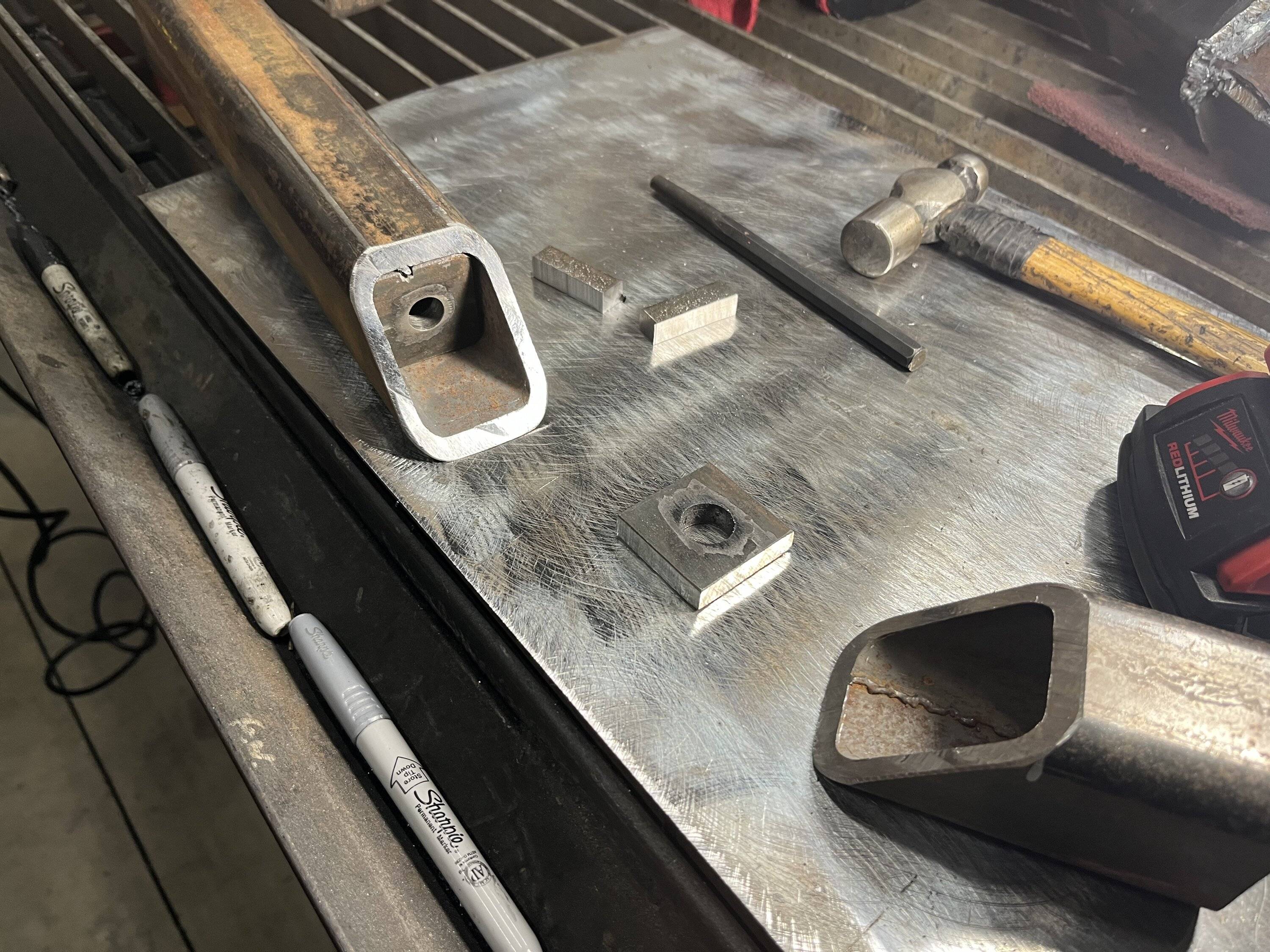

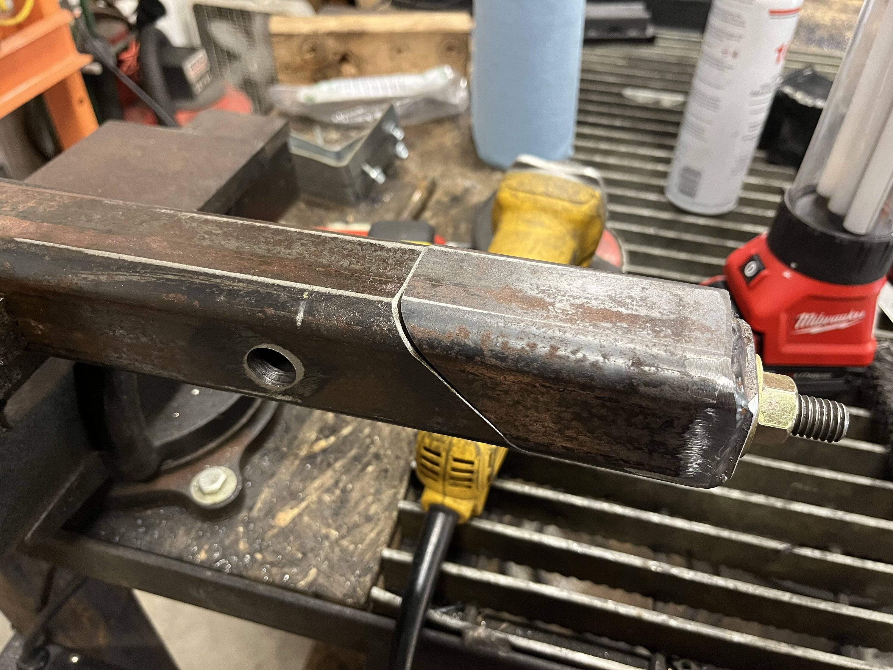

I'd finally had it with the low-slung factory receiver hitch:
I spent a couple hours pulling the factory rear crossmember/hitch, carving off the receiver from below the crossmember, and gluing together a new one above the crossmember:
Nice job! I am not a fabricator and wish someone made a bolt-in replacement hitch that achieved this. I hate that low-hanging hitch receiver! I wonder if this hiddent receiver would work with the stock bumper. Add-On Accessory Hitch for MTO Series Gladiator Rear Bumper
