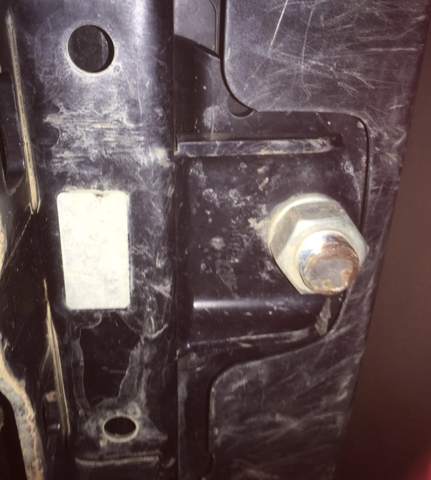

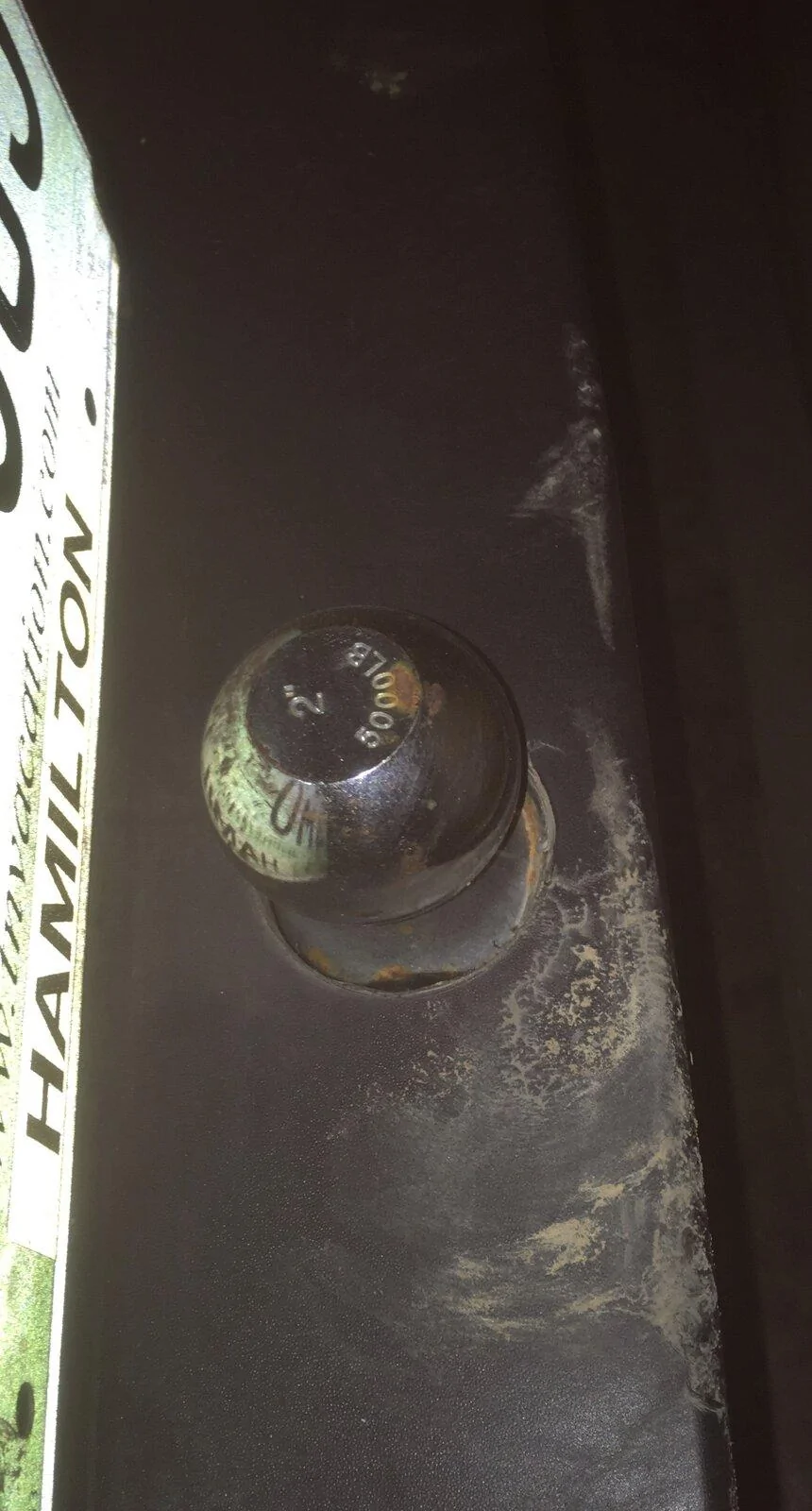

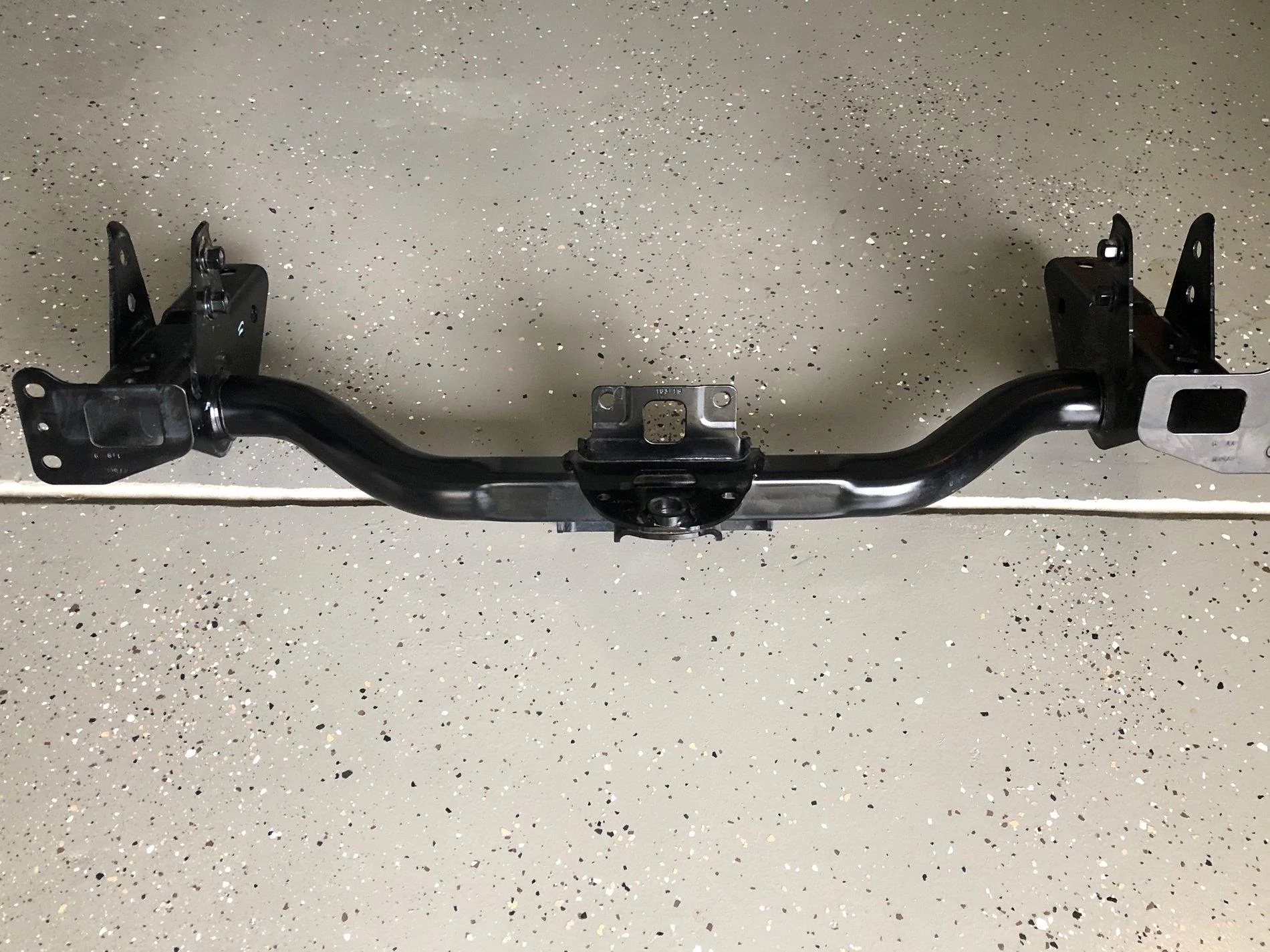

The non-tow package still has a tow bar, but doesn’t have a receiver box. I honestly can’t say for certain, but I think mine still has a 7,000 lb tow rating. Here are some pictures (ignore the damage to the plastic caused by using a trailer with too steep and angle). Obviously the ball I’m using is only rated at 5,000.
Thanks! I really appreciate the education on this one. I guess I figured it was done differently but this makes total sense - it's still basically a ball at the bumper - but only in appearance as it's still attached to the bar below. Got it.

I just did a little more research. My tow rating is 7,000 lbs, but this is a class II hitch, so probably limited to 3,500 lbs. I specifically didn’t order the tow package because I wanted extra clearance, and I won’t be towing anything heavy.

I installed one of those. just removed the rear bumper so you don't need to drill.

Possibly silly question: Why not just replace the installed hitch with the factory 2" receiver hitch?

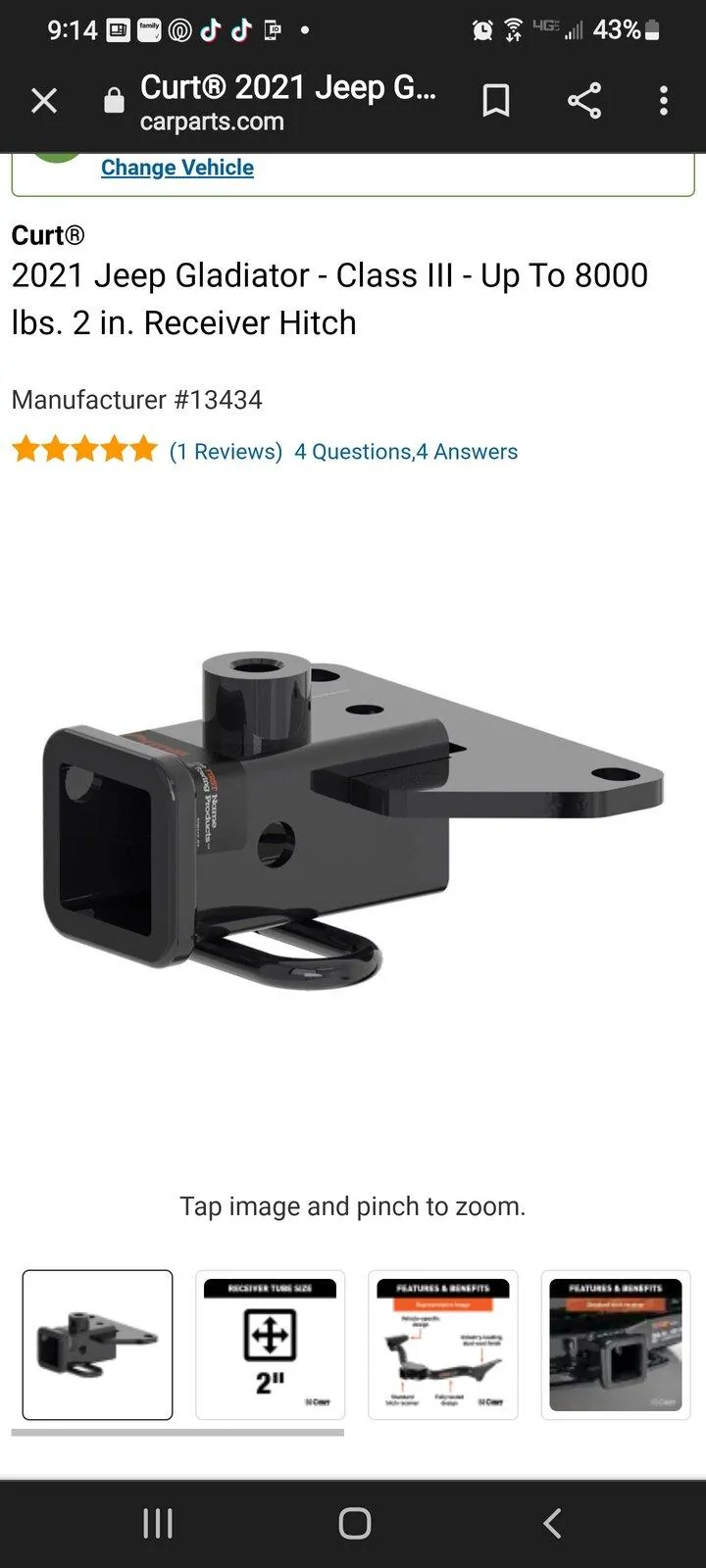

It's the factory style hitch so I wouldn't be modifying anything. It's three bolts. Two on the back side and one at the top where you would put a ball in the bumper. I Just don't want to look at the bolt and hole at the top right infront of the license plate.

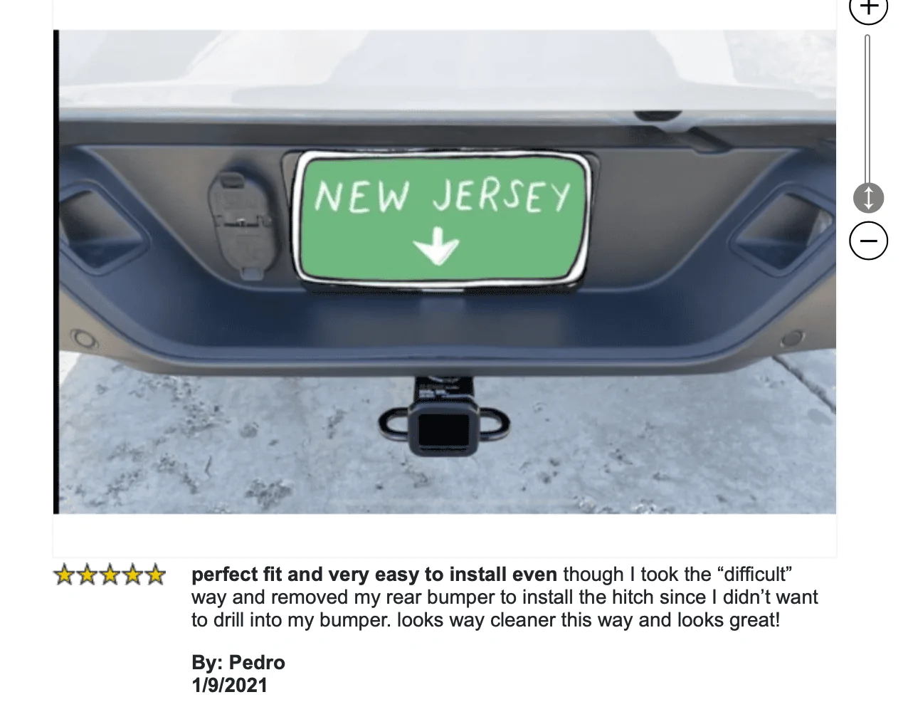

Based on what you have said, I'm guessing you have something like this Curt hitch.
if you follow this link you can see customer photos where they cut a hole in the bumper.
You can also see photos where they removed the bumper skin and did not cut a hole in the plastic.
There is a good bit of discussion of this in the comments.
The short answer is you can install it without cutting a hole in the plastic if you remove the bumper skin.

Yes I do have the curt hitch. I have seen folks with the non rubicon steel bumpers remove the bumper to install its the rubicon steel bumper that's making it more of a challenge. Thanks for the link. I'll do some digging there.
[/QUOTE]
Do you recall the shank length and diameter of the ball you're using? I'm gonna go the drill-into-plastic-bumper-to-install-ball route, like in those final few pics of yours ?
