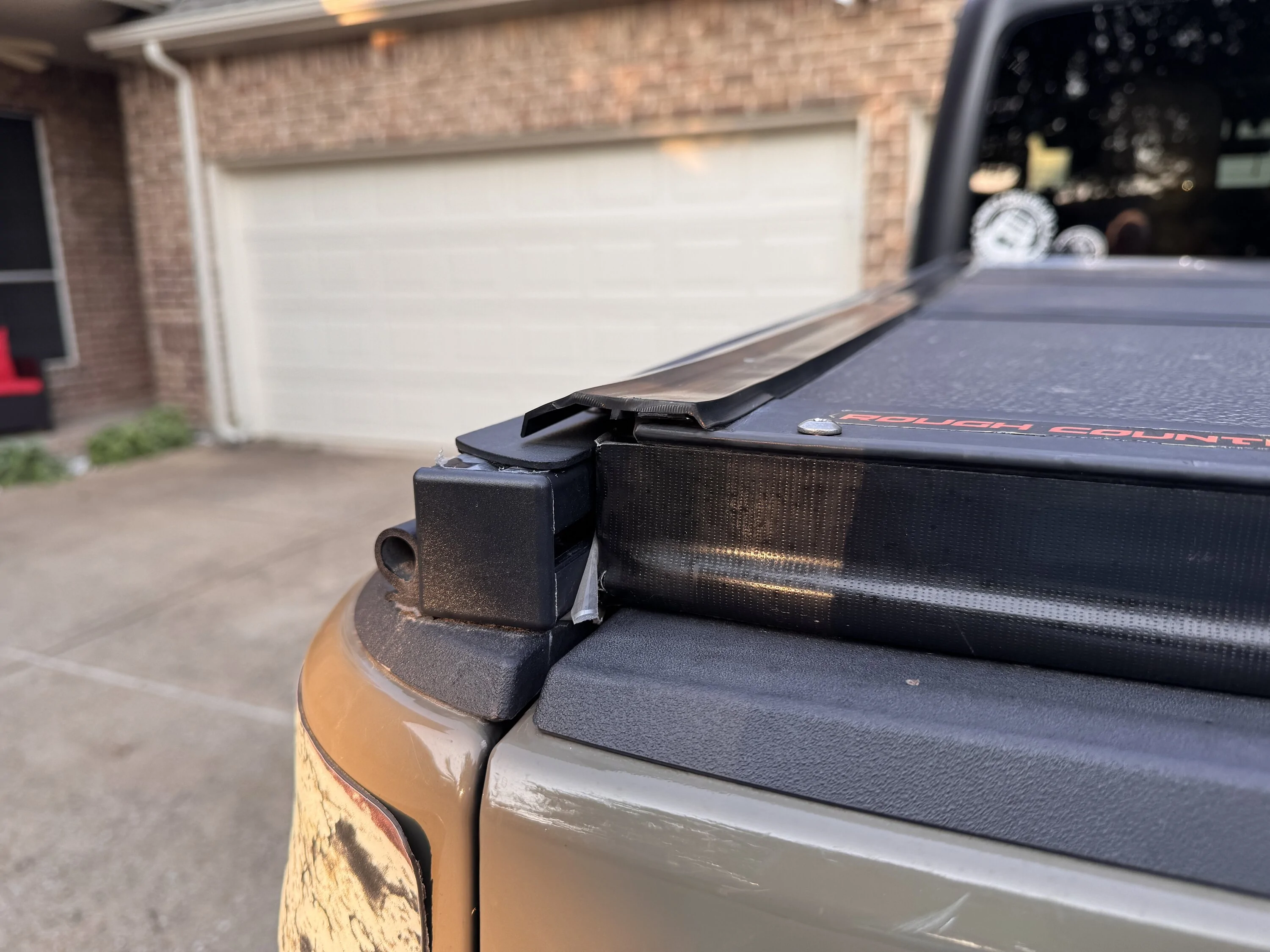

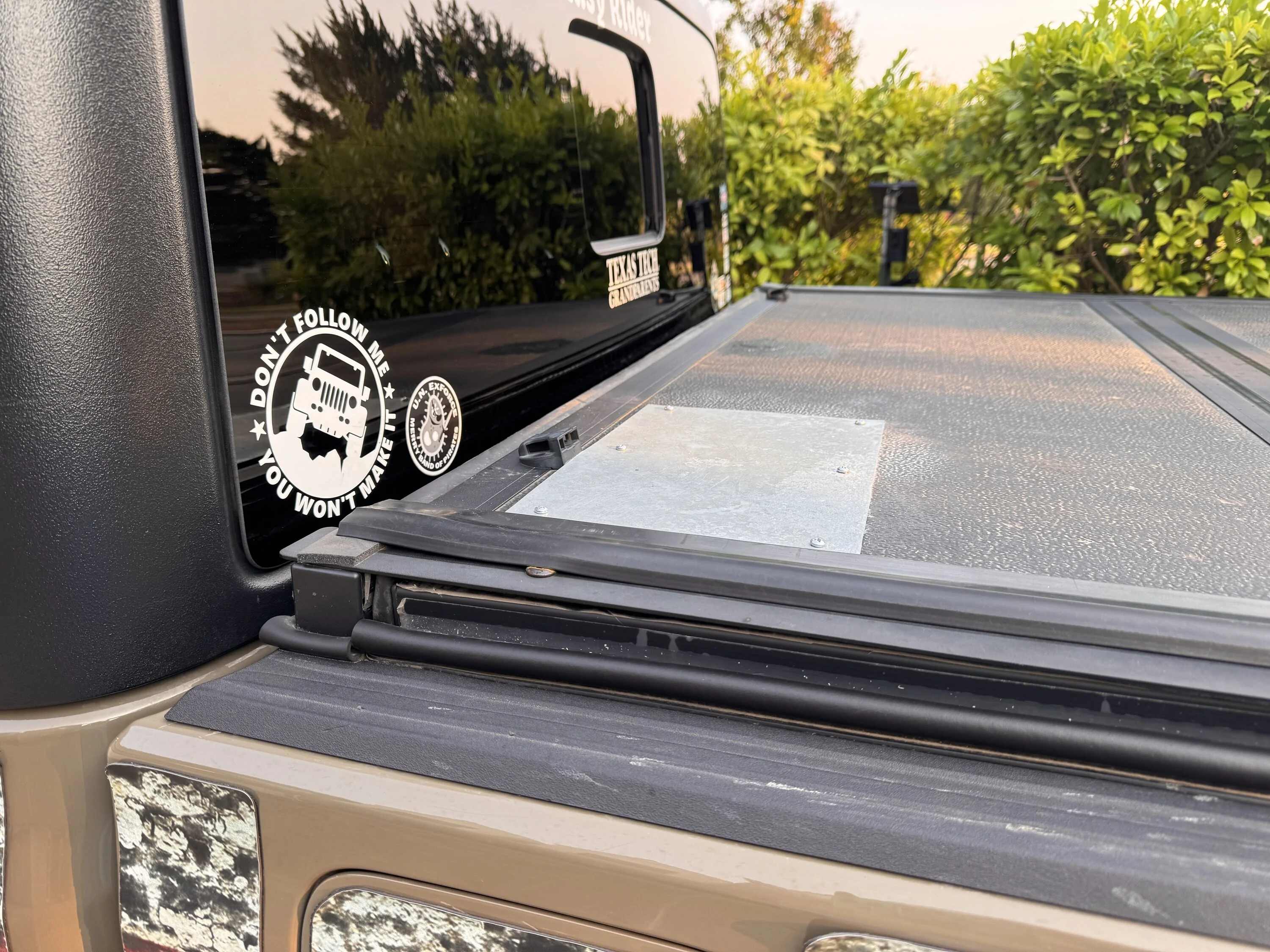

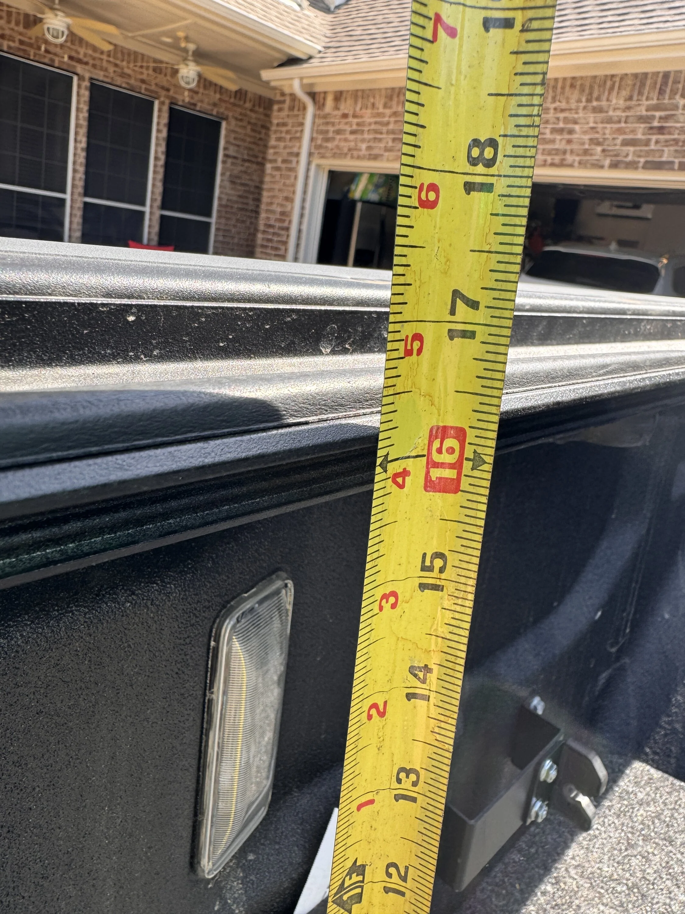

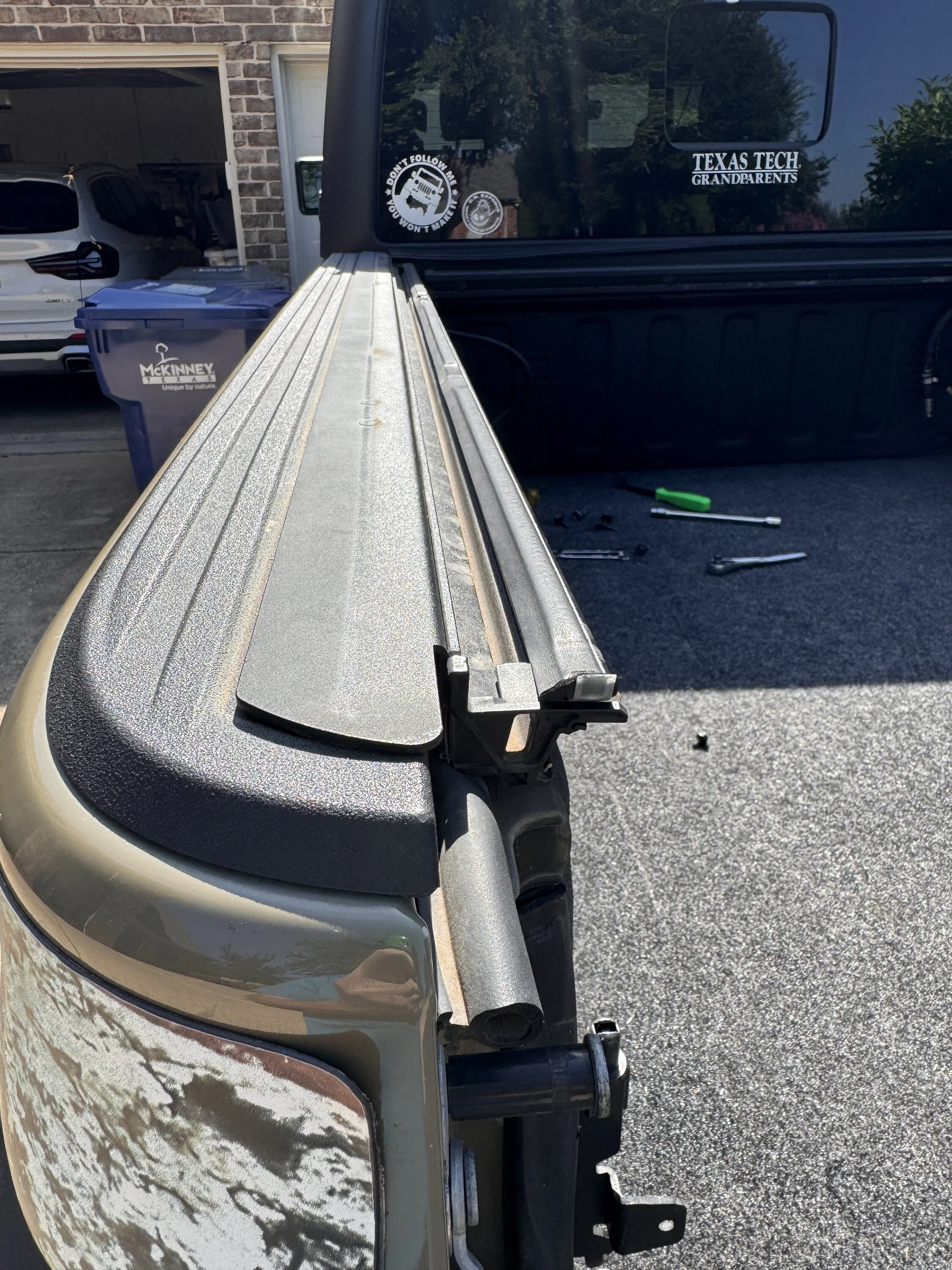

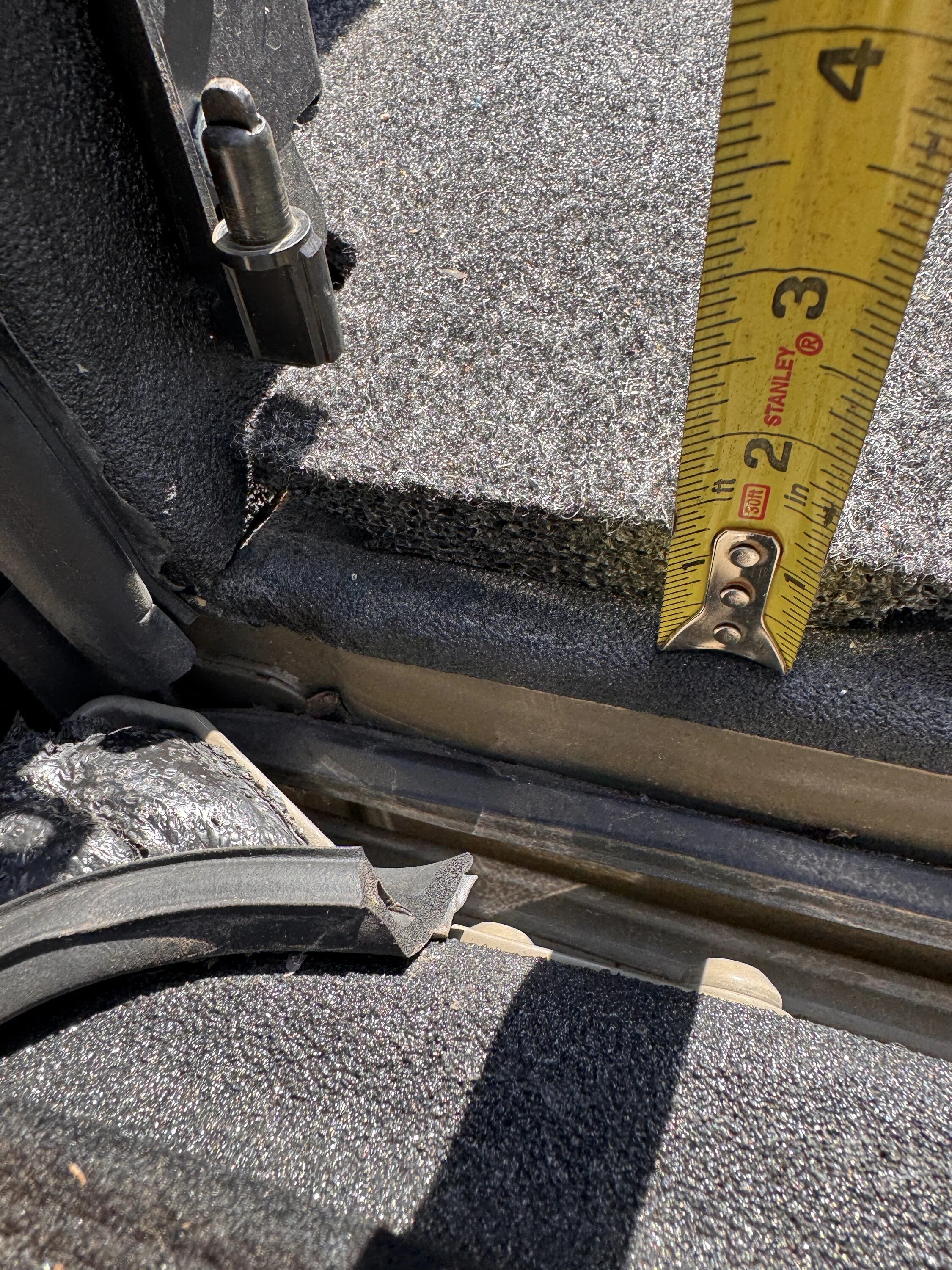

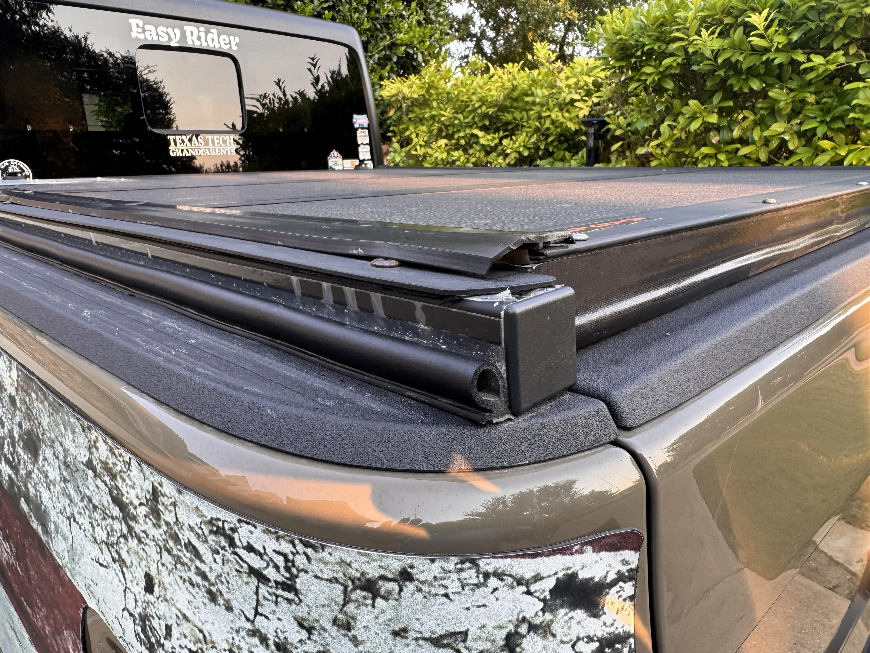

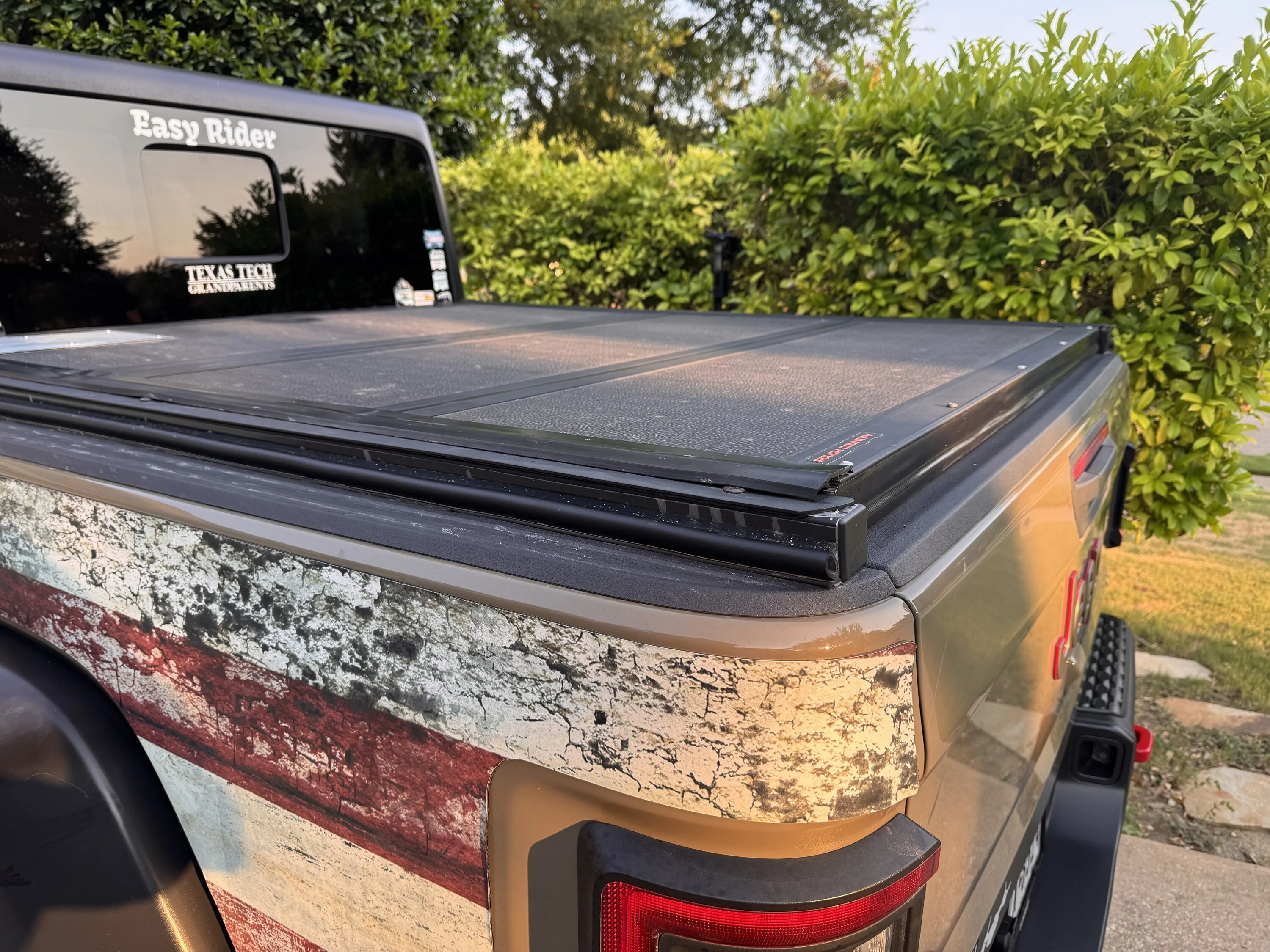

One complaint I've had with my hard tonneau cover is the limited height it provided when closed. Plus, I have a Bed Rug that further reduces height. I decided to try a solution using extruded aluminum to add two inches of extra height. I was able to buy some 2"x2" extrusion for the sides and the front section. I used a 1"x2" piece for the tailgate end. The two inch wide extrusion left some small gaps between the edge of the bed rail covers, so I have used some rubber tube moulding to seal the gaps. Next time, I would use some 3" wide extrusion for a better overlap. My result is an 18" height from the floor to the bottom for the cover. A trip to Durango last week worked great with no vibration rattles or dust intrusion issues. I still need to better dress up the seals and the tailgate end. But overall I find it a cost effective method to get a little more height that is rugged, secure and easy to use.

Is the extruded aluminum bolted to the tonneau to seal at the tailgate? I was wanting to get it to work with a retractable tonneau and so I had envisioned a flat plate "extension" to the tailgate to cover the gap there.

Yes, regarding the extrusion at the tailgate end. I drilled holes thru the tonneau cover end piece and screwed it to the extrusion using the supplied channel nuts. For now I covered the extrusion with some heavy gorilla duct tape. I’m going to make a better flap seal for it for a better look.

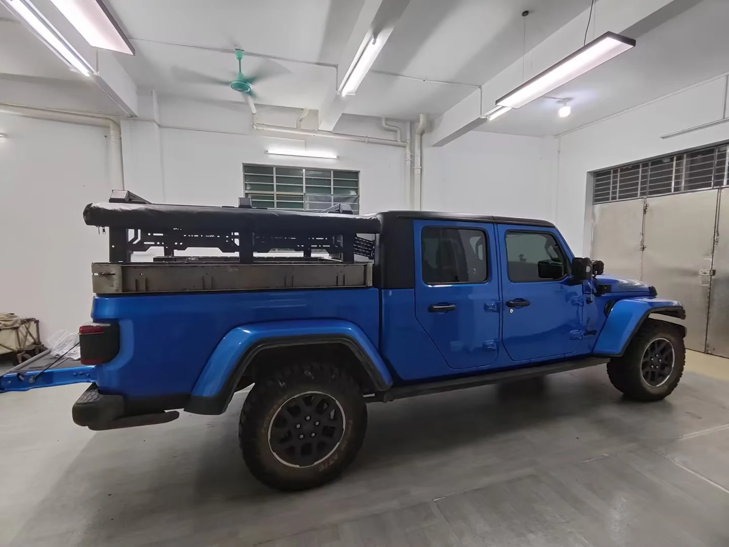

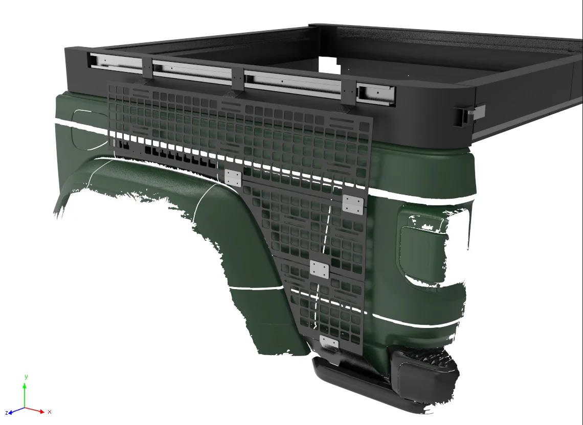

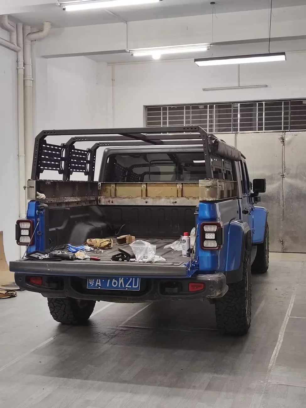

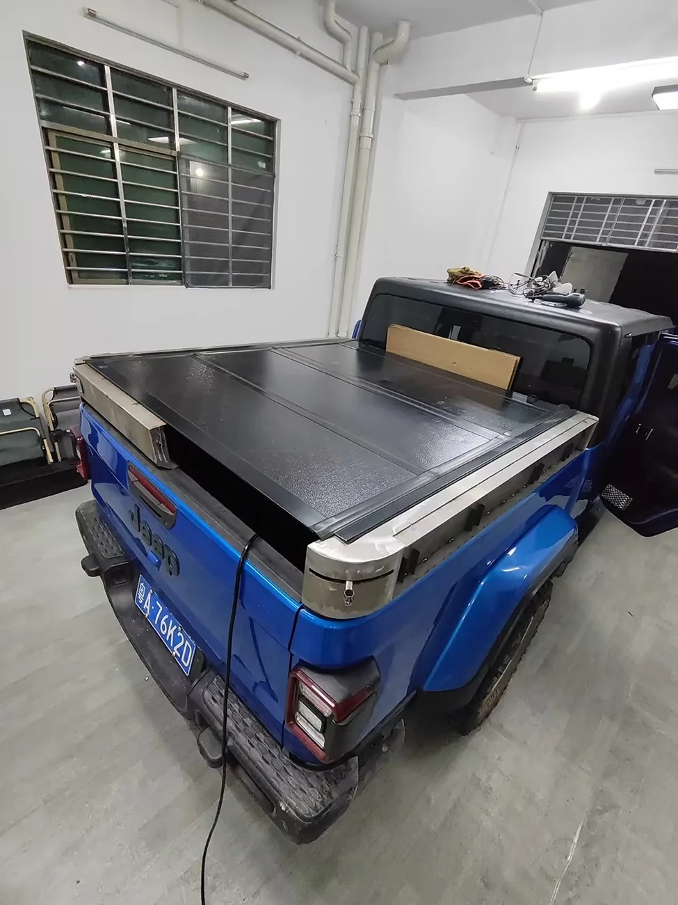

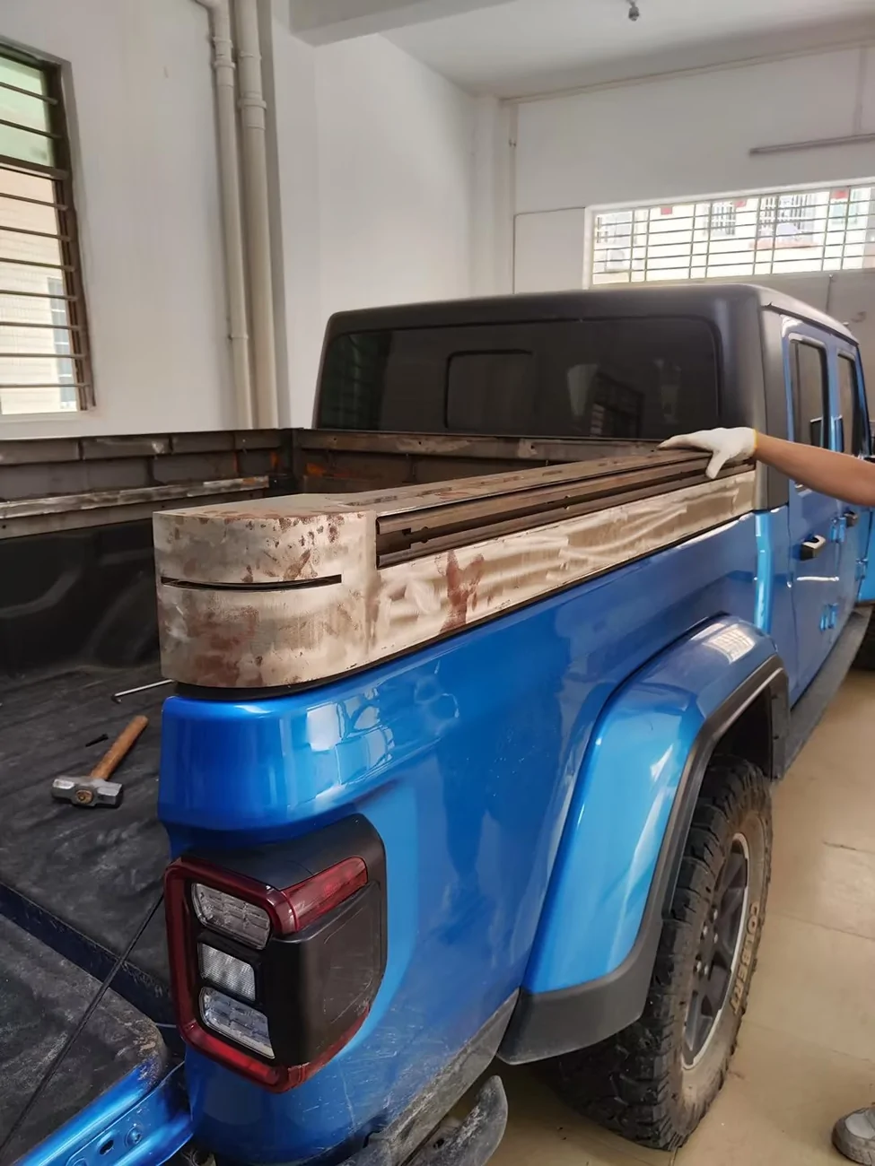

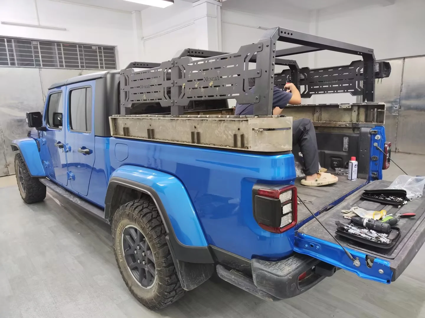

Aha, we didn't expect someone to come up with something similar!
The reason we held off on launching a new product last year was because we were constantly testing and refining the bed extension system. We still have some kinks to work out, so here are some of our ideas. Our idea is to extend the bed upwards 5-6 inches while retaining all the factory holes, so theoretically it's compatible with all bed covers and racks.

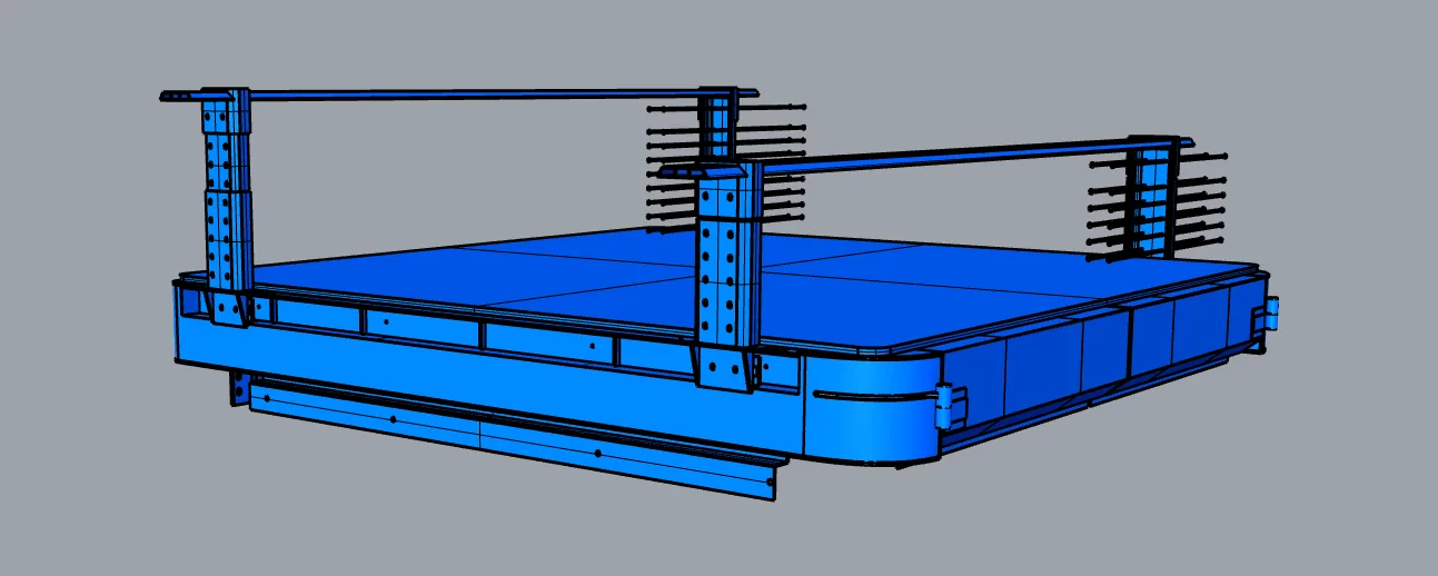

Our idea was to make it flush with the bottom edge of the rear glass window so as to minimize interference with the rear view. We were also wondering if it was necessary to add some rails on the outside to get additional fixing points, but the tailgate part was difficult to handle, so we put the project on hold for the time being. Seeing this thread reminded me of the days of testing until late at night last year...

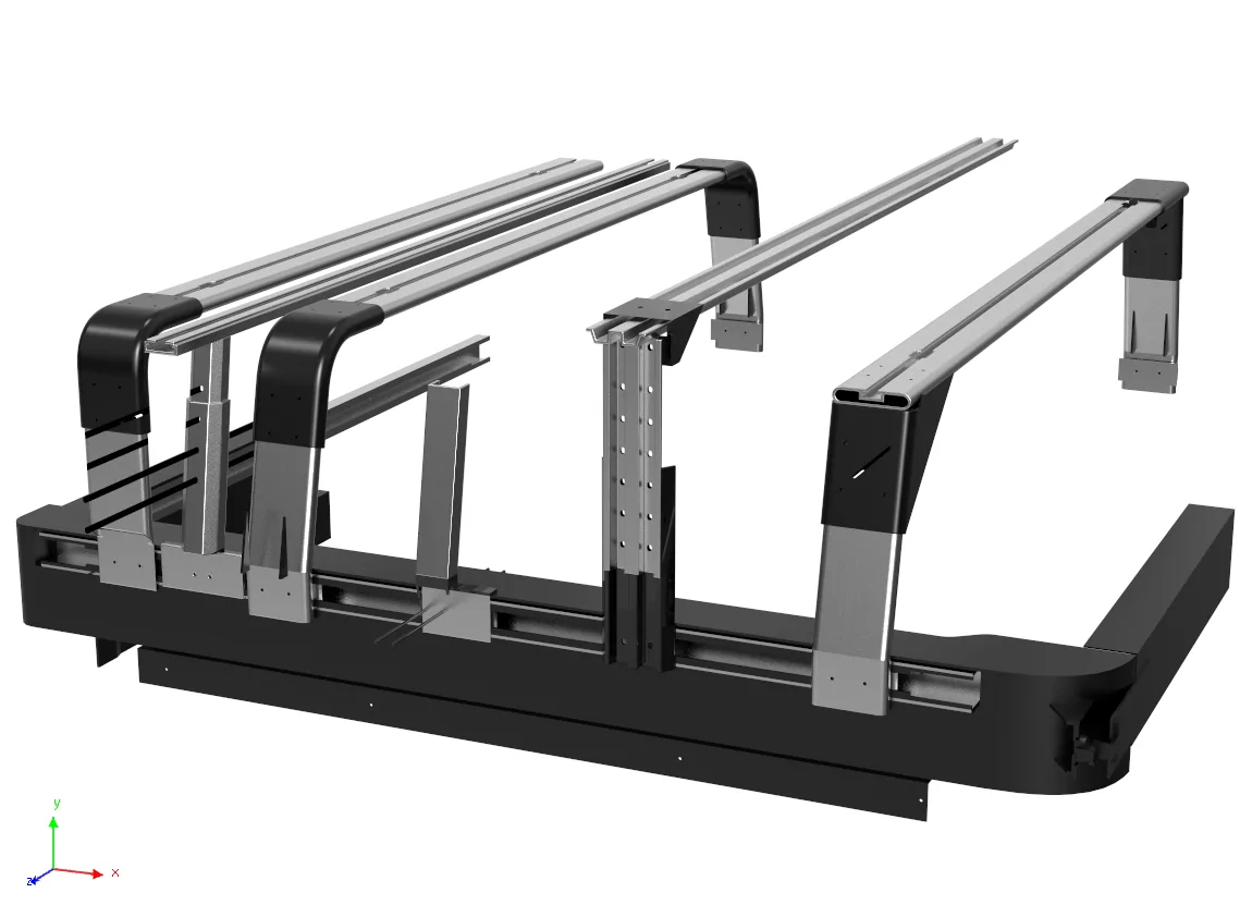

More renders if you're interested... We initially considered adding some molle, but later abandoned the idea because some people I asked said they didn't need it.
