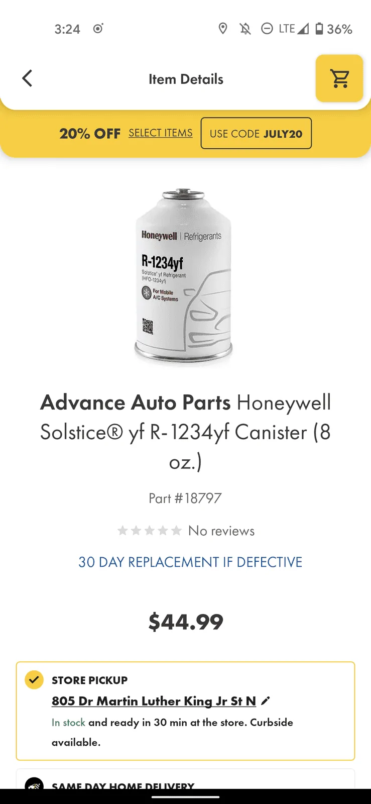

read up on r1234yf recharges, it's a very fussy and a particular refrigerant that has special pag oil application. Just repeating want I have hear my mechanic buddy talk about.

No issues with the freon at all, in fact I did the vacuum pump for a few hours, added the freon cans, everything settled in and done. I'm no ac expert but my dad had an ac business for 20 years..... Some rubbed off I guess....

glad it worked, just know the process for 134a is much different then 1234yf, and 1234yf doesn't carry the pag oil as good as 134a hence some special protocols to get the pag oil where it needs to be.

I didn't add oil separately whatever was in the 1234y cans is what it got. Should I consider adding oil. I don't want to saturate the refringent with oil and cut back on the efficiently. But I don't want to be replacing the compressor either.

I didn't add anything except what came out of the freon can...... Fwiw.
