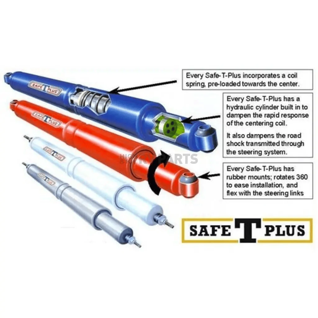

CrazyCooter is correct! The Exact Center unit uses two opposing gas cartridges. The Safe-T-plus uses two opposed springs. There is no option for directional preload on the safe-t-plus.
However, the safe-t-plus has an integrated hydraulic dampener so it could be use by itself, and it is less likely for a spring to fail vs a gas cartridge, so im kind of torn between the two. I wish i still had a 140lb safe-t-plus to compare, but the exact center works very well.
In my opinion the exact center unit should be used in combination with a hydraulic dampener because a charged gas cartridge has no ability to modulate rate of change.
For all we know, they could have just put a couple of screen door shocks from Home Depot inside of a shiny tube and added the "RoadMaster" tax on the item? :)
