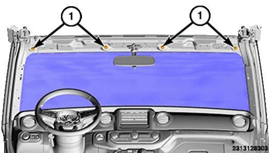

This is the entire installation procedure.
INSTALLATION
  1. A suitable body sealant should be applied when removing or moving the hinges.
  2. Align the hinges to the reference marks (2) made previously and tighten the hinge bolts (1) to the proper (Torque Specifications) .
  3. Install the cowl trim (Refer to 23 - Body/Exterior/COVER, Cowl Panel/Removal and Installation) .
    Jeep Gladiator Adaptive Cruise Control alignment ault&X-Auth-Token=d6687e1bc7044ea1a815e9ee6d3c96d3
  4. Seat the windshield frame on the header fully and install the bolts (1).
  5. Tighten the bolts (1) to the proper (Torque Specifications) .
  6. Install the wiper arms (Refer to 08 - Electrical/8R - Wipers/Washers/ARM, Wiper/Removal and Installation) .
Notice there is no mention of calibrating the Central Vision Processing Module.
INSTALLATION
INSTALLATION
I also noticed the image is from a non-ACC vehicle.
250
40,624
54,315
There's only one service procedure for windshield replacement on Gladiators regardless of options.
I repeat - that makes sense since the Gladiator has the ACC system mounted to the roll cage - NOT the roof or glass or windshield frame. What could possibly be impacted by broken glass, or replacing same?
If it was the act of replacing, then you'd have to align that thing every time you folded the windshield down and put it back up again. You don't even replace the glass with the windshield frame in place according to the directions (and I believe that's how it was explained to me as well)
