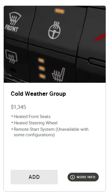

I must be remembering wrong - I thought remote start was part of the cold weather package, and to get remote start, you ordered the cold weather package.
Is that not correct? Or is that just an orange thing?

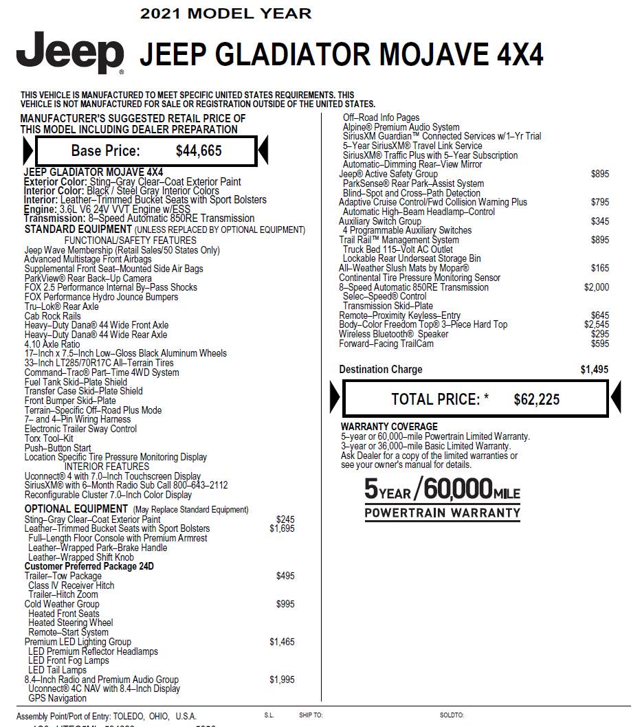

I thought it was standard on the Mojave? No, I do not have heated steering wheel or heated seats. I do have the automatic if that makes a difference?
Automatic is required for any of the Remote Start options. Remote Start with the FOB is an add-on that is also included in some of the option packages. Remote Start with the App is an add-on that requires a cellular equipped head unit and it also includes the Remote Start with the FOB option. There is also a package that can be dealer installed that adds Remote Start with a FOB for trucks that were not ordered with it.

Doesn't look like remote start is standard - go build a Mojave.
Now unless they somehow include remote start without the cold weather package on Mojave, last I knew the only way to get it from the factor was with the CWP.
I’ll have to dig out my window sticker and look tomorrow

I would be really curious - maybe another Mojave owner ( @Lunentucker for example) will speak up about whether or not this, that or the other thing is stock/standard on Mojave.
