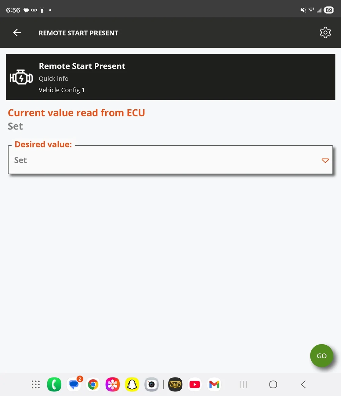

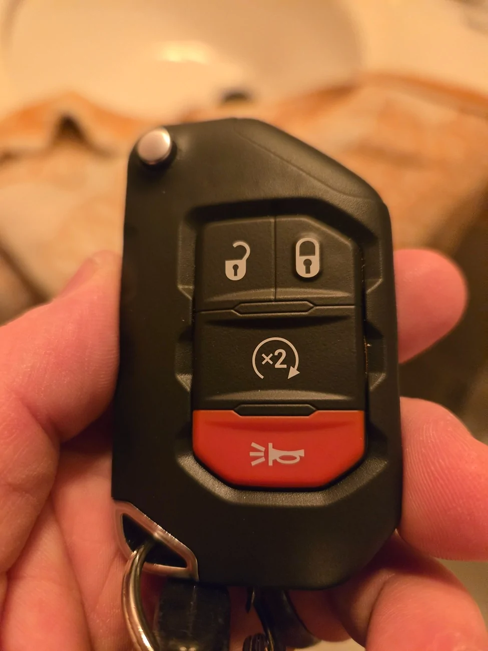

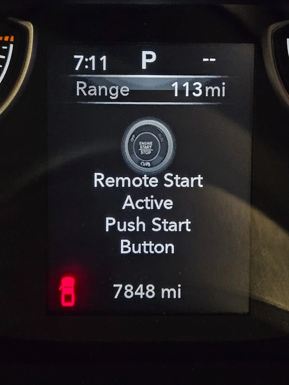

Not sure if webduelist is still around but this guy is 100% spot on with everything. I installed proximity door handles, auto matic headlights , and now factory remote start. People in the fourms were commenting that certain things couldn't be done. Wedduelist is a genius when it comes to this. Got a factory jeep key made at the dealer . The parts guy at jeep told me this wouldn't work . Webduelist stated , " i promise you this works" . Turned on jscan , activated remote start , saved the setting , drove around my subdivision, went over 40 mph , gave the jeep like 15 mins of run time, went back home , shut it off , press the auto start button twice, and BAM . It started . So easy. Can't guarantee that it's this simple with all Jeeps but presumably with 2024s and 2025s.
What was the part number for the key? Was it 68416784AD ? Thanks!

Reading this post makes me laugh, this was all figured out long ago. James, James07 or something like that is actually the Guru when it comes to the Jeep electronics. He walked me through this a few years back. The reason it “appears” to work after you drive the car is because the modules have time to initiate again (I actually forget the exact wording James used), but all you have to do after you turn on the remote start in JScan is restart all the moduals. I did it and it worked fine. People are to impatient…
