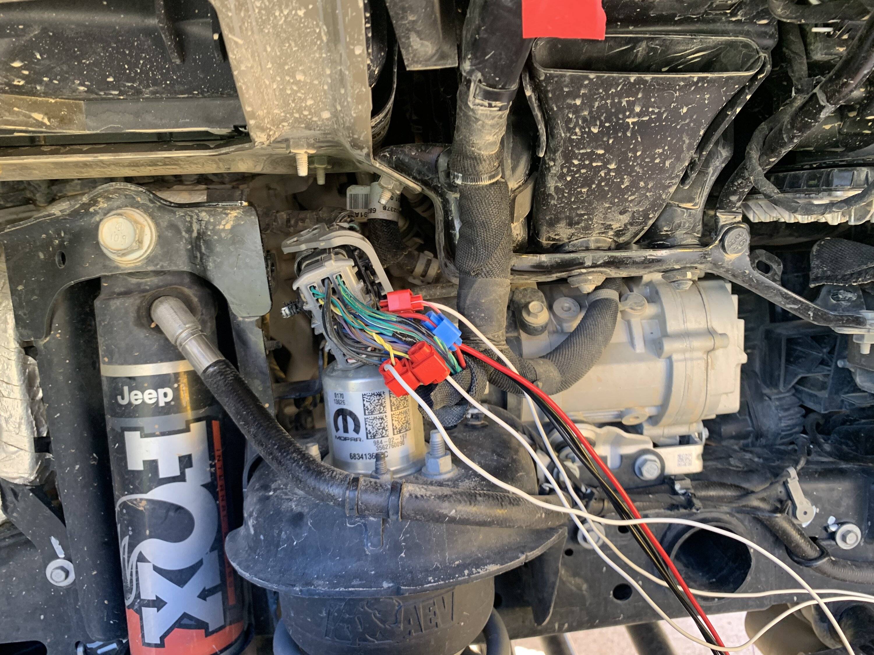

Coming from Rubi i missed rubi smatbar swaybar disco more than the front lockers. And I did not find anyone doing it on JT/JL forum. And its not always fun to manually disconnect & reconnect.
So here we go, it can be done & this is how we can add Rubicon Smartbar Swaybar to Mojave with OE controls.
Parts:

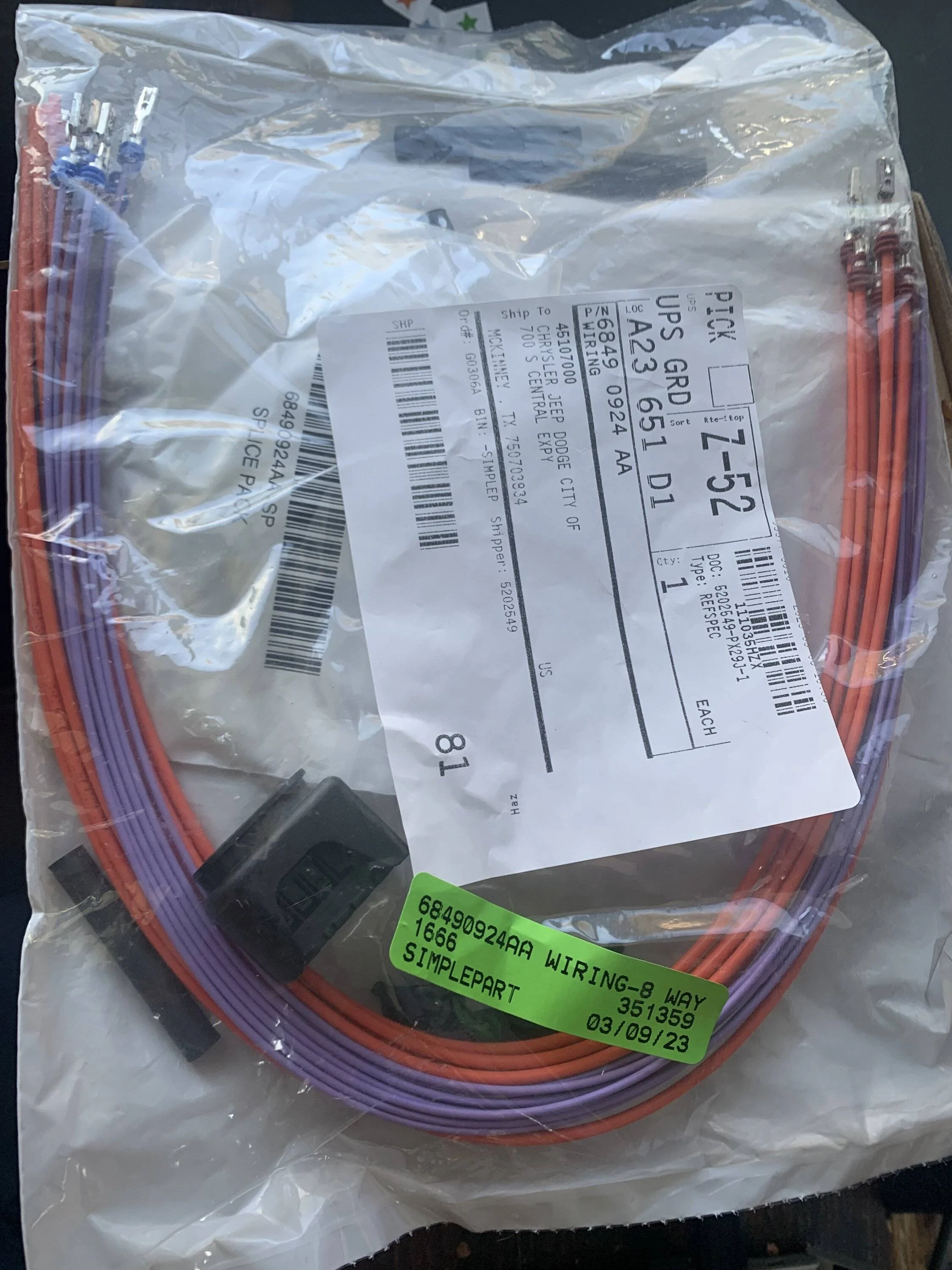

JTR/JLR smartbar swaybar
Off-road switch with swaybar button 68359089AA
mopar 8-way connector kit 68490924AA
Programmer of choice JScan/Taser/AlfaOBD etc.
Steps:

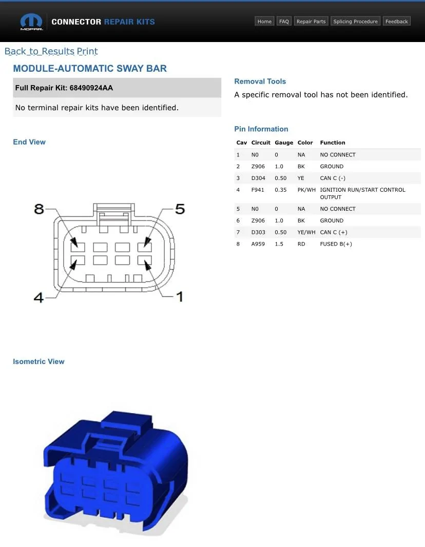

Assemble the mopar 8-way connector
http://connectors.dcctools.com/details.htm?id=283845
Jeep Gladiator Adding Rubicon Smartbar Swaybar to Mojave with OE controls 38508707-06E0-42A5-B5B8-FEADD95BD5BF

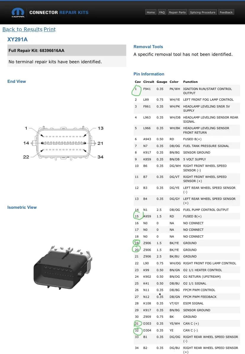

Tap corresponding ends to XY291A male connector.
http://connectors.dcctools.com/details.htm?id=284329
Jeep Gladiator Adding Rubicon Smartbar Swaybar to Mojave with OE controls AC2E5321-1125-46A9-A9C7-5EDF329A2B90

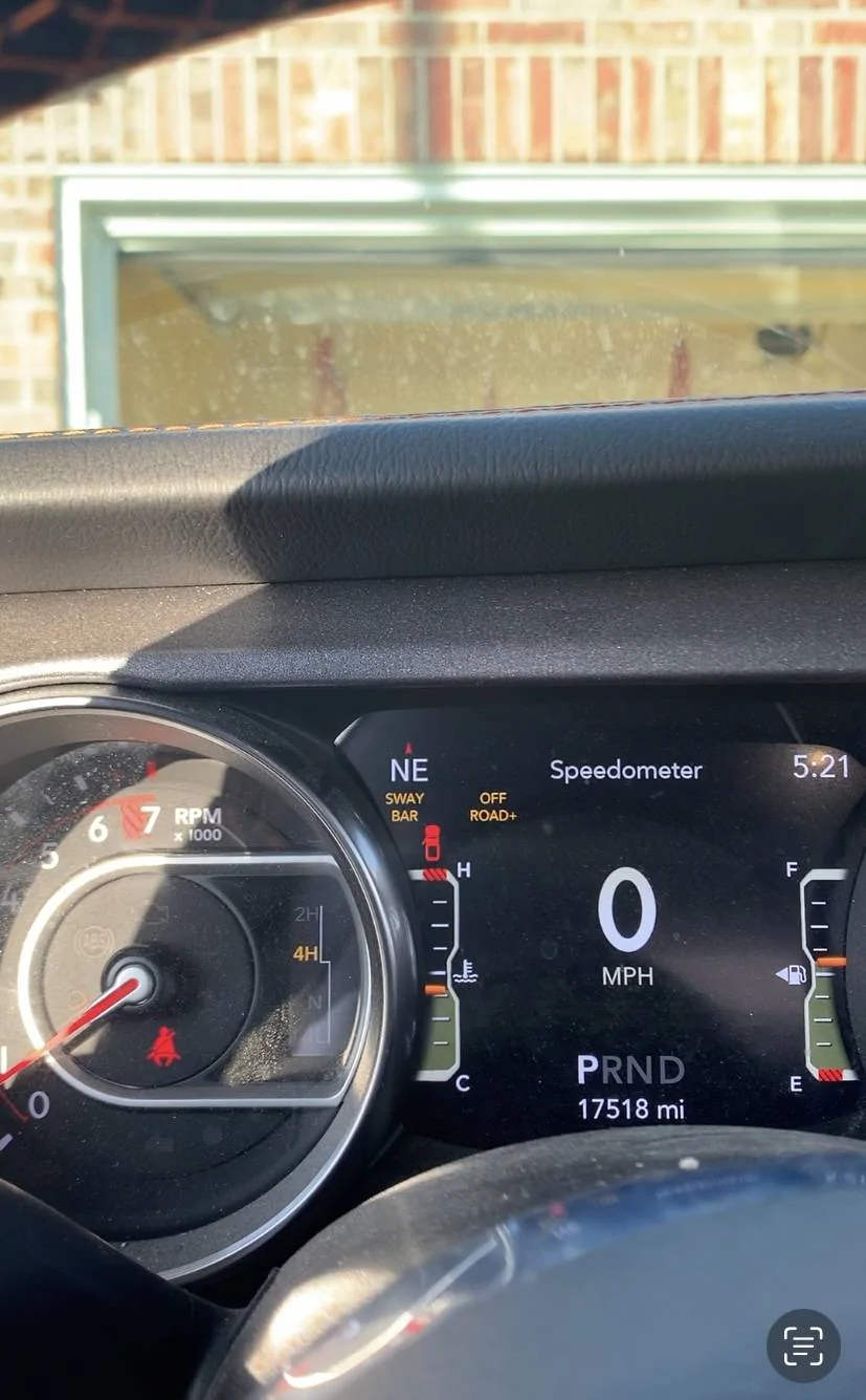

Enable sway bar function from programmer
& off you go off-roading.

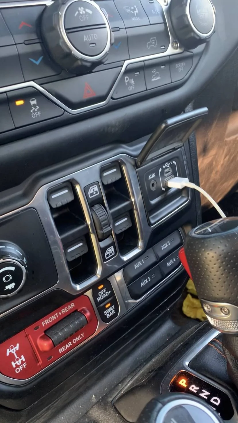

Jeep Gladiator Adding Rubicon Smartbar Swaybar to Mojave with OE controls 085F7BAF-7014-49DF-9DF0-8699EA48CD61
Jeep Gladiator Adding Rubicon Smartbar Swaybar to Mojave with OE controls E2FA9803-4C75-41C2-9101-448441825529
Jeep Gladiator Adding Rubicon Smartbar Swaybar to Mojave with OE controls DCD763CC-B0A7-453D-A71D-BC454B0BA253
Jeep Gladiator Adding Rubicon Smartbar Swaybar to Mojave with OE controls 7A690C5D-D095-41D7-B784-BA2BCAC8A3A1
Jeep Gladiator Adding Rubicon Smartbar Swaybar to Mojave with OE controls 2402E81B-DC67-4FF4-898C-F13800E9613F
Jeep Gladiator Adding Rubicon Smartbar Swaybar to Mojave with OE controls 91632354-C5F1-429F-B32B-FDADB8987102
Jeep Gladiator Adding Rubicon Smartbar Swaybar to Mojave with OE controls 58A61E75-477E-4325-8CFB-B46DC4095AB4

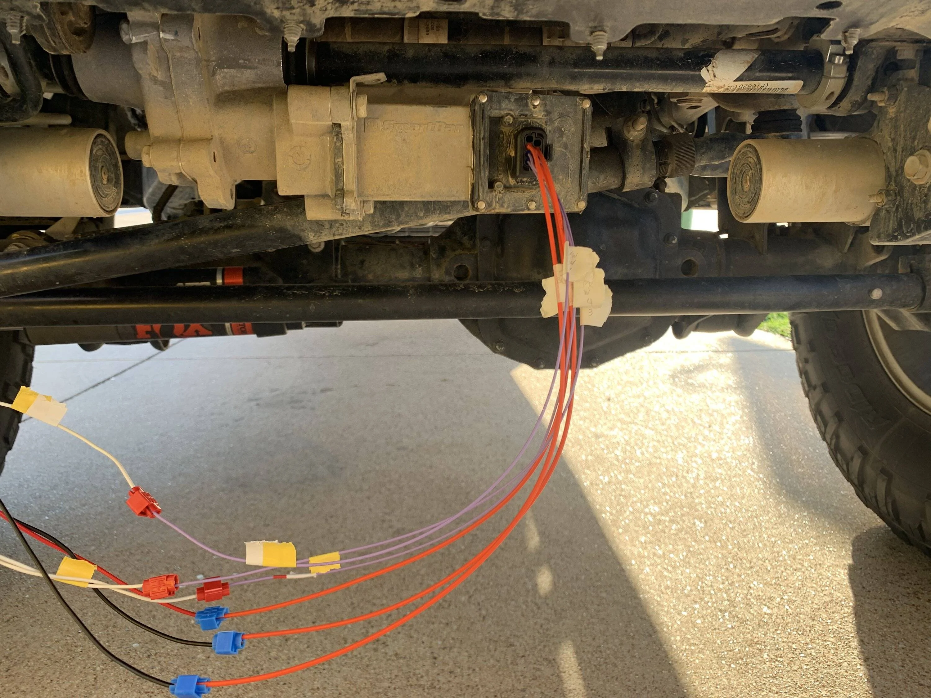

I finished up this project this weekend and it looks like it was really as easy as splicing in a few wires. The hardest part was making sure I ordered the correct Rubicon button module.
Question: did you ever run down the connections to add the Rubicon locker to the mix? I have also sourced a rubicon front locker, axles, and power cable. I just need to figure out where they tap into the system at and I'm ready to try it.
Any hints?

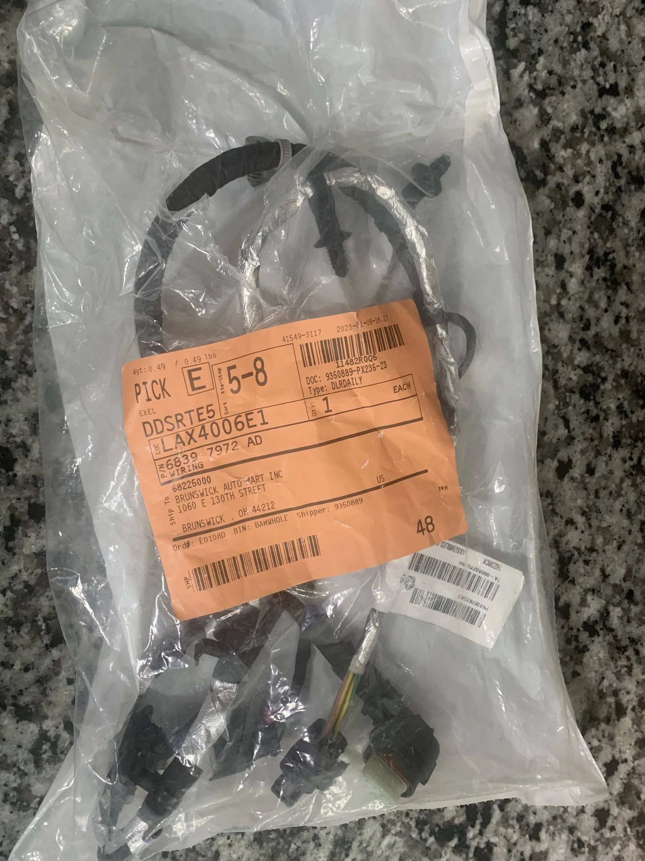

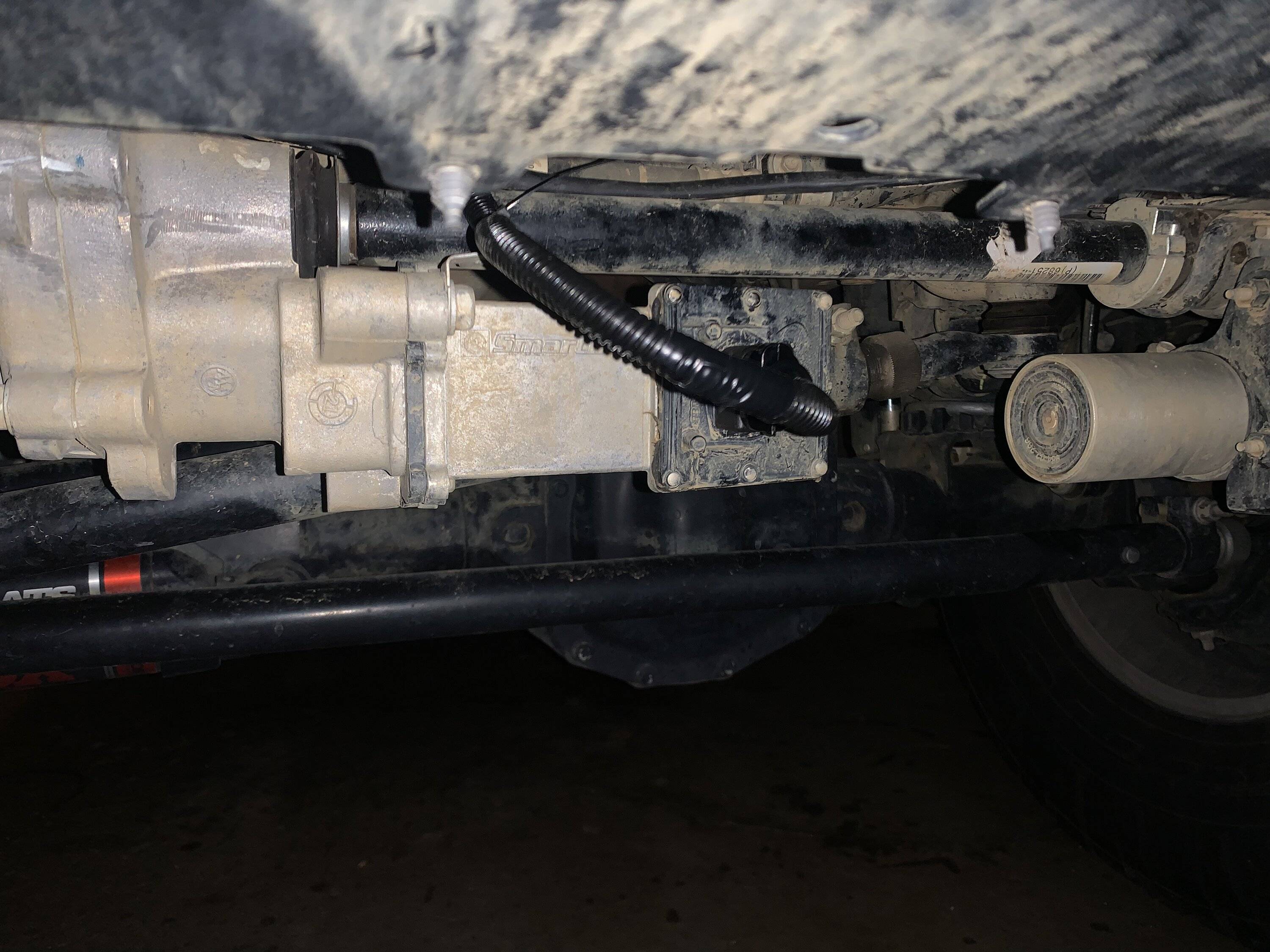

@Astephan1284
here is the JTR wiring harness for front locker to work with off road switch it connects under the driver side brake booster behind the fender liners and routes to axle pumpkin. (one mojave has is spedo sensor wire only this will replace that.
this should be plug n play if you have a JTR front axle.
I don’t have one so i haven’t added to my truck yet.
