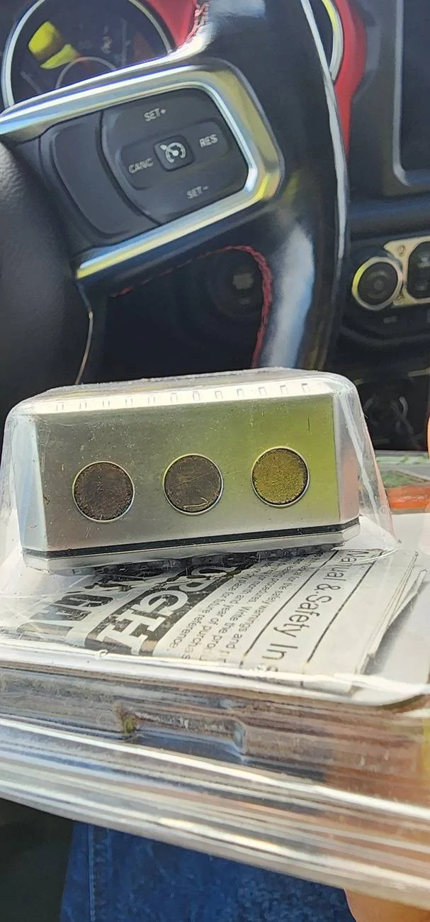

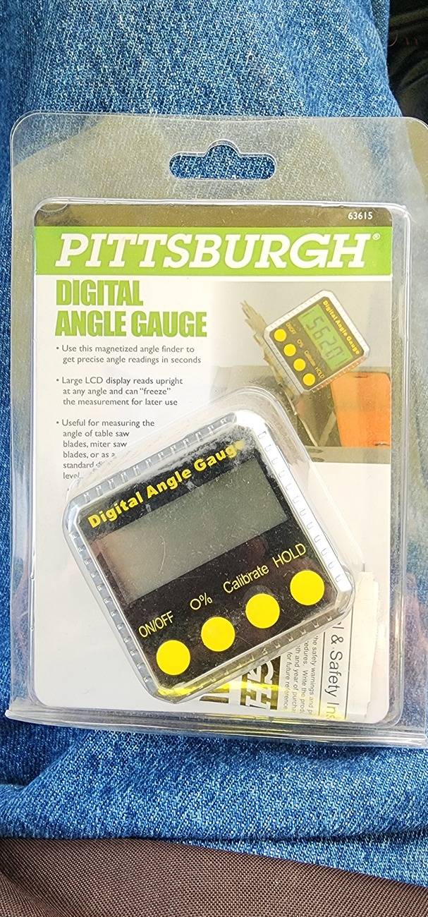

Go to Harbor Freight buy what ypu see in the picture. Zerobit on a completely level surface . ( check this by using a carpenters level) then place the magnetic side on the axle on top of the pinion this will give you your caster angle .
Usually between 5-6° is a sweet spot . I have seen some guys with a little more but they was lifted 6"
