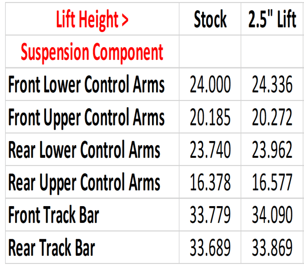

Essentially I'll be installing the Clayton ride right 2.5", adding the front lowers and all 4 bump stops to the kit.
My question is are adjustable rear control arms really necessary at this small of a lift?
Know it's not the same but I have lifted the Jeep up to where it would approximately sit once lifted to measure and visually inspect pinions angles, etc. and everything seems within spec.
Has anyone measured the factory control arms and compared them to the length of their adjustibles?

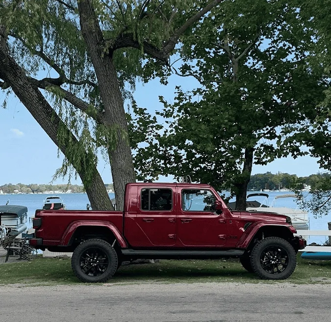

I've had a 2.5" Clayton Ride Right for about 30k miles now. I have stock rear arms and no issues. No driveline vibes and the rear tires are located in the wheel wells pretty close to center at ride height.
That's great to hear! Your JT looks awesome! Perfect stance in my opinion.
Are you running 35's? That's next on my never ending list!

Thanks!
I am running 35s.
