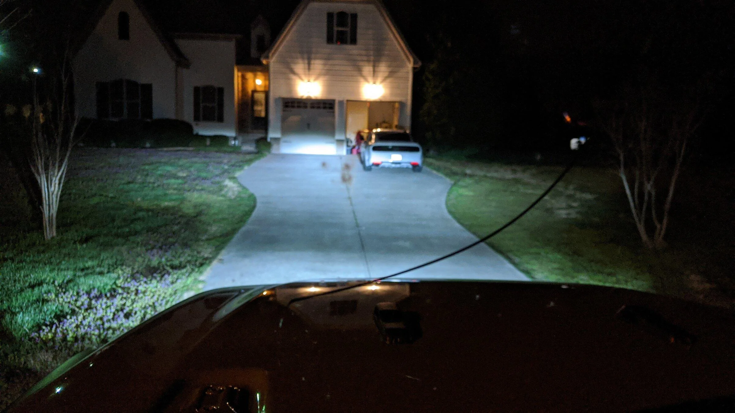

I adjusted mine by measuring to center of headlight and backing up 25ft. Just saying not to say anyone's wrong for how they do it to get to specs,that's how I did because I was lifted 2.5 inches at the time I adjusted them. This pictures shows me at about 75ft back and my headlight cutoff is at 40 inches off the ground for reference
Jeep Gladiator Adjusting Headlights - How To MVIMG_20200313_212614
