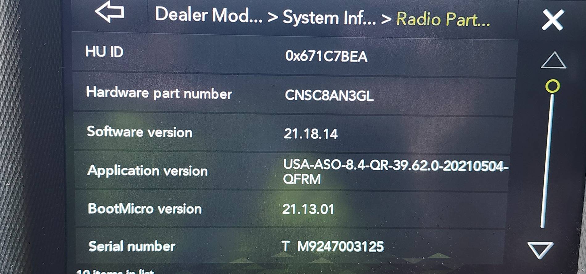

Mine has NEVER EVER received a single OTA update EVER.. it is the original version for 2021. Works just fine no problems.
I have never received any update for my 2023 either but my unit did not have the latest software. The Uconnect website said my VIN had the latest when it didn't.
You have version 39.62 which is not the latest.
What is the latest ?
40.12 I believe. The update presented on this guide has more updated version than what is in your truck.

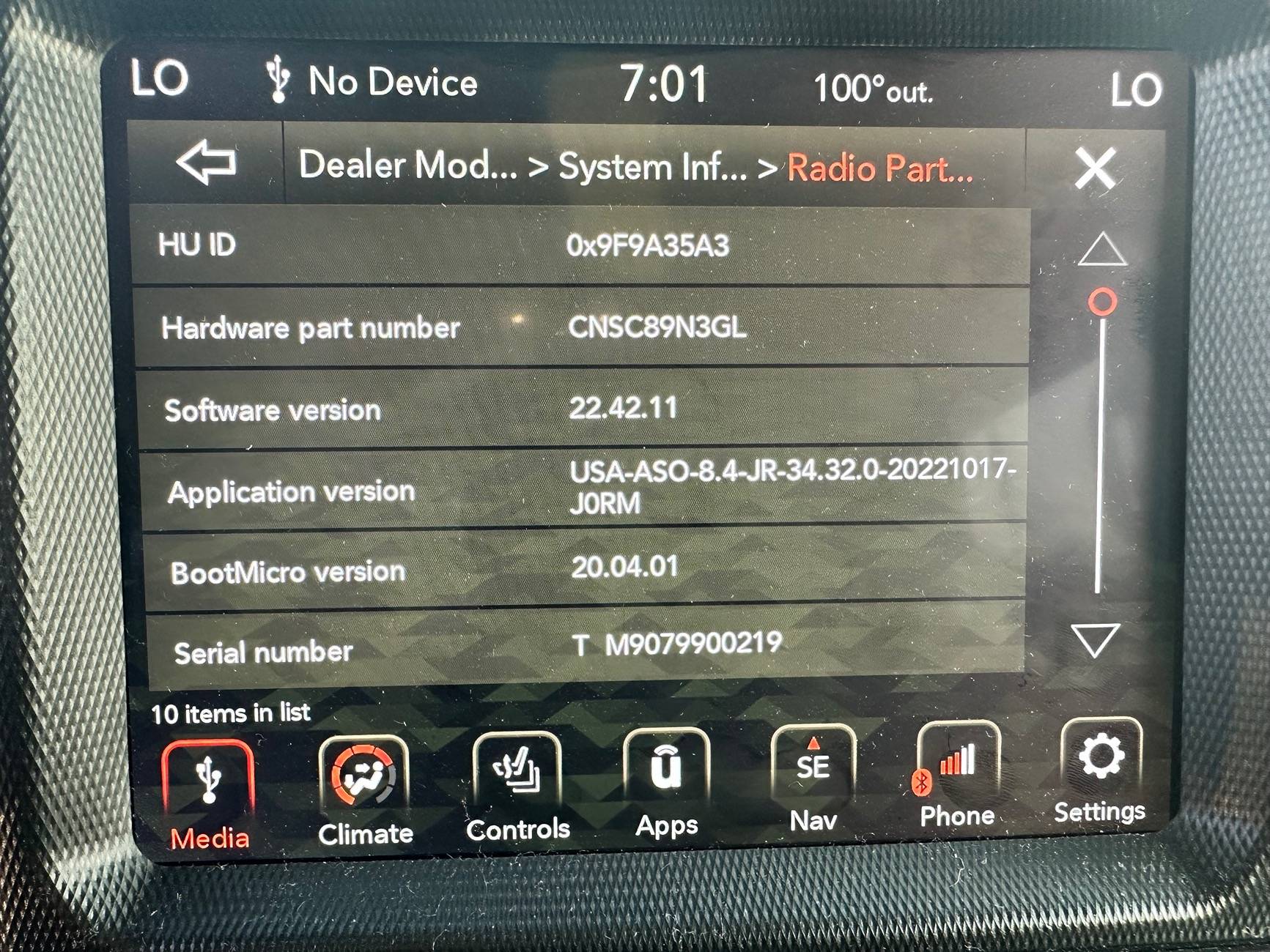

In the midst of debugging my TrailCam installation for my 2023 JTRD, I stumbled upon updating UConnect Stereo via USB A connection available to the right side of the window controls on JL/JT and other Jeep platforms. However, I found no sepcific guide available for JTs. So here I am, writing it.
From what I read, the Over The Air (OTA) update is no longer pushed out by Uconnect/Chrysler for the newer Jeeps and that the updates are only provided by the dealers. It sorta makes sense as the update is over 1GB and that is a lot of data to push into individual vehicles.
If you have factory warranty, the dealer should provide it for free, otherwise the update is provided for a fee.
This guide is for those like to get stuff done on their own. I am sharing what I did and hope you find it useful.

How to figure out what version you have:
Hold the short cuts on the bottom left and right. As seen below until screen changes and you will get into "Dealer Mode".
In this mode, you want to get into the Radio Information.
You will see a very similar screen below.
In the "Application Version", you see USA-.......39.7.0-......
That "39.7" is the Application version.
Mine is relatively new, but not the latest.

You can reaccess the dealer mode and check "Radio" information and you shall see the following screen. You can see the Application Version is now 40.1.

I started my vehicle and kept it running as I wanted to have stable battery voltage during the entire update process.
And you will get a prompt asking if you want to upgrade. Proceed through that prompt and you will get the following timer. Let the timer expire. You can see where I plugged in the USB drive.
Once timer runs out, you will get the following screen.
While the count down stated 30 plus minutes, mine took about 25min.
And the unit will reset on its own and the first screen will tell you that the update present in the USB drive is the same as the current one. This means you successfully upgraded your HU.
*IT IS POSSIBLE THAT YOU MAY NOT SEE ALL YOUR APPS RIGHT WAY. I READ PEOPLE REPORTING THEIR APPS BACK ALMOST 24 HOURS LATER and also having to reset all their settings again. Having said that, all the apps were present immediately for me.
Impression:
I started researching into this upgrade because my parking guideline and TrailCam were functioning intermittently. The issue turned out to be because I did not seat CVPM CAN IHS connector all the way down.
Nonetheless, the upgrade made the entire interface feel more fluent and faster. Navigation loads within a few of seconds and offroad page loads faster too. Definitely an upgrade.
GOOD LUCK!
*YOU DO THIS UPGRADE AT YOUR OWN RISK. I AM MERELY SHARING MY EXPERIENCE. YOUR MILEAGE MAY VARY.
Good luck!

It worked well for me. I did notice that there was an option to do a backup in the dealer menu. I opted not to do the backup and jumped in with USB, no issues what so ever.
DailyDrivenTJ
DailyDrivenTJ
Michael
Nov 19, 2023
319
226
PNW
2023 JTRD, 1999 TJ-6 HEMI, 1998TJ, 2000 XJ 4.6L
Glad that it worked out for you. What year and version did you upgrade from?
